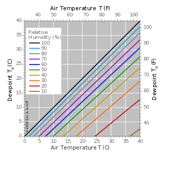

Dew Point vs Relative Humidity
Relative humidity (RH) measures the amount of moisture in the air versus the maximum it can hold. At 50% RH, it has only half the water it can hold. Cold air holds less than warm so, for the same moisture content, RH goes up as the temperature drops. If it cools enough, the humidity rises to 100% and water condenses—dew forms. The temperature now equals the dew point (DP). Dew point is expressed as degrees (the temperature where dew forms), but it is a function of the actual amount of moisture in the air, which is known as absolute humidity.
How do we calculate dew point from RH—or vice versa? The equations are complex, and include temperature. Most are approximations, not exact. One commonly used is the Magnus Formula, which you can find in a web search. Above 50% RH, the following is said to be accurate to about 1%:
Dew Point (deg. C) = Temperature (deg. C) – (100 - RH)/5
+3% RH uncertainty equals about +0.6 ℃ (1.1 ℉) dew point. For on-line conversion calculators, search for “calculate dew point”. A handy conversion chart is shown in Figure 1.
humidity conversion chart
Figure 1. Humidity conversion chart. Image used courtesy of Easchiff

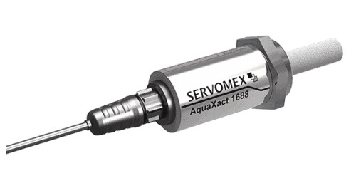

Capacitive Aluminum Oxide Sensors (Dew Point/Absolute Humidity)
These also are capacitive, but are entirely different from MEMS IC sensors. They are rugged, industrial probes which measure trace amounts of moisture. They measure absolute humidity (which can be expressed as dew point), not RH. Figure 2 shows a typical probe.
The dielectric is a thin, porous layer of nonconductive aluminum oxide, often etched or deposited on a metal aluminum rod which becomes the first electrode. The second, permeable electrode layer is deposited on top. In use, the sensor usually is shielded by a protective enclosure. Like polymer, it absorbs moisture. Unlike polymer, the change is proportional to absolute humidity and is sensitive to very small amounts of moisture. The measurement range can go as low as -100℃ dew point.
These are sold as complete industrial systems, including instrumentation, with dew point accuracies around +2 ℃. An important application is monitoring for trace moisture in gasses, including natural gas and propane pipelines.

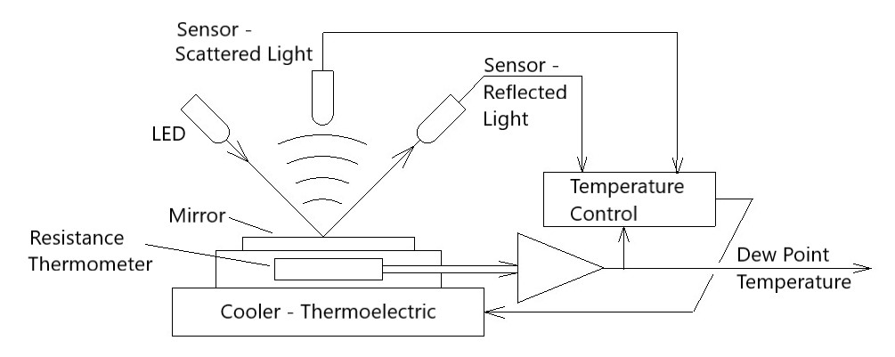

Chilled Mirror Dew Point Sensors
The concept is simple—cool a mirror while measuring its temperature. When dew forms, the temperature equals the dew point. Figure 3 diagrams the system.
chilled mirror for humidity measurement
Figure 3. Chilled mirror. The reflected light is interrupted when dew condenses on the mirror.
Light reflected from an LED detects dew formation. When dew forms, the reflected light drops. Some systems include a scattered light sensor whose output increases with dew. Control electronics hold the temperature at the temperature where dew forms.
This is a basic, fundamental measurement and can be very accurate, even well below freezing. It’s used in laboratories and as a calibration reference. It is expensive, though, and requires periodic cleaning and maintenance. For this reason, it’s not suited for many industrial uses.

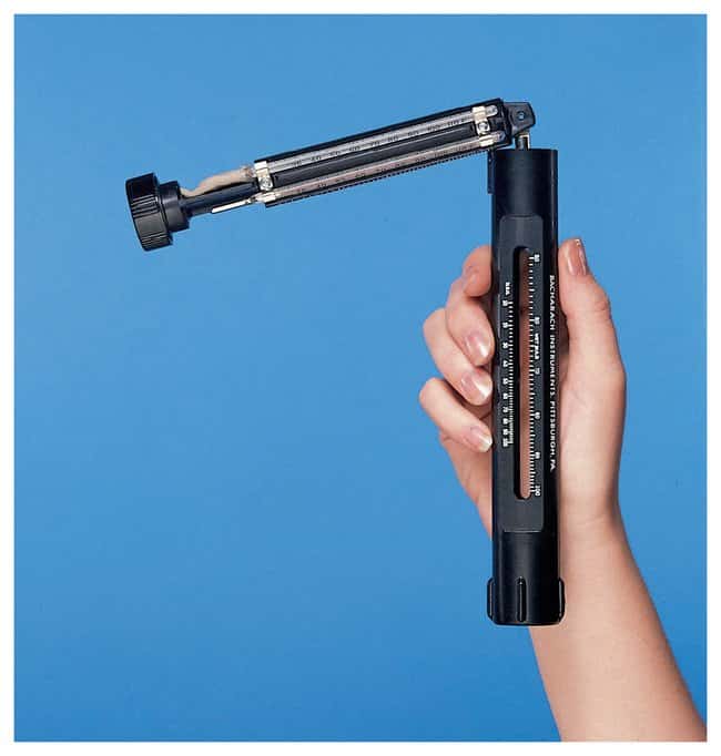

Wet/Dry Bulb Psychrometer (Wet Bulb Depression)
You’re probably familiar with this—two side-by-side thermometers (bulbs), one covered with a wet sock (wick), the other dry. Evaporation cools the sock. Charts and equations convert the readings to RH, dew point, or absolute humidity. For proper evaporation and accuracy, there should be air flow. Figure 4 shows a sling psychrometer which you whirl around in the air. In continuous measurement systems, a fan creates the air flow.
Per ASTM standard EE337-02, accuracy can be +2 to 5% RH. Watch out for salt buildup in the wick.
