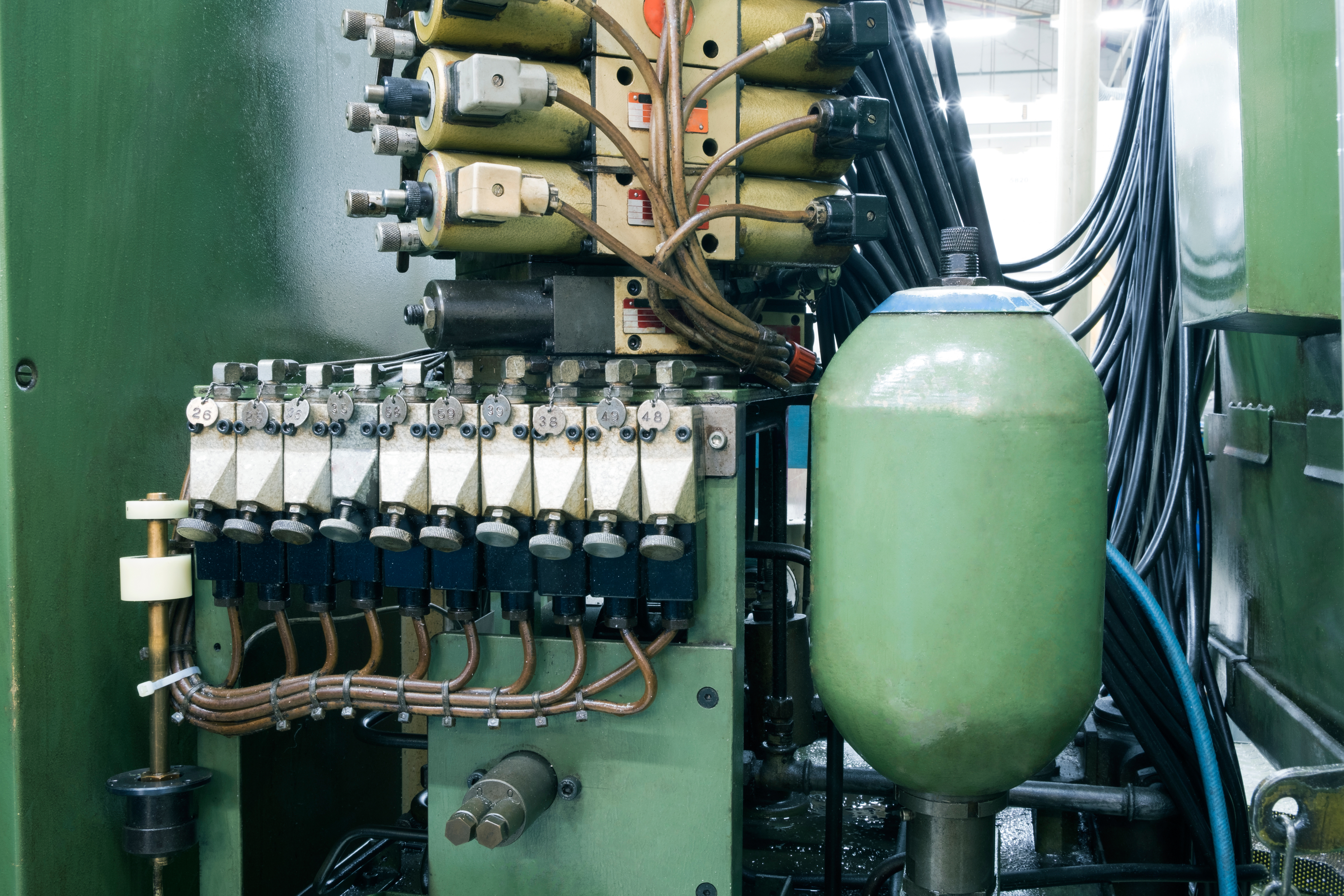

You might be familiar with most hydraulic components, such as pumps, valves, motors, and actuators, but there is another very important component called an ‘accumulator’. As the name suggests, an accumulator is a vessel that stores, maintains, and recovers pressure.
hydraulic accumulator located within fluid system
Figure 1. A hydraulic accumulator located within a fluid system. Image used courtesy of Adobe Stock

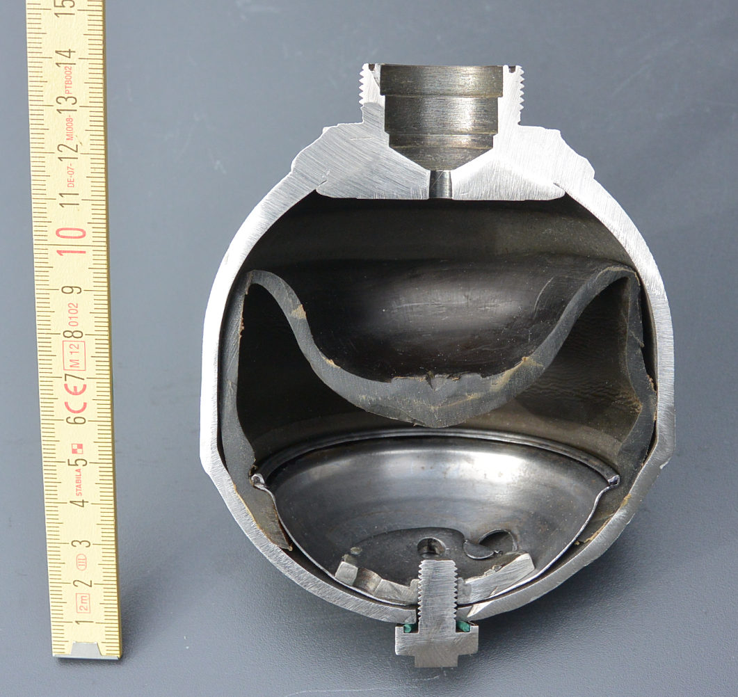

As we all know from middle school science class, as the amount of material filling a container’s volume reduces, the empty space needs to fill with air. In an accumulator, compressed gas is used to take up the empty space, but we don’t want the gas to mix with the hydraulic fluid, so there is typically a bladder inside the accumulator which separates the hydraulic fluid from the compressed gas.
Essentially, an accumulator is a vessel containing a bladder and gas so that as the bladder fills with pressurized hydraulic fluid, the gas compresses inside the vessel. When the fluid in the accumulator is released, the compressed gas pushes out the fluid.
The accumulator will come preloaded, which means a minimum pressure is required for fluid to flow into the accumulator. This preloading can be through springs, gas, or weights. There are bladder, piston, and diaphragm accumulators.
An accumulator can be compared to a battery or capacitor—it stores energy, but why would we want to store pressurized hydraulic fluid?
cross section view of fluid accumulator showing fluid entrance / exit valve port at top
Figure 2. Cross-section view of an accumulator showing the flexible diaphragm and pressure chamber at the bottom (fluid entrance/exit valve port at the top). Image used courtesy of Wikimedia

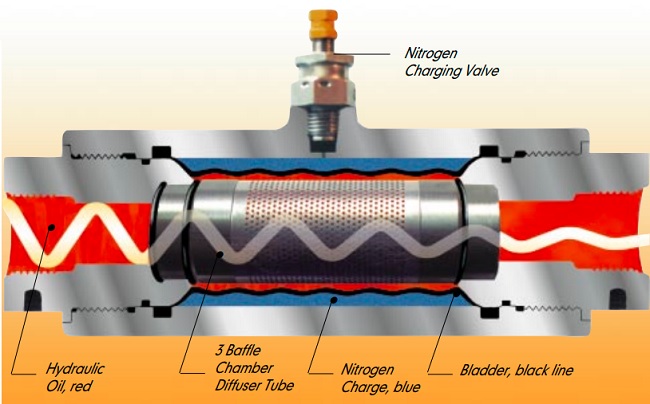

inside rendering of noise suppressor to reduce shock and vibration noise using same inert gas-filled chamber concept as standard accumulator
Figure 3. Inside rendering of a noise suppressor to reduce shock and vibration noise using the same inert gas-filled chamber concept as a standard accumulator. Image used courtesy of Wilkes and McLean

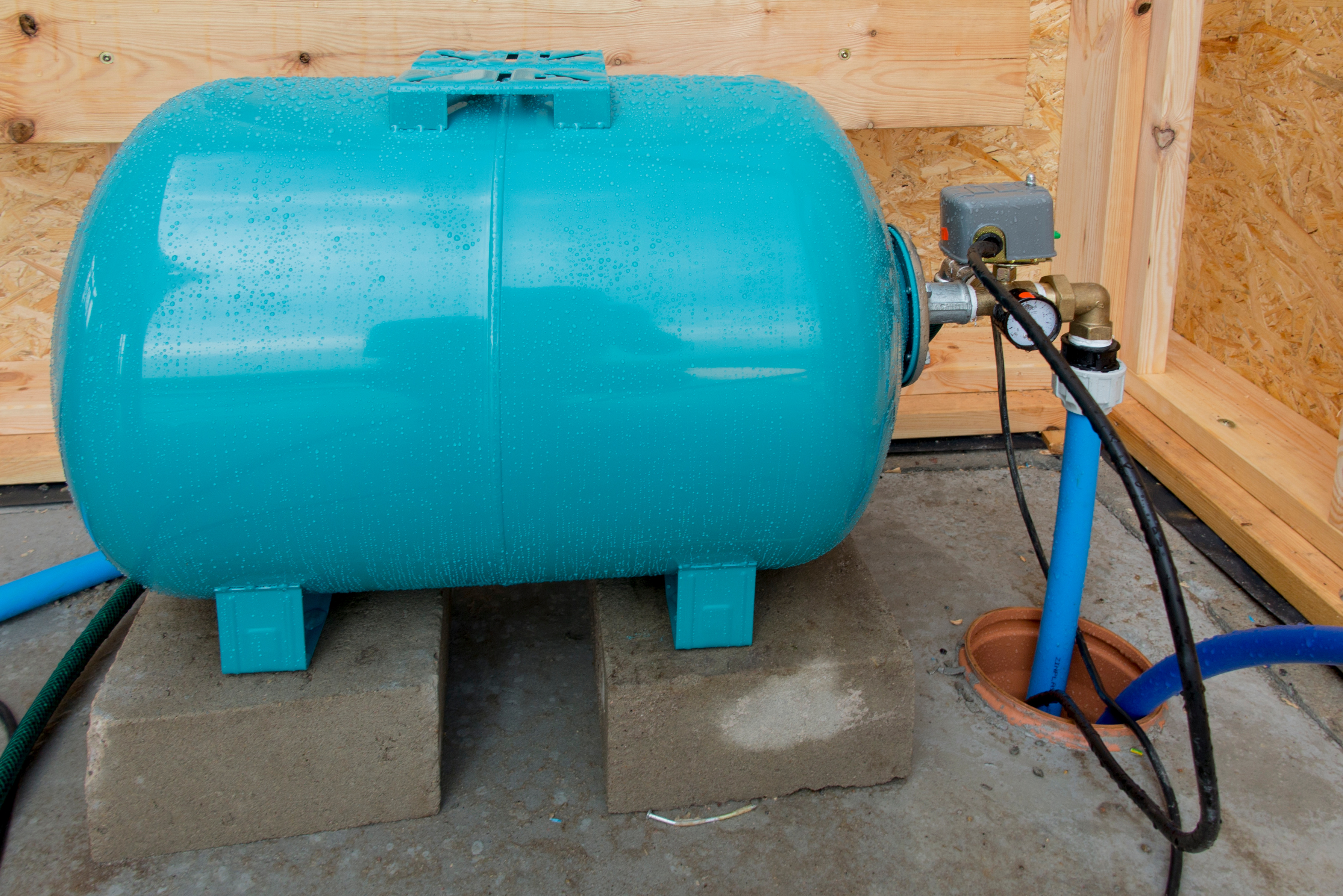

In this same way, the common pressure tank inside a residential water system is a form of an accumulator, but rather than operating under emergency conditions, it simply allows the pump to operate on a less frequent cycle as opposed to continuously whenever water is demanded.
If you are trying to dampen pulsations and reduce noise from the pump, you might want to place the accumulator very close to the pump’s output. All the fluid would always flow through the accumulator dampening the vibrations produced by the pump. Because the accumulator stores energy, you will want to keep the accumulator on the high-pressure side of the system. A piston-style accumulator is best placed close to devices that cause pulsations to dampen those pulses.
pressurized water storage tank with a charged gas chamber inside to maintain a consistent water pressure in a whole-house system
Figure 4. Pressurized water storage tank with a charged gas chamber inside to maintain a consistent water pressure in a whole-house system. Image used courtesy of Adobe Stock
