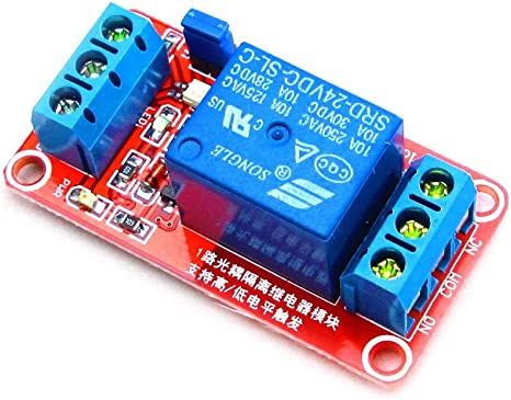

I was connecting some external relay module boards to the output terminals of a PLC system. This output module was a DC 24 volt output, and the relay boards had rated a coil voltage of 24 volts as well—not an unusual scenario.
Output modules include analog and digital, sourcing and sinking
Figure 1. PLC I/O modules are flexible but can have many hidden surprises when connected to various load devices. Image used courtesy of Canva
The purpose was to interface a signal to a small microcontroller so the 24 volt PLC output would be far too much for the 5 volt tolerant controller GPIO. Buying the small relay boards was more cost effective than a new relay output module for the PLC or purchasing 24 volt ice cube relays.
After wiring the boards to the PLC output module and verifying the logic, I found that the relay board would energize but not all would fully de-energize.

Further datasheet research indicated that the relay board module had an opto-coupled isolation between the input terminal to the actual relay coil.
24 volt relay board used to interface with an Arduino
Figure 2. The 24 volt relay board, the tricky subject of today’s challenge. Image used courtesy of Amazon
Since these optocoupler devices are quite common for isolation in industrial devices, I wanted to learn more and figure out why this situation did not function as intended.

In optically coupled devices, a small amount of power is required to drive an IR LED inside a small, sealed integrated circuit (IC) package on the board. The light from that LED strikes a phototransistor which then acts as a valve, allowing more current to flow through the relay coil in an external circuit.
In order to forward-bias an IR LED, it requires a small voltage–smaller than for most visible color LEDs. A value of less than 2 volts is usually more than enough.
With this knowledge, it was now clear that the measured voltage of 2.2 volts from the output module was enough to turn the LED on, even when the output terminal was logically de-energized.
The IR LED inside the optocoupler required less voltage than the visible red indicator LED. This means that, although the in-line resistor was allowing only barely enough power for the red LED to glow, the IR LED deep inside was still glowing.

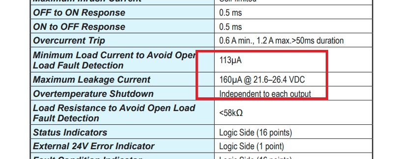

Leakage current from a digital output module
Figure 3. A module specification sheet illustrating the maximum rated output leakage current (in the off state)
2) Verify the Specifications of the Output Module
Unlike relay modules, digital output modules have a resistance of less than infinity when de-energized, though the resistance is still quite high. High resistance leads to a low leakage current rated on the module datasheet.
For most output devices, like a solenoid or contactor, that leakage current won’t even come close to energizing the device. However, if the output device only needs a small amount of operating current, it may remain energized.

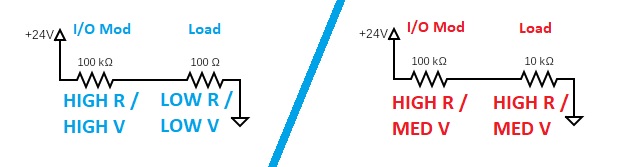

Digital Module Output Resistance
In the case of a digital transistor output (and AC triac output modules are included), the resistance is very low when ‘on’ and very high when ‘off’. Since it must be considered a voltage divider, the resistance of the load is a significant player.
Digital output with big and small loads
Figure 5. I/O module with high resistance, paired in series with a low-resistance load on the left, and a higher-resistance load on the right.
If the resistance of the load is low (like a solenoid), the high ‘off’ resistance of the module, paired with the low resistance of the load, will result in a very low voltage for the load, as shown on the left in Figure 5. This voltage is too low to allow sufficient current–which is also a function of the resistance.
In a high resistance load, such as our optocoupler, there is now a high ‘off’ resistance in the module, paired with a high resistance of the load, and the voltage will be significantly higher, as shown on the right Figure 5.
Since the voltage is higher and the current needed is quite low, it might just remain energized.
Even remaining energized when the output module is turned off.
