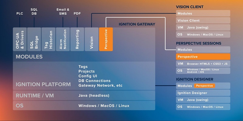

Ignition workflow diagram
Figure 2. Ignition Technology Stack. Image used courtesy of Inductive Automation

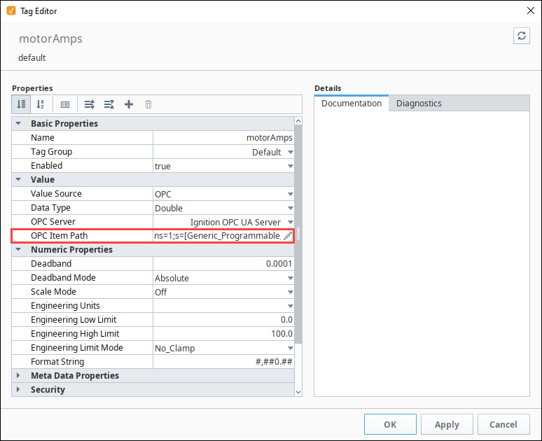

OPC Tags
Ignition has a built-in OPC-UA server that supports connections to various PLCs with drivers that can be selected in the gateway when configuring a device. Thus, OPC tags represent the value of memory addresses within a PLC or a physical “things” value connected to an IoT device. The object is mapped via the “OPC Item Path” where “ns” denotes the namespace of the OPC-UA server and the “s” represents the name given to the device in the gateway.
OPC tag menu
Figure 4. OPC tag editor menu. Image used courtesy of Inductive Automation

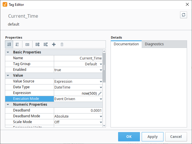

Expression Tags
These tags utilize a formula to return a final calculated value. They can reference other tags' values and properties but cannot reference properties of components within the local client or session. A simple example that Inductive automation provides is the use case of converting a temperature tag value from Celsius to Fahrenheit.
Expression tag menu
Figure 5. Expression tag editor menu. Image used courtesy of Inductive Automation

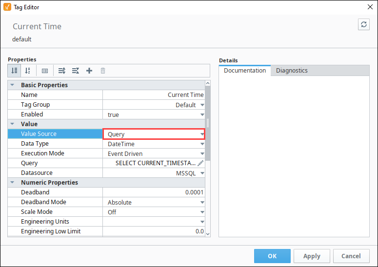

Query Tags
This tag returns the resultant value or dataset of a SQL query. The trigger for execution can be scheduled on an interval in the execution mode field, and the database connection can be selected from the Datasource field. The ignition platform requires a SQL backend database, and historical or dimension data can be referenced with these tags.
Query tag menu
Figure 6. Query tag editor menu. Image used courtesy of Inductive Automation

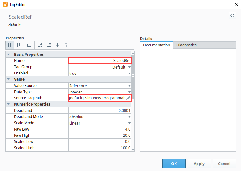

Reference Tags
These tags refer to other tags in the tag browser. If a script changes the value of a reference tag, the write will be performed on the source tag as well.
Reference tag menu
Figure 7. Reference tag editor menu. Image used courtesy of Inductive Automation

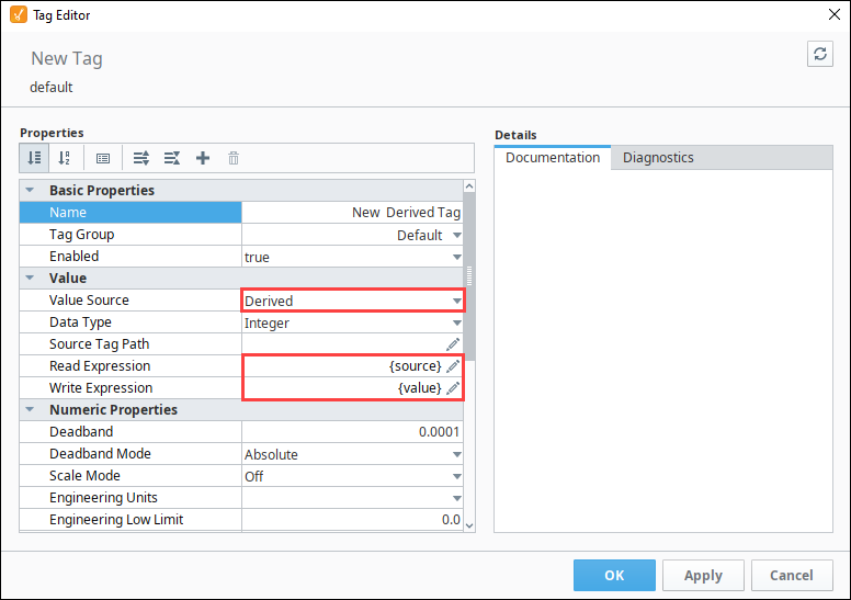

Derived Tags
These tags are very similar to reference tags but can apply expressions to the referenced tag’s value. This allows for the derived tag to display a different value than the source tag, or send a modified value of a write operation to the source tag.
Derived tag menu
Figure 8. Derived tag editor menu. Image used courtesy of Inductive Automation

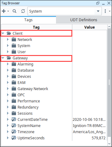

System Tags
These tags vary from the aforementioned standard tags in that they are generated by the Ignition platform and cannot be deleted or altered. Unique to the Vision module are client tags that provide information about the host running the Vision client, such as hostname and IP address. The gateway tags provide system-level details of the central gateway to which the client is networked.
System tag options
Figure 9. Client and gateway tags. Image used courtesy of Inductive Automation
