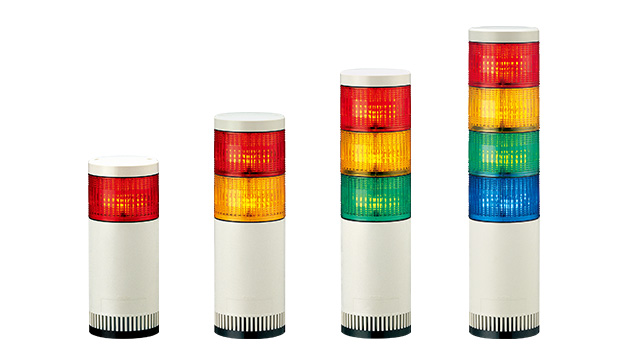

A visual annunciator provides an alert to indicate important information to users, such as warning or alerting about targeted events, conditions, or alarms in a process. Visual indicators in everyday life typically use LEDs or other light-emitting devices to gain attention through a graphically displayed message. In industrial or manufacturing environments, a stack or light tower is the device used to convey an alarm status. Figure 1 illustrates a typical light stack.
A set of stack lights or light towers
Figure 1. A typical stack light, sometimes called a tower light. Image used courtesy of Patlite

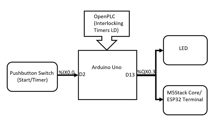

Figure 3 shows the system block diagram of this Arduino-OpenPLC visual annunciator project.
Arduino block diagram for visual annunciator project
Figure 3. Block diagram of the Arduino-OpenPLC Visual Annunciator. Image used courtesy of the author
The OpenPLC ladder diagram (LD) software will perform an interlocking function of two pulse timers. The pulse timers timed contacts will allow the LED to flash at a predetermined flashing rate.
We will display two alternatives for the graphical HMI: an M5Stack Core or an ESP32 Terminal, both of which are programmable LCD units, providing an alarm indicator based on a specified programmed color. Information on the pulse timers and the M5Stack Core can be found in a previous article. ESP32 Terminal unit information can be found in a separate project with a related code.

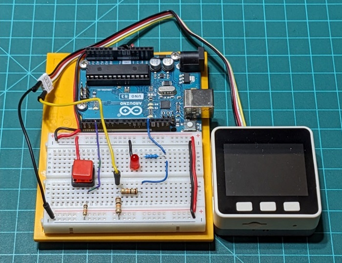

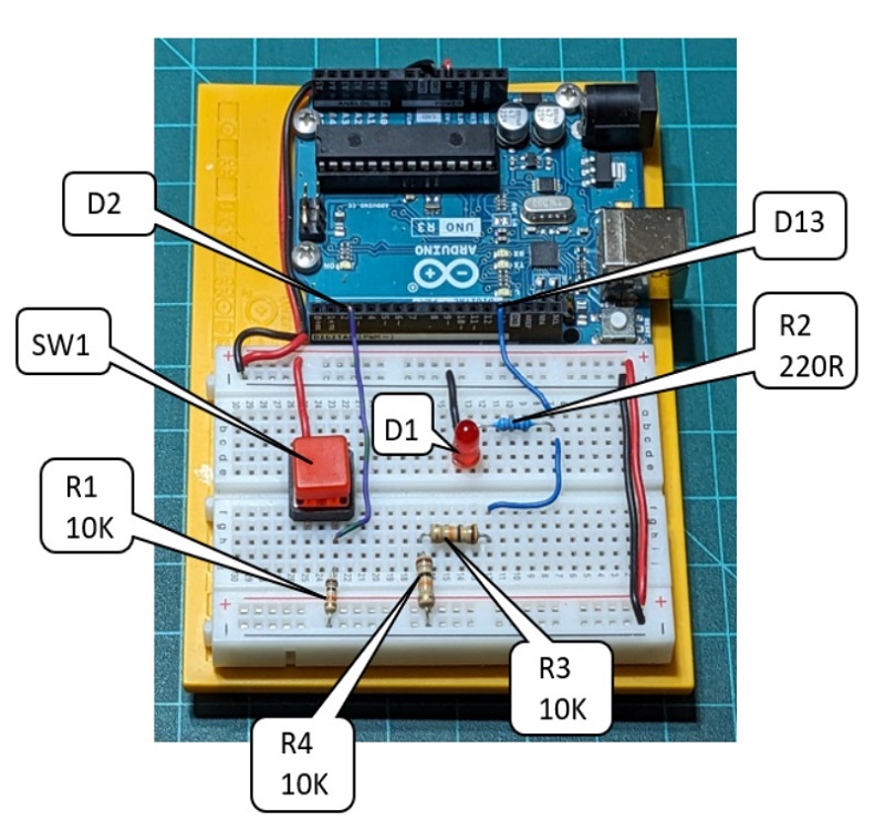

The actual solderless breadboard layout provided in Figure 6 with reference designators may be used in wiring the modified controller.
Solderless breadboard image for the Arduino LED, switch, and M5Stack core project
Figure 6. The solderless breadboard build layout with reference designators. Image used courtesy of the author

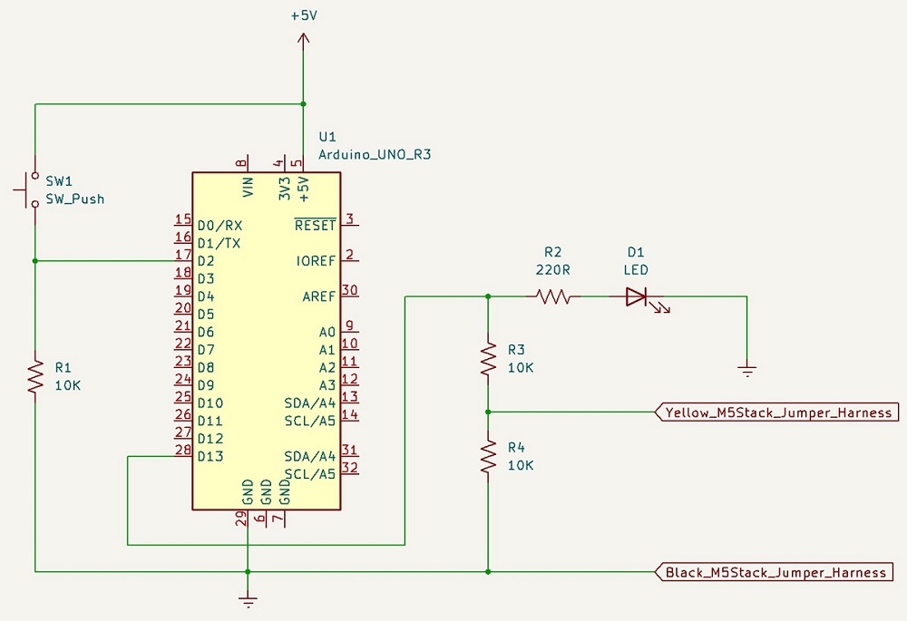

The electronic circuit schematic diagram for the Arduino and external hardware connections is shown in Figure 7.
Schematic view of the Arduino circuit for the visual annunciator project
Figure 7. The Arduino electronic circuit schematic diagram. Image used courtesy of the author

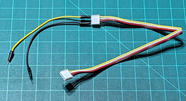

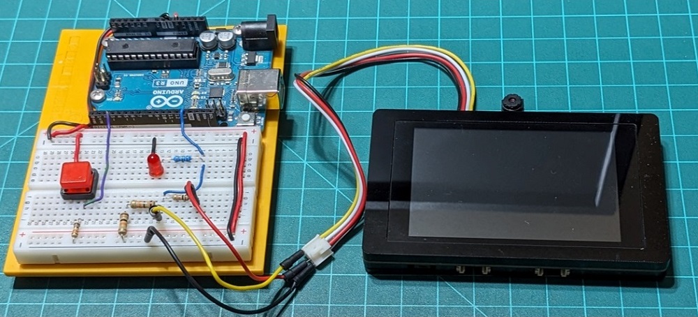

Wire extensions are used to attach the M5Stack Core and ESP32 Terminal headers to the Arduino-OpenPLC controller in the breadboard. Figure 8 illustrates adding wire extensions to the jumper harness.
Wire harness with extended jumper wires
Figure 8. The modified M5Stack jumper harness with wire extensions. Image used courtesy of the author
Figures 9 and 10 respectively illustrate the electrical attachment of the M5Stack Core and the ESP32 Terminal to the Arduino-OpenPLC controller. Both connections use a similar header, so the wiring is quite similar between both HMI units.
Completed circuit image using the M5Stack Core HMI
Figure 9. The M5Stack Core is attached to the Arduino-OpenPLC controller. Image used courtesy of the author
Two small changes are reflected in Figure 10 below when using the ESP32 Terminal unit. This controller uses inverted logic to detect the presence of the signal, supplying 3.3 v from its own GPIO terminal. This requires both a control voltage supply and ground, so a red wire is introduced. Additionally, the 5 v provided directly by the Arduino pin 13 is required to prevent the flow of current from the pin, note the change in placement of the yellow jumper wire below.
Completed circuit image using the ESP32 Terminal unit HMI
Figure 10. The ESP32 Terminal is attached to the Arduino-OpenPLC controller. Image used courtesy of the author

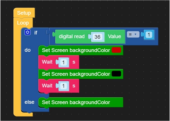

The M5Stack Core software was developed using UiFlow Blockly code, a no-code approach to creating visual-appealing UIs for the M5Stack Core. This development software platform aligns well with the OpenPLC, since ladder logic is a no-code structure as well.
The UiFlow Blockly code shown in Figure 11 processes a control signal from the M5 Stack Core produced by the Arduino digital pin 13. A +2.5 v signal generated by the resistor input circuit interface represents a data bit binary 1 value. Conversely, a 0 v signal generated by the resistor input circuit represents a bit value of 0.
When the M5Stack Core receives a binary 1, its display will flash red. A binary 0 value will display green. Green occurs when the pushbutton switch (SW1) is pressed. This triggered event stops the flashing signal from the Arduino digital pin 13. As mentioned before, M5Stack Core setup and programming have been covered previously on Control.com.
UiFlow Blockly code for the UI on the M5Stack core
Figure 11. The M5Stack Core LCD flasher Blockly code. Image used courtesy of the author

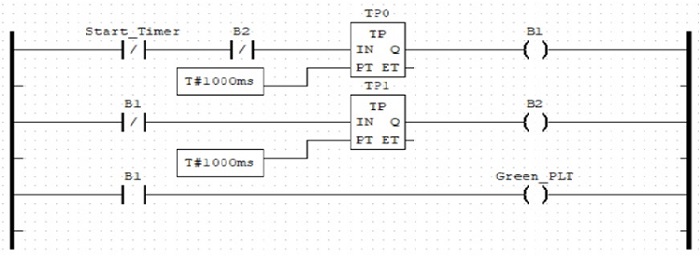

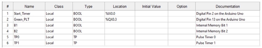

The OpenPLC interlocking timer tags are shown in Figure 12 and the ladder diagram is provided in Figure 13.
According to the current LD, the flasher will operate only when SW1 is in its default released state. A manual control operation of the interlocking timer (flashing only when SW1 is pressed) can be established by simply changing the Start_Timer bit to an Examine If Closed XIC instruction in Figure 13.

Figure 13. The OpenPLC Interlocking Timer LD. Image used courtesy of the author
