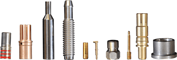

Industrial wire connectors
Figure 1. A variety of connector contact styles. Image used courtesy of Connector Contacts
Connector Contacts Types
Connector contacts come in many types, manufactured in several industrial ways. Machined contacts come with great power density, higher current, and lower resistance as compared to stamped contacts. Stamped contacts, being more easily crimped, are used in areas where wire termination expense is a great concern while still achieving reliable performance.
Some of the contacts available are thermocouple contacts, used in temperature measuring and testing applications, as well as hermetic contacts used for air and gas-tight connection areas.
Contacts can be further classified as assembled and non-assembled types. The contacts are also classified as signal and power; signals communicate information from the source to the destination, while power transfers current and voltage to operate the equipment or component.

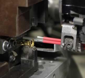

Crimp Termination
In these connections, a tool is used to mechanically tighten the metal contact around the stripped cable wires for complete electrical contact. One part of the contact crimps the metal itself, while the other part crimps the wire insulator. To make a better crimping joint, we use a crimping tool around the insulation and the wire.
Wire crimp machine
Figure 2. Crimping termination. Image used courtesy of Omega Leads

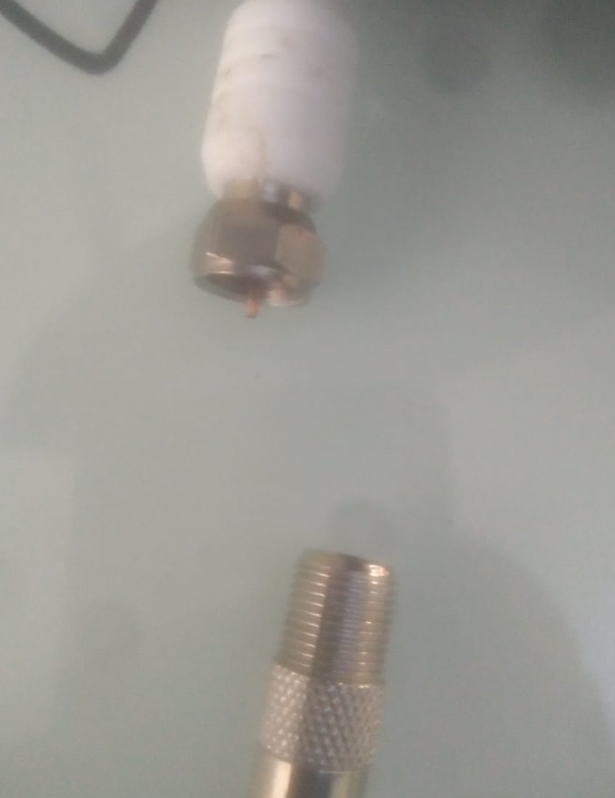

Screw Termination
Some connector contacts use a screw mechanism to terminate. A wire is inserted into the contact receptacle then an inbuild screw secures it. Such type of termination does not give a compact connection as other types do but comes with the advantage of easy removal of the wire in the fields.
Coax wires
Figure 3. Screw termination for a pair of coaxial connectors. Image courtesy of the Author

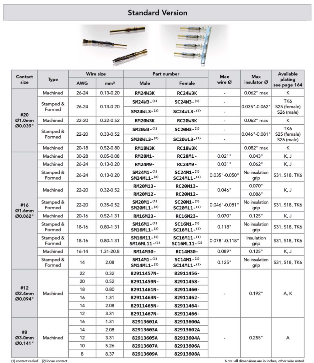

Wire Size
Wires come in different sizes and the size of the wire will determine the size and type of the connector contact that the user should select. See Figure 4 below for the various standard sizes of crimping contacts.
Wire sizing table
Figure 4. Crimping contact standard sizes by UTS Series Pg. 164/165
