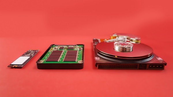

Solid State Drives
One of the biggest time sinks during regular operation and rebooting is accessing data from the hard drive. Spinning magnetic disks take significantly more time to access than solid state drives (SSDs). Standard drives require the motion of a read head, which must be accurately positioned over the spinning disk. The disk must spin up every time data is accessed. All of this takes precious time.
Hard disk drive compared to solid state drives
Figure 1. Substituting disk hard drives for solid-state drives can be a quick optimization for speed, but it can be time-consuming to make the swap for each controller. Image used courtesy of Adobe Stock
While most devices today are shipped with SSDs, devices that do not include one can be quickly and affordably upgraded. The performance will drastically increase with an SSD over a magnetic disk drive.

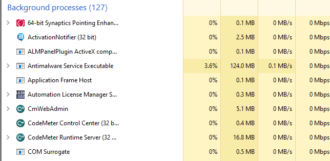

Background process loading
Figure 2. The first in a LONG list of background processes for one PC that is used to program automation equipment. Image used courtesy of Control Automation
Reducing Unnecessary Clutter
Another way to speed up rebooting time is to cut out all of the unnecessary “clutter” during startup. Every software package seems to think it is super important and needs to be a high priority in the startup routine of the computer. Other than basic device control, certain timing and synchronization tools, cybersecurity tools (such as antivirus software), and a few other important processes, most of those other programs in the startup routine can be eliminated.
Large time wasters are programs like “driver finders”, software for virtual meetings, and certain update checkers. Let these open only when they are needed; do not embed them into the startup routine. In fact, this is one of the primary benefits of using IPCs for machine control rather than traditional PCs: industrial computer systems can be kept free of ‘clutter’ software that isn’t entirely relevant to the operation.

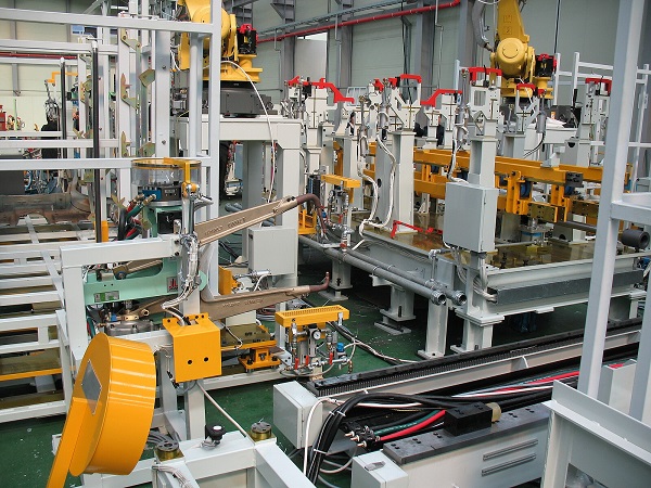

When designing process equipment, it is often an advantage to use the same controllers for all pieces of equipment. This makes troubleshooting and integration efforts much easier. One disadvantage to this method is when a necessary software upgrade is required. If the updates are done remotely, all of the controllers might receive a reboot at the same time. Engineers and technicians should be aware of major software upgrades and stagger the reboots to maximize the total uptime of the process. This will involve shifting the workload between identical machines as they perform their rebooting cycles.
Equipment workcells
Figure 3. Identical equipment controllers should be rebooted in stages, if possible, when software updates are planned. Image used courtesy of Wikipedia Commons
