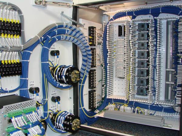

industrial control panel (ICP) contains electrical and control devices
Figure 1. An industrial control panel is at the core of a control system, containing electrical and control devices. Image used courtesy of Canva

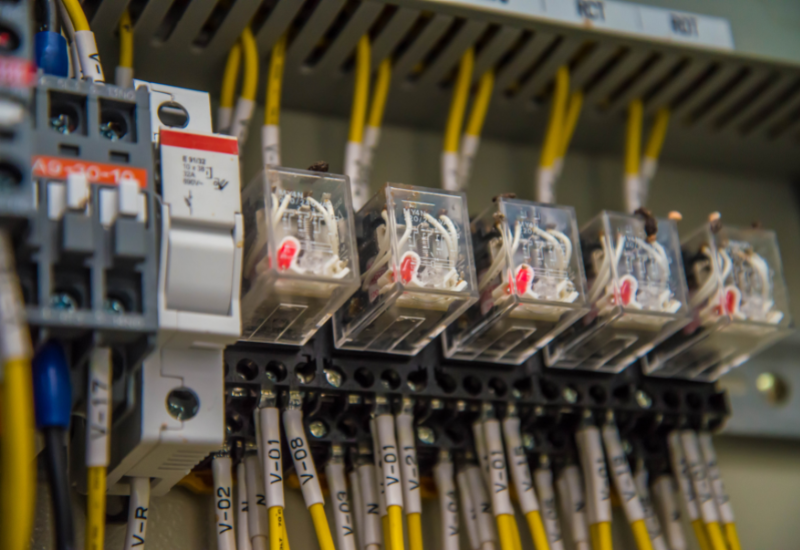

industrial control panel labeled wires for general icp practice
Figure 2. Labeled wires in an industrial control panel. Image used courtesy of Canva
General
  • Ensure the panel has enough space to accommodate all devices, with sufficient gaps between them when needed. If the surrounding area is not a major concern, always design for proper spacing between components to improve heat dissipation and make future additions simpler.
  • Similarly, ensure that wire trays and ducts are sized appropriately, considering the amount and size of the cable to be run through them.
  • Label devices and wires. The benefits of quickly finding and tracing wires are underestimated. Sometimes, the single action of trying to locate a wire inside a panel can translate to long production outages. Unfortunately, there are still many panels out there that do not follow this practice. In many cases, the labels are lost over time and never replaced.

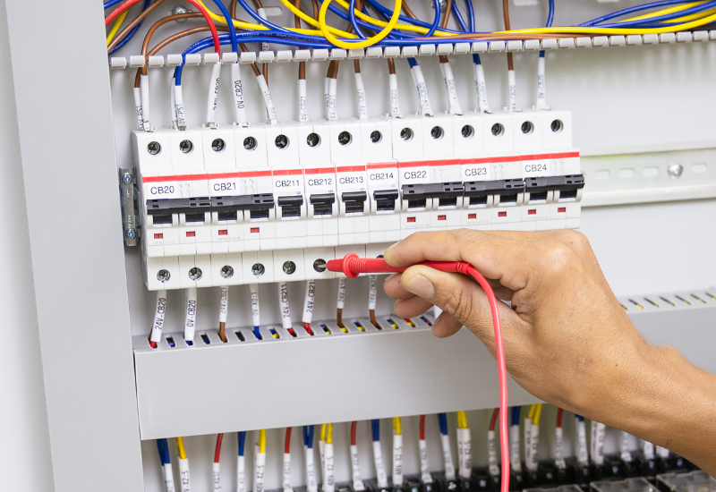

supplemental electrical protection for circuit protection
Figure 3. Supplemental electrical protection. Image used courtesy of Canva
Electrical
  • Proper electrical grounding is critical. Follow grounding rules established in the standards and use high safety factors when able to do so. Improper grounding is among the top causes of failure of control devices.
  • Include auxiliary circuit breakers and fuses when possible. Breaking down and splitting power branches inside the ICP is preferred when the available space allows it.
  • Use shielded cable.
  • Separate sensitive devices and wires from high-power elements. For example, CAN bus and Profibus wires should not be near the main power supply cables. Electromagnetic noise from these cables can affect the transmission capabilities of control and bus cables.
  • Install labels and warnings as required by the standards, and include additional warnings for residual risks.

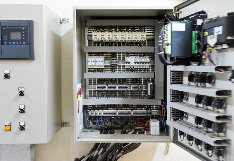

cable management for industrial control panel design
Figure 4. Cable management is crucial in ICP design. Image used courtesy of Arimon
Wiring
  • Design using a CAD tool that helps optimize wiring routes. Doing this helps save on material costs and reduce wire installation time.
  • Run wires vertically or horizontally, never diagonally. Never run wires in front of any devices.
  • Use stranded wire whenever possible. Stranded wire provides better heat dissipation and bends more easily than solid wire.
  • Leave sufficient wire slack for future use. Always conceal wire slack under the main wire way, never inside the wire routes near devices.
