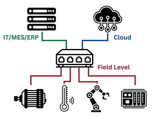

Components of a Predictive Maintenance System
A modern and effective Predictive Maintenance solution requires comprehensive real-time data collection and accurate AI-driven analytics. To achieve this, several layers of hardware and software are needed.
- Sensor/Field Device Layer
These are the devices that tap directly into the source of the information we need. Some of the most common sensors employed in predictive maintenance are vibration, temperature, pressure, and current.
- Edge Computing Layer
Edge computers are devices that perform some initial processing of the raw data obtained from the previous layer. This initial processing is done as close as possible to the source of the data in order to reduce bandwidth usage through a network.
- IoT Gateway Layer
These gateways receive data from edge processors and field devices, encrypt it, and forward it to a centralized server or the cloud, depending on the design preference.
Figure 2. The main components of a predictive maintenance system. Image used courtesy of Control Automation
- Cloud/Server Layer
This is the realm of AI. Cloud or on-premise servers can store data in either its raw form (simple numeric lists) or processed form (tabulated and sorted into data sets) for analysis and recording. Databases are compiled and coalesced to form data warehouses. Once the data has made it all the way to this point, it is ready for AI-based algorithms to take over.

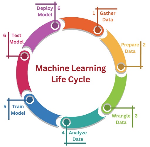

Machine learning is also a cyclical process, or a continuous improvement process, if you will. The machine learning life cycle consists of seven major steps: Gathering Data (selection and ingestion), Data Preparation (exploration and pre-processing), Data Wrangling (cleanup), Data Analysis (algorithm selection), Model Training, Model Testing, and Deployment.
Figure 3. The Machine Learning Life Cycle is a cyclical process. Image used courtesy of Control Automation
Now, let’s connect the dots together. The previous two sections of this article have described how predictive maintenance requires data in order to make predictions and have provided an overview of the system architecture you would need to implement in order to gather that data. We are at step number one of the ML Life Cycle.
We hope this helps to paint a picture of how important the first step is. Machine learning, and therefore artificial intelligence in general, needs large amounts of relevant data points in order to give accurate predictions. What exactly constitutes a “large amount” of data? The answer to this will depend on the size and the complexity of your machine or system. The more variables upon which your process depends, the higher the complexity of your dataset. Wouldn’t it be easier to just include all the process variables you already measure? This is possible, but not advisable. Machine learning employs algorithms whose computing cost can grow exponentially when too many variables are used. It is important to select relevant variables for the algorithm. In other words, select only those variables that have an impact on the prediction outcome.
