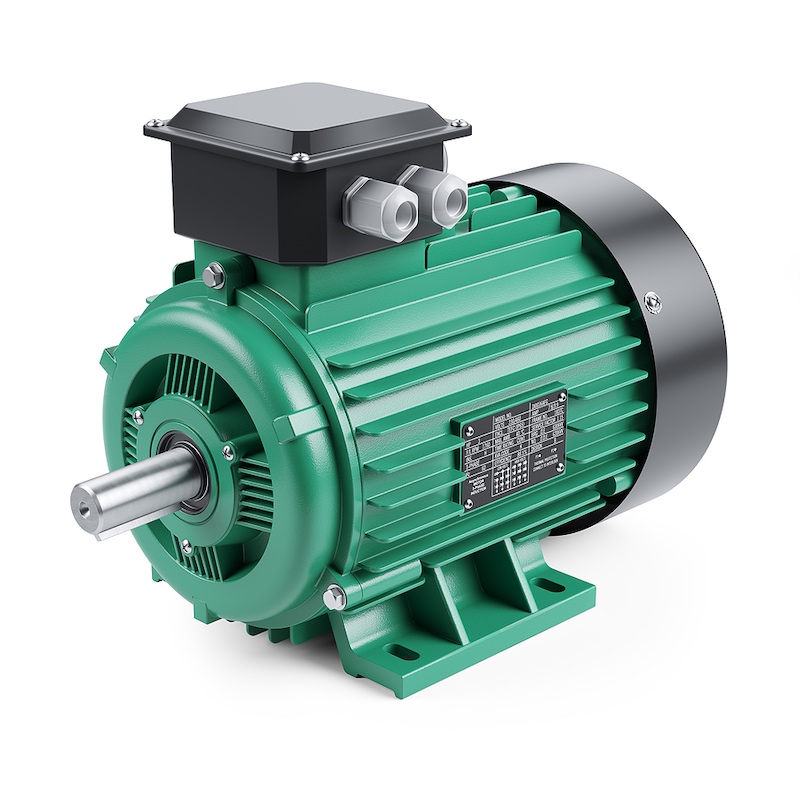

Electric AC motor.
While this might help, it is important to understand how humidity and temperature can affect lubrication. Some motors and bearing are considered lubricated for life and should be left alone. In fact, this can lead to increased wear and tear by damaging seals and over lubricating.

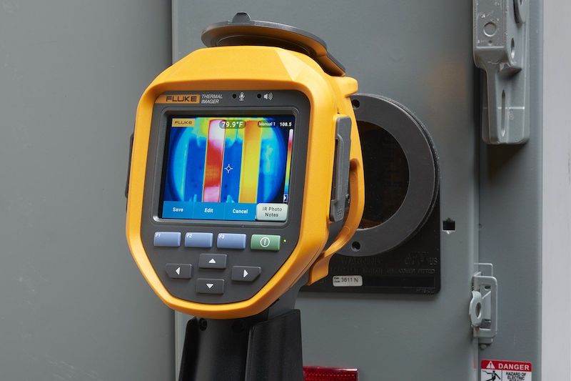

There are many monitoring devices available. Fluke offers a thermal imaging camera that can show the temperature of a motor. It can’t look inside, but most industrial motors will have a tag indicating a normal operating temperature that the camera is able to verify at a glance. Additionally, thermal cameras are able to detect temperatures over the entire motor or an area that can help when troubleshooting temperature concerns.
A thermal imagine camera. Image courtesy of Fluke
