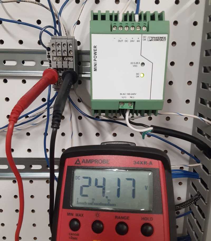

The digital meters usually have a fixed internal resistance due to the use of a solid-state analog to digital converter, this being much higher than the low-voltage input resistance of the analog models. An example value for these meters is around 10,000,000 (10 mega) ohms (ref Fluke 80 series). It would take a scale range of 500 volts for the previous example analog meter to match the internal resistance of this digital model.
Digital multimeter
Figure 3. The author’s digital multimeter (DMM), here being used to measure an industrial 24 volt power supply.
In modern troubleshooting, a great number of devices are powered by semiconductor guts. Why? Simply to cut down on energy consumption. If you can complete a task using a lot of electricity or a small amount of electricity, the smaller amount would seem logical.
Using a small amount of electricity means small operating voltages and small currents (in other words, high resistances). Looking back to the previous section, this is exactly the situation in which analog meters may be the under-performers.
The digital meter may be the tool of choice in the following situations:
  • The circuit under test is a high resistance with low current consumption
  • The voltage difference between the test points is low
Note that often, the voltage of the test does not affect the resistance of a digital meter like it does for the analog models. However, knowing that the resistance of a DMM is higher, it may be the preferable choice when the circuit voltage is low.
If a technician were troubleshooting PCB traces, or identifying a faulty transistor-based photoelectric sensor, the digital meter may be the preferred tool. But even in this latter case, an industrial power supply of 24 volts would yield a resistance of nearly 500 kOhms for an analog model using our example impedance, and this would certainly provide information accurate enough to troubleshoot a fault.
