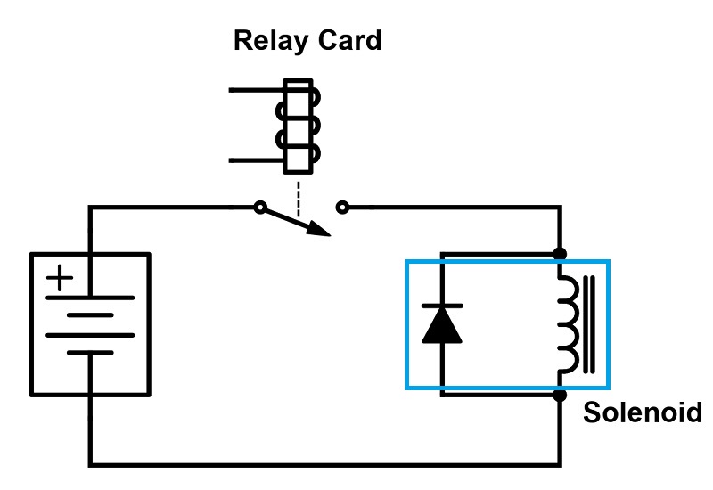

Figure 1. A circuit schematic showing the polarity relation between the solenoid load and a typical flyback diode, common in this scenario. An actual wiring example is shown later.

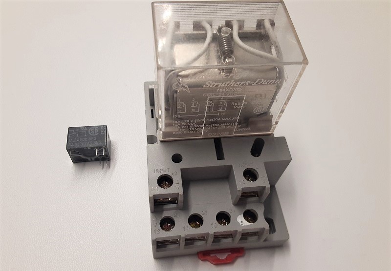

Figure 2. Compared to a DIN mount 4PDT relay, the small size of a circuit board relay shows how relatively sensitive these devices can be.

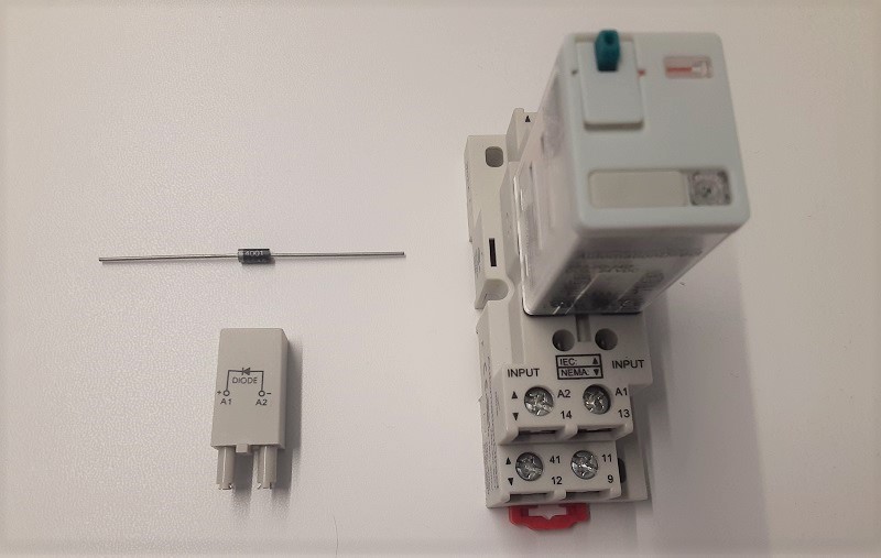

Figure 3. Two diodes on the left of the relay - top is a 1N4001 from a component distributor, the lower is a purpose-built model for use on the relay socket.
Many manufacturers, being aware of this problem, design integrated solutions, with the diode installed directly into the wiring of a terminal block or right inside the coil-based device itself. Just look for the word ‘diode’, and be sure to install with the right polarity.
Diodes are solid-state devices with only two wires, and electricity can only flow in a single direction. They are installed in parallel with the inductive load, so that when the load is energized from the controller, the diode is reverse biased and allows no bypassing of current through itself.

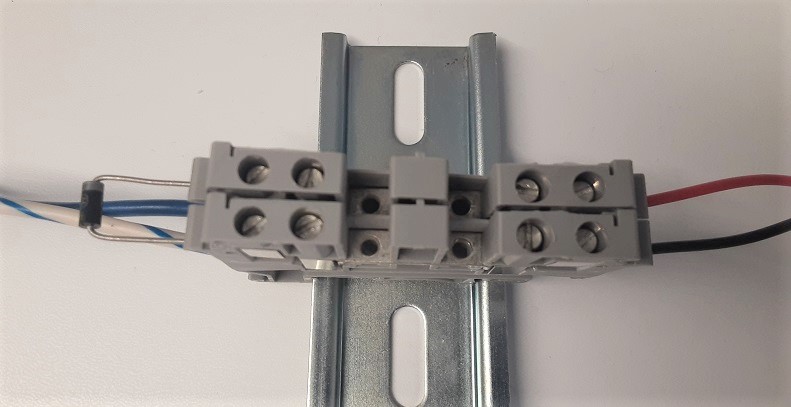

Figure 4. An example circuit showing a diode connected to a double-level terminal block. Red/Black and Blu/WhtBlu are used to show the polarity of the load, compared with the diode (note the gray stripe on the diode body).
However, the moment the control voltage is removed, the magnetic field attempts to generate a voltage on the coil, with the coil now becoming almost like a high-voltage battery. Instantly, this forward biases the diode, allowing current to travel in a short loop, coil-to-diode. The diode is able to withstand large currents for a very short time, so the magnetic field (and current) is safely exhausted in the blink of an eye.
Because the diode holds the voltage to less than one volt, the voltage will never increase to a level of spark generation, so the fear of hazard is removed.
