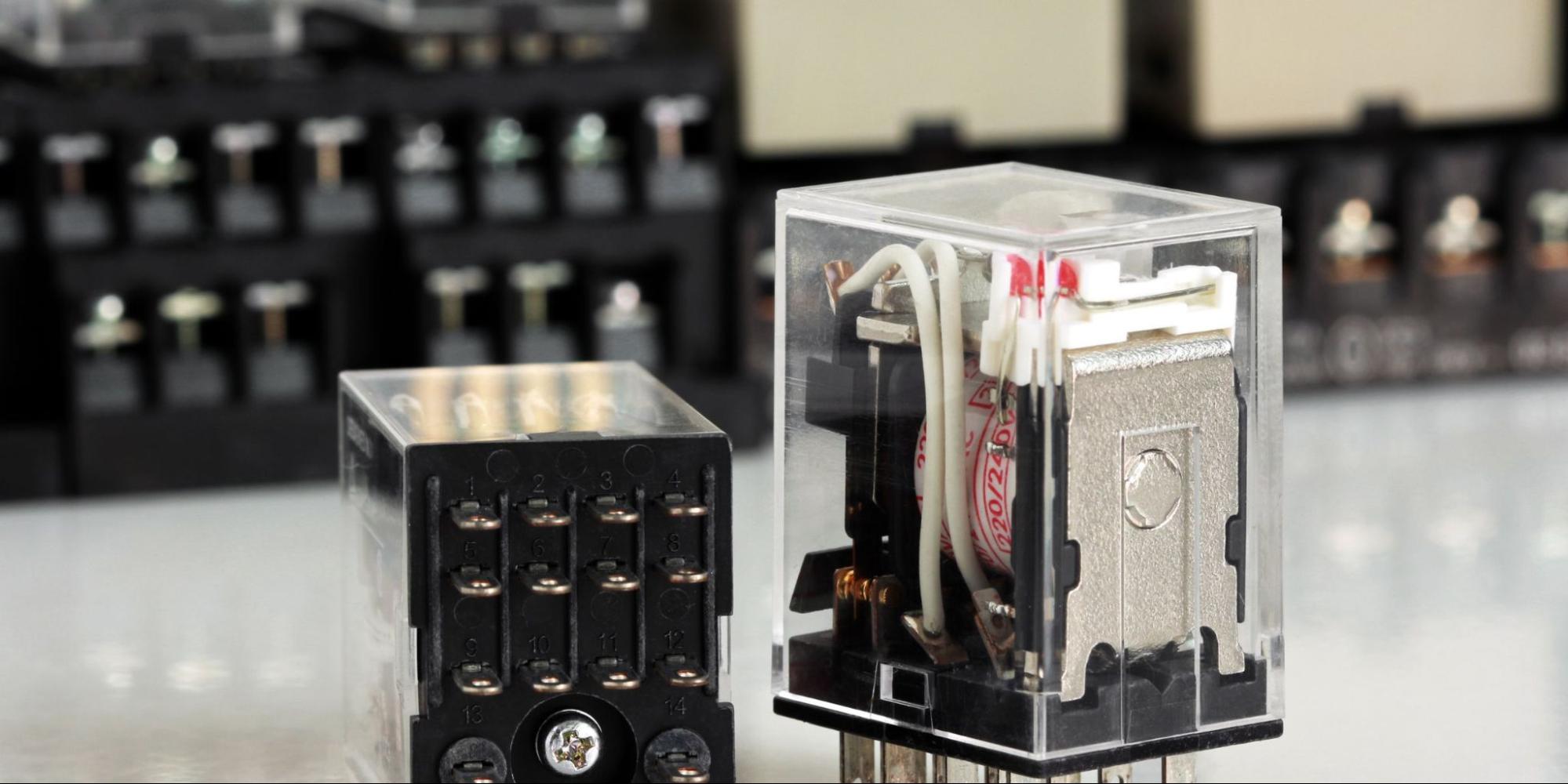

The answer to this question depends on the type of relay, but for the mysterious part of the answer, we’ll consider using only a standard DC ice cube relay with no protective add-ons or LED indicators.
Figure 1. Standard 24 volt DC coil relay in the ‘ice cube’ style.
These add-ons, which include flyback diodes and MOVs in addition to LED status indicators, can be attached with polarized or keyed connectors. This forces the technician to install the device correctly or risk failure.
However, for a general-purpose DC relay, the coil is labeled as 5, 12, or 24 volts, and the wiring diagram often lacks the positive (+) and negative (-) symbols. It can be proved through trial and error that no matter which way you connect the DC supply, the relay will successfully energize and switch the contacts.

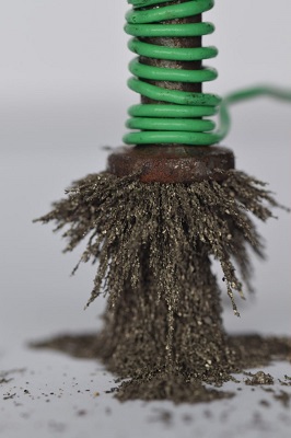

The answer to this mystery is to consider the load device, in this case, the contact set or the plunger. This object is made out of ferrous metal, containing iron. It is not a permanent magnet. A permanent magnet contains a predetermined north and south pole, often labeled on the magnet itself, like a compass dial.
Figure 2. In a classic science project example, a nail is wrapped with a wire and DC voltage is applied. The nail will attract iron filings to demonstrate the creation of an electromagnetic coil. Image used courtesy of Canva
This ferrous metal in the moving component is not locked in place—the polarity aligns when the magnetic field is energized. The moment that happens, the ferrous elements align themselves to be in attraction to the field, no matter which pole of the energizing field presents itself.
In this way, the switch contacts or plunger will be attracted against the spring force when the magnetic field is applied, no matter the polarity.

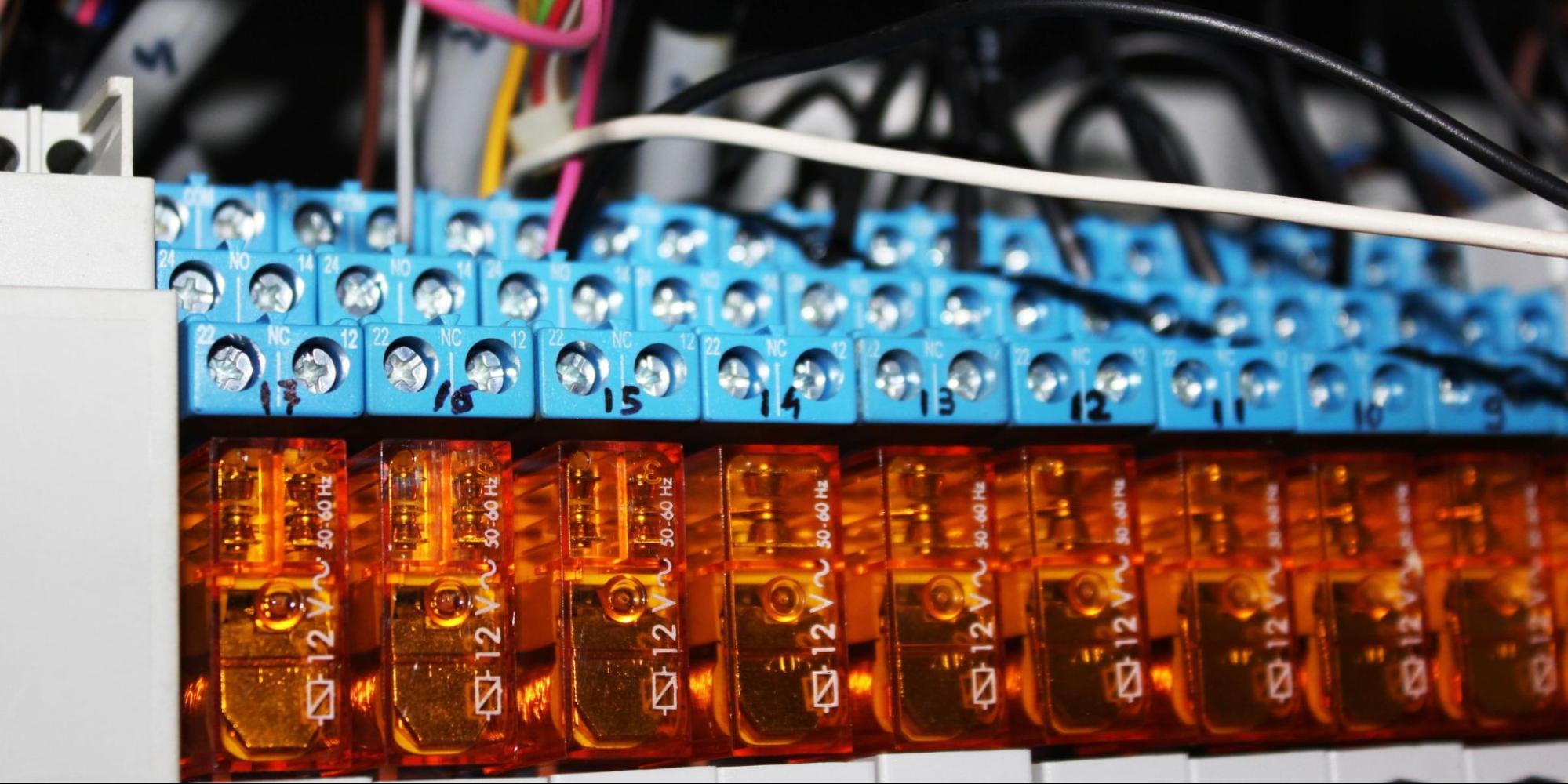

Figure 3. Industrial AC relays can be energized with 12 (shown above), 24, 120, or 220 volts AC, depending on the model. Even contactors with AC coils follow the same physical operation. Image used courtesy of Canva
So how does the AC coil work to prevent the rapid chattering of the opening/closing contacts as the voltage crosses zero every half-cycle?
Phase Shifting in AC Inductive Circuits
In many AC devices, the primary coil provides the holding force necessary to move the contact set or plunger. A portion of the coil is designed with a shielding ring of copper, usually around the edge of the coil. This is referred to as ‘shading’ a portion of the coil, just like shade would block light and heat energy.
The result of this ‘shading’ on the coil is a slight phase shift of just a portion of the magnetic field from the inductor. The timing offset ensures that the magnetic field, caused by the current, never drops away entirely, thus preventing noise and chatter from the contact or plunger.
