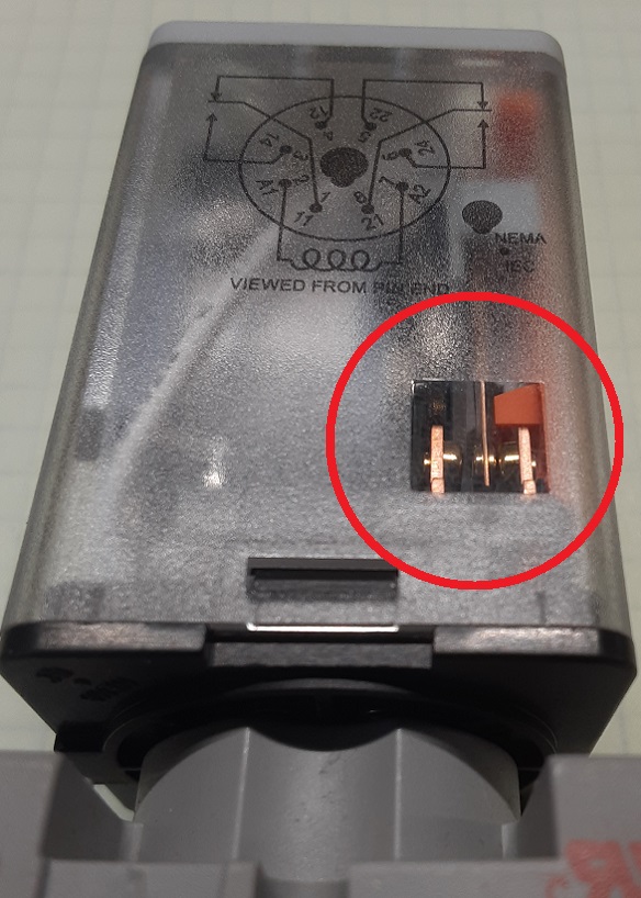

The DPDT contact of a relay with its no and nc contacts
Figure 2. The open and closed contacts of a double-throw relay can be seen through the small viewing window. Image used courtesy of the author

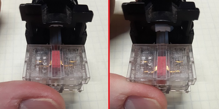

N.C. contacts inside a transparent switch contact
Figure 3. A normally closed (N/C) switch contact is seen not pressed (closed) on the left, and pressed (open) on the right. Image used courtesy of the author

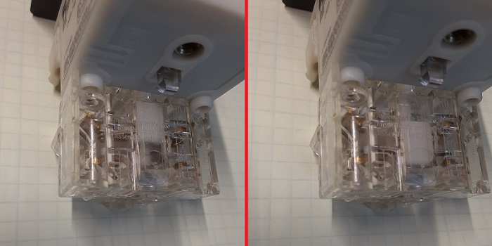

Switch with both n.o. and n.c. (n.o. n.c.) contacts inside a single block
Figure 4. This button is equipped with a double-pole contact, with de-energized on the right and energized on the left. We can see that the top contact is NC, and the bottom contact is NO. Image used courtesy of the author
