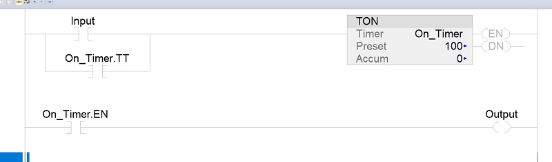

If no such command exists, a short combination of two timers can be utilized in a variety of ways. Many examples are found across the internet, but there is one caution when ladder logic is involved.
Many examples use a timer and energize the output at the end of the very short timer duration. This means you press the button, and then have a very short delay before energizing the output. Other methods involve energizing the output at the first moment of contact, then maintaining that status until the input is de-energized. The example below illustrates a debounce for a positive-going signal. For a negative-going signal, a short TOF (off-delay) timer can be used.
Debounce timer used in a PLC ladder logic program rung
Figure 4. Software using a timer to achieve a positive-going debounce.
