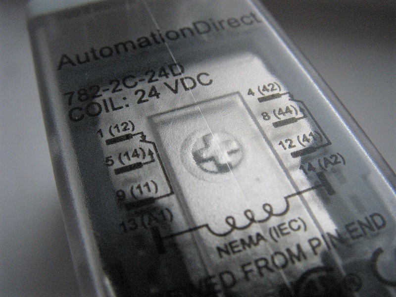

1-5-9 for the first contact set, and 4-8-12 for the second contact set, then 13-14 for the coil.
Comparing these to the larger common double-pole relay, the 4PDT, we would also find all of the mysterious missing numbers in between those on the double-pole model.
For this relay with four contact sets, 1-4 indicate the normally closed (N.C.) terminals. 5-8 indicate the normally open (N.O.) terminals. Finally, 9-12 are the common leg terminals to supply voltage on a dry contact.
Terminals 13 and 14 indicate the coil in the NEMA convention.
As an example, suppose you needed to connect a circuit to an N.O. set of contacts. You should expect to use terminals 5 and 9, or alternatively, 8 and 12.
DPDT relay with dual NEMA and IEC numbers
For an N.C. connection, the choice would be 1 and 9, or perhaps 4 and 12.

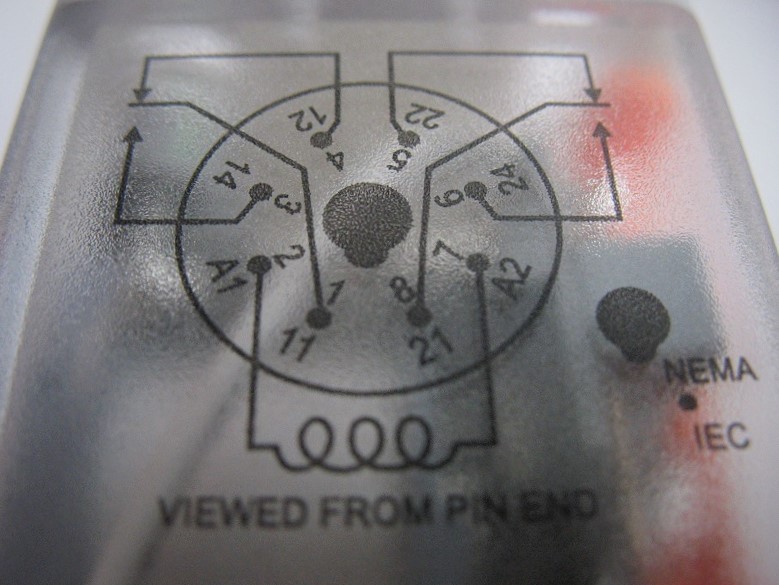

A slight variation occurs in the NEMA convention for the circular keyed base with 8 pins. For these relays, the numbers 1-8 orbit the base. Pins 2-7 connect to the coil, with 1, 3, and 4 being the first set of contacts (common, N.O., and N.C. in that order) and the second set being 8, 6, and 5 (common, N.O., and N.C. in that order).
Octal relay with NEMA and IEC numbers

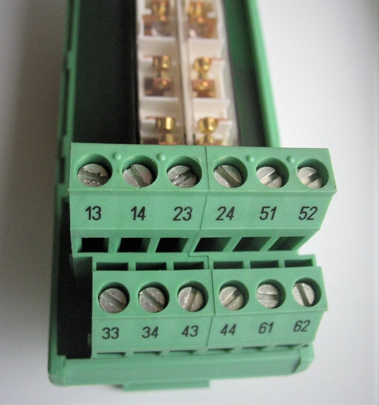

6PST Relay with integrated terminal blocks showing IEC numbers
In the case of this 6PST relay shown below, the first number clearly indicates the contact set - 1 through 6.
The top left terminals are 13 and 14, and if we look at the breakdown of the terminals in the previous section, 3 and 4 indicate an N.O. set. Therefore, contact set 1 is an N.O. set.
This appears to be the case as well for contact sets 2, 3, and 4.
However, contact sets 5 and 6 consist of 51 and 52, as well as 61 and 62. Referencing the previous breakdown again, these would appear to be N.C. sets.
A closer look at the picture will indeed verify 4 sets of N.O. contacts, and 2 sets of N.C. contacts.
