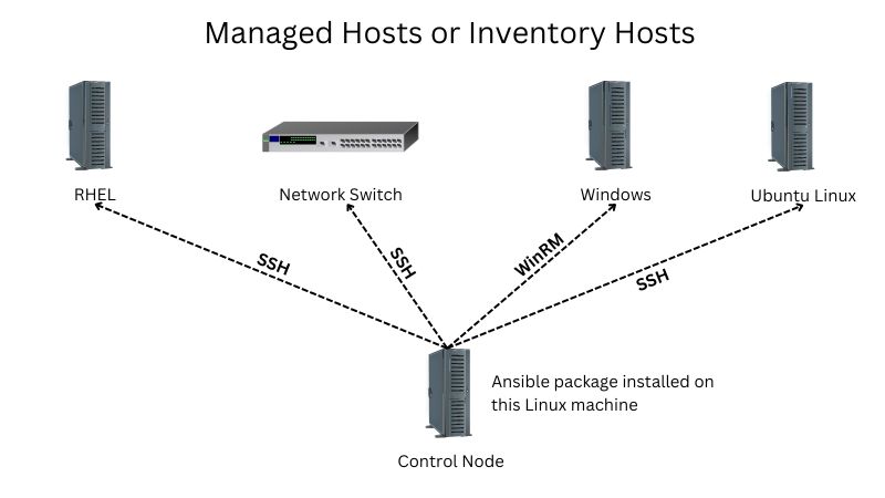

Infrastructure of host network
Figure 1. The Ansible core package is installed on the Control Node which can manage inventory hosts comprised of servers and network switches.
The major strength of Ansible is cross-platform support which supports Linux, Windows, and virtual and physical cloud environments. We can manage different hosts (RHEL, Ubuntu, and Windows) with a single playbook.

The Ansible core package can be installed on any Linux machine, but it can not be installed on Windows because of its Python dependency. Ansible is agentless, which means that there is no need to install any extra or additional software on the managed hosts. Ansible usually connects to the managed hosts using Open SSH (Linux hosts) and winRM therefore, Ansible is more secure and efficient than other alternatives.

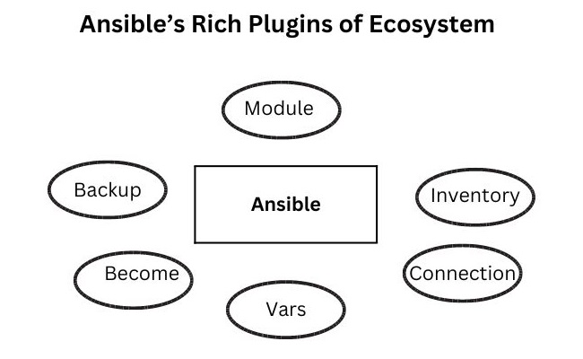

Ansible Plugins
There are numerous plugins built for Ansible, with one of the key plugins being the module which is the actual worker that performs the task. Ansible playbook is a YAML file. YAML is easy to read and understand and it is often used to write configuration files. The Ansible playbook has a list of plays or a single play. Interestingly, YAML originally stood for “Yet Another Markup Language” as it was developed in the era of other languages like HTML and XML, but is simpler as far as syntax is concerned.
Ansible plugins
Figure 2. The Ansible software consists of multiple rich plugins
Having more than one ‘play’ means targeting a different set of inventory hosts. Each play has tasks, and tasks are the real workers such as copying a file, updating the software, and installing packages on the remote devices.
Inventory Plugin
We can manage hosts into different kinds of inventories. An inventory can be defined statically in the text file or dynamically obtained from external sources.
Connection Plugin
This plugin is used to connect to the managed hosts. This plugin defines how the Ansible controller connects the managed hosts. For Linux systems, we can use SSH plugins for remote connection, and for Windows systems, WinRm plugins are used.
Become Plugin
How do you connect the managed hosts, whether as a normal user or as a root/Administrator user, in order to install the software and start/stop the essential services? These Become plugins allow Ansible to act with certain user privileges (like sudo) to ‘become’ that user in order to accomplish some tasks.

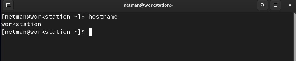

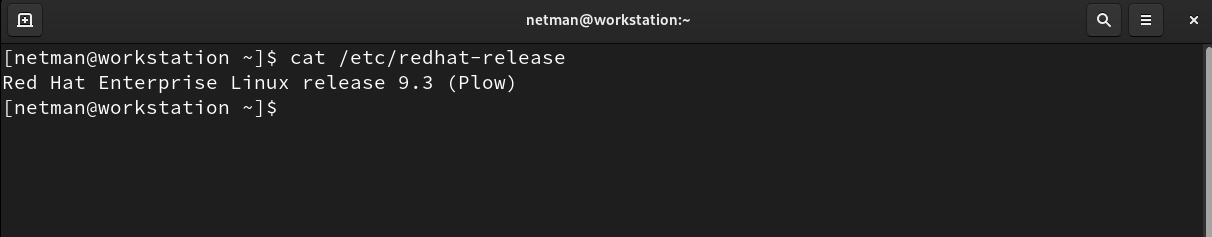

  2. The easy way to find the hostname and OS version of all aforementioned 3 machines is by using the command ‘hostname’ and by reading the content of the file “redhat-release” under the ‘/etc’ directory.
    Identifying workstation name
    Verifying version

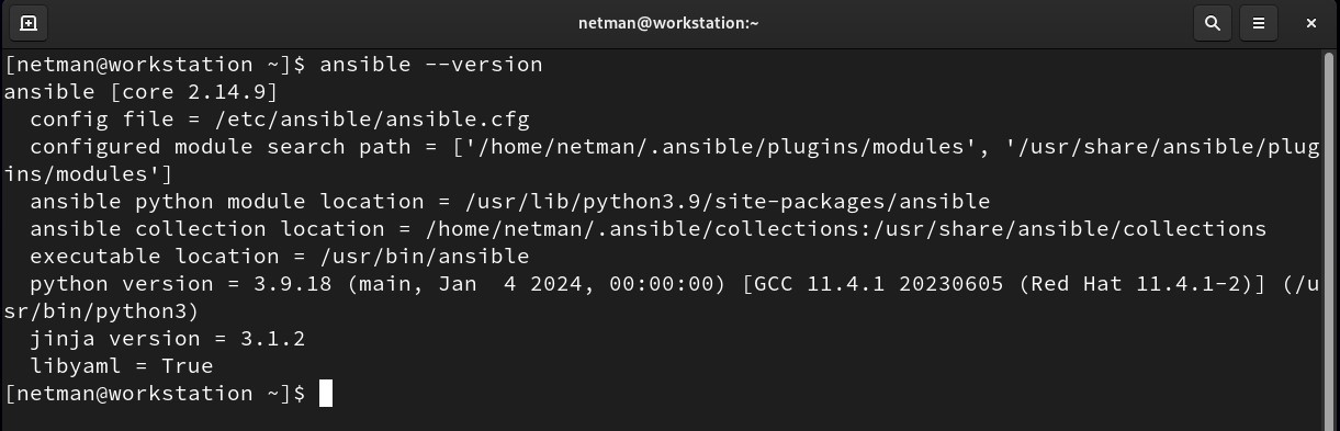

  3. The Ansible core package version 2.14 is installed on the control node ‘workstation’ and the command ‘Ansible --version’ is used to find the Ansible package version.
    Checking Ansible version

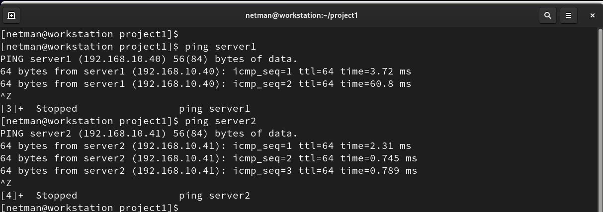

  4. Ping both servers to check the communication between the control node and inventory hosts.
    Pinging servers for communication

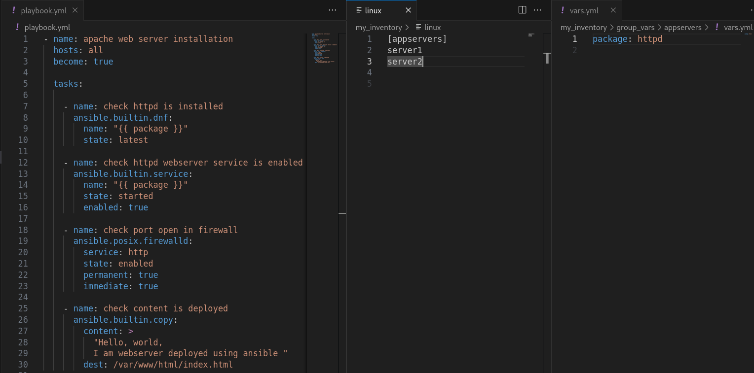

  5. The project directory hierarchy contains the necessary files to run a playbook.
    • playbook.yml: tasks are written to install httpd webserver software on managed hosts, i.e. server1 and server2.
    • Ansible.cfg
    • group_vars/appservers/var.yml: file to define variables related to specific group
    • host_vars/server1/vars.yml and server2/vars.yml: define variables for each individual server.
    • linux: inventory file
    YAML project scope
    Figure 3. The project directory contains the inventory file, playbook.yml, and group_vars, and to define variables
  6. As shown in Figure 3, the playbook.yml code first checks that httpd is installed to the latest version, then it enables the httpd service and deploys the content to the index.html file.

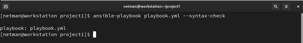

  7. Check for any syntax error before executing the playbook, use the following command: ‘Ansible-playbook playbook.yml --syntax-check’
    Syntax error check

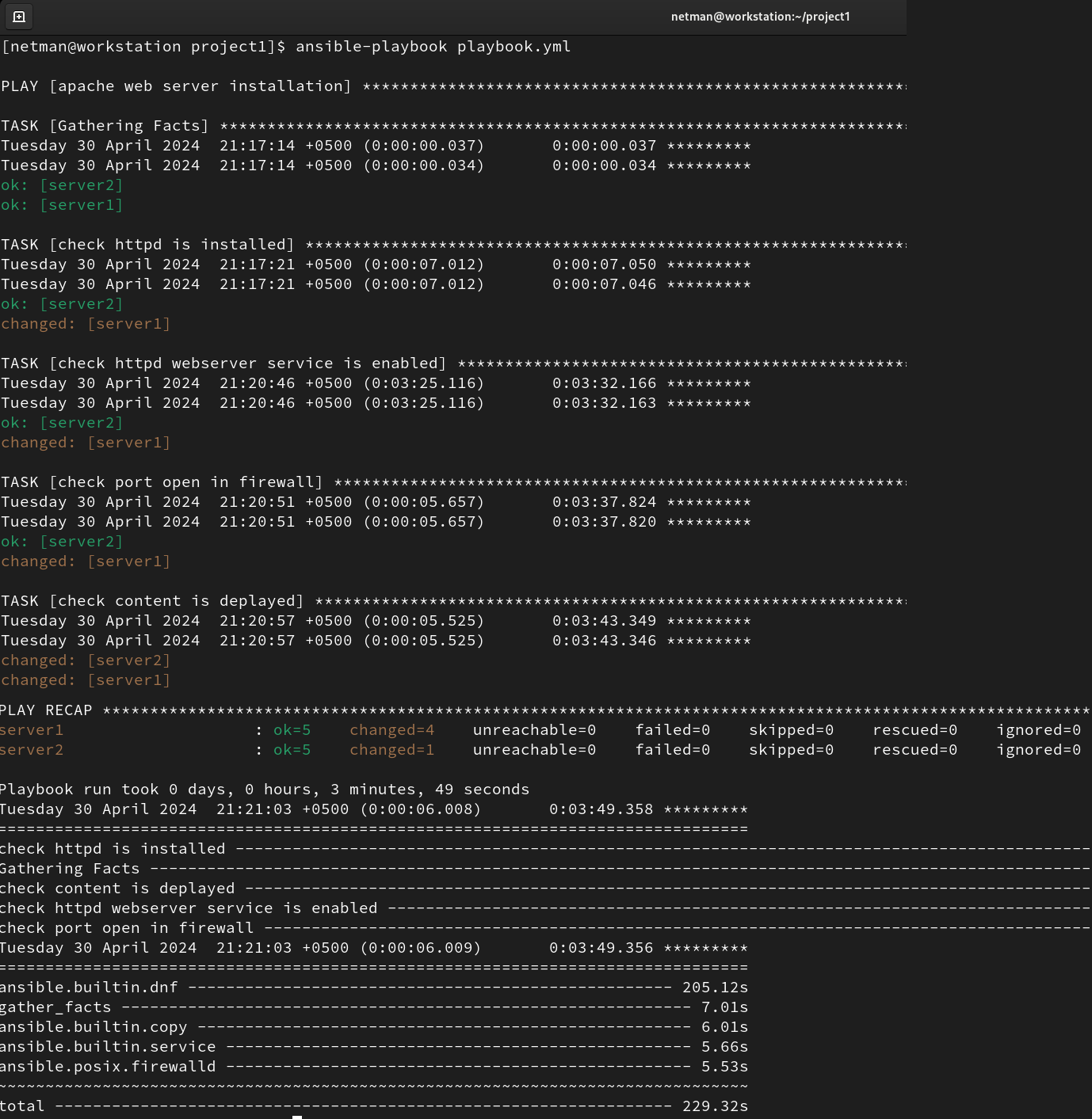

  8. If no error is found, then execute the Ansible playbook which is going to install the httpd software package on the managed hosts. The Ansible executes the tasks step by step as shown below:
    Project execution steps and progress

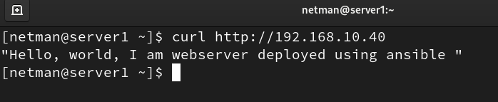

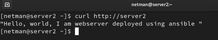

  9. Now let's check that the changes have been made successfully on the managed hosts. The following snaps confirm that the httpd package has been installed on each server and that the content has been successfully written to the file.
    Server 1 check
    Server 2 check
