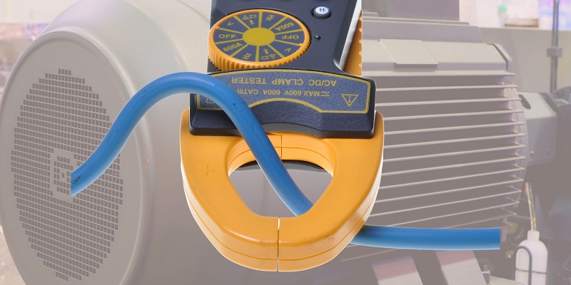

Motor current monitoring is a common practice. Using either handheld clamp meters or fixed power level and quality analyzers, it is generally well-known to most engineers and technicians that motors will consume more current at startup.
This phenomenon is no minor difference. It can sometimes be as much as 10x to 20x higher current consumed for a brief moment while the motor is gaining speed.
current is measured with clamp meters and motors display high startup current
Figure 1. Current is measured with clamp meters, and motors display very high startup current.

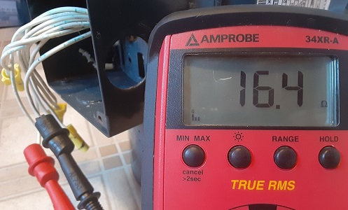

Here, I have a motor wired for a three-phase 480 V input, with 16.5 Ω of resistance measured between T leads. The FLA (amps) rating for this ¾ HP motor is 1.5 A at 480 V. This equates to a total impedance of 320 Ω, substantially more than the 16.5 Ω of resistance of the coils alone.
This extra resistance is due to the inductive reactance of the motor, both from the stator and the rotor.
How do we know this? If the impedance were due to the stator’s windings and poles alone, there would be no difference between a stopped versus running motor. As the motor picks up speed, the resistance (and reactance) increases so that the current inversely decreases.
measured resistance of motor windings between T-leads configured for 480 volts
Figure 3. Measured resistance of motor windings between T-leads, configured for 480 V.

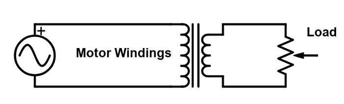

When the motor runs at full speed, a load is placed on the inductor, causing it to expend energy to reverse the polarity in the laminated layers of the rotor core. In other words, it must consume far more energy to both rotate the shaft and polarize the metal at the same time.
The loading effect can also be demonstrated with a small DC motor: rotate the shaft while keeping the lead wires disconnected (no load), and it will spin easily. Connect a light bulb or resistor across the leads, and spinning the shaft becomes more difficult. When a magnetic field generates energy to be converted into light, heat, or motion, it causes tremendous resistance.
In an induction motor, this back EMF (electro-motive force, or voltage) provides enough resistance to drop the current from an incredibly high startup value to the nominal ‘full load’ amps at full speed.
Another common analogy is observing the effect of a transformer under no-load and full-load conditions. When no load is connected, little effort is needed to polarize the iron core, and the supply current will be high. When a variable load is connected and slowly increased, the load current drops, and so does the supply current.
transformer analogy of motor loading effects
Figure 4. Transformer analogy of motor loading effects.

    Motor inrush is a function of motor design not load.  A motor is a transformer and at start-up it is a transformer with a shorted secondary.  In other words, a short circuit; hence high inrush.  The inrush is the same whether the motor is loaded or unloaded, although the duration may be different.  As the inductor sees current flow it magnetizes the stator and becomes a “choke” which limits the current.
