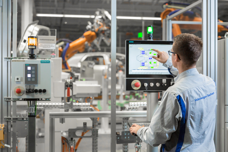

In the broadest definition, an HMI, or human-machine interface, is a hardware device that runs software, making it possible for humans to interact with a machine. In the automation and industrial contexts, an HMI is typically seen as a locally integrated peripheral that communicates with a machine’s controller, provides visualizations, and allows some equipment manipulations.
Figure 1. A robot station HMI from Siemens. Image used courtesy of Siemens
HMIs are ubiquitous in large and highly automated new systems. Due to the large amounts of components present and data processed, operating these systems would be extremely inefficient if an HMI were not present. On the other hand, it is a reality that there are many long-running control systems out in the field that are not yet equipped with any form of HMI.

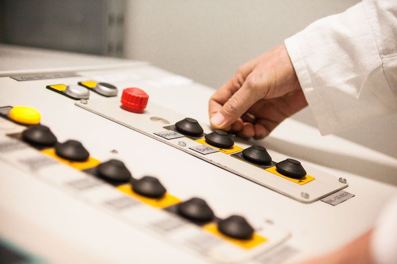

Before HMIs: Push Buttons and Indicator Lights
In the past, justifying the incorporation of an HMI into a system was far more difficult than today. The reason was the relatively high cost of the device versus the perceived benefits the technology offered then. Automated systems were also simpler.
Back then, operators depended on indicator lights and push buttons to work with machines. Indicator lights would show the status of the machine or device, while push buttons would send limited commands: manual vs. automatic mode, clear errors, start function, etc. The total cost of these components, including the wiring, was far below that of an HMI.
Figure 2. A panel with push buttons and lights used in a control system.
Far from obsolete, these status indicators are still widely used today together with HMIs, even in large automated systems. They often exist as compact panels mounted in areas closest to where operators are likely to be situated. The idea is they function as satellite interface points with immediate access to basic status information and inputs.
