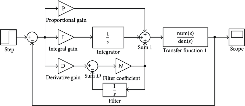

The structure of a typical control system with a PID controller. Image courtesy of Jun-jie Xue et al.

The diagram shows a PID with all the gains acting on the error. This introduces zeros into the closed loop transfer function which will result in overshoot. Some controllers have an option for the derivative gain to act only on the changes in the PV or feedback. I call this a PI-D. If the proportional gain also acts on the feed back there will be no zeros. I call this I-PD. Bandwidth is reduced but there are not zeros that cause overshoot. Another advantage is that since all three gains are integrating. The integrator is integrating errors. The proportional term is integrating changes in the PV and the derivative gain is integrating changes in the rate of change in PV.
