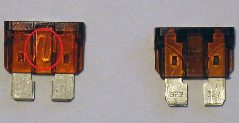

Good fuse and blown fuse cartdridge fuses
Figure 1. On the left is a good fuse, and on the right is a blown fuse. These cartridge fuses are commonly used in automobiles.  Original image used courtesy of Wikipedia, modified by the author
In Figure 1, notice the curved wire inside the good fuse (inside the red circle) that is missing from the bad fuse. Sometimes, the process of blowing the fuse will discolor the container, due to heat, vapor deposition of the wire, and so on.
Blown fuses should only be replaced with an equal-valued fuse. If a 15 A fuse is required, it should not be replaced with a 20 A fuse to prevent it from blowing. Many fires have been started by unsafe technicians replacing a fuse with a nail, coin, or higher-valued fuse.

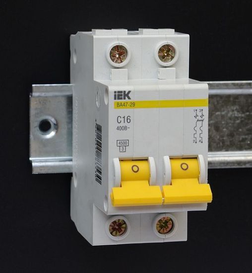

stand-alone circuit breakers mounted on a DIN rail
Figure 2. Stand-alone circuit breakers mounted on a DIN rail. This circuit breaker could be used to protect controllers mounted on the rail from a high current spike due to a short circuit, for example. Image used courtesy of Wikipedia
Circuit breakers, such as the one seen in Figure 2, are often mounted in a panel box such that groups of breakers are located together. Others are stand-alone devices that can be mounted near industrial equipment. Some circuit breakers are equipped with mounting equipment for lock out tag out (LOTO) locks and tags. In this case, the circuit breaker is set to the “OFF” position and the lock placed through a set of holes to keep the breaker from being reset to “ON”.
One advantage of circuit breakers over fuses is that they can be reset. By pushing the lever back into place, the circuit breaker makes contact again, and current can flow. For troubleshooting purposes, this is extremely convenient, as the circuit breaker can cycle many times before needing replacement. This means a circuit can be investigated and can trip the breaker over and over again without the need for replacement. Fuses are good for one use and must be replaced.
Circuit breakers are mechanical devices with moving parts. As springs age, they may not move the lever and break the circuit completely, or may not keep the wire far enough away from the contact to prevent it from arcing. Periodically, circuit breakers should be tested to ensure that they still function as designed. Replacing a circuit breaker is more difficult than replacing a fuse and may require the assistance of a licensed electrician.
