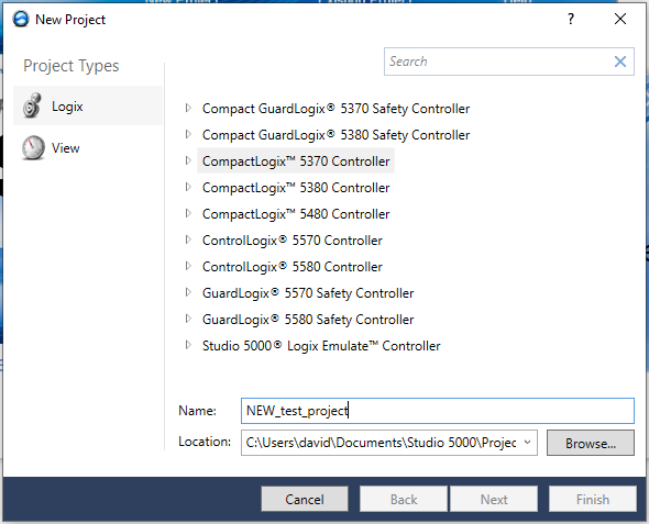

We’ll begin with a new project. When we choose this option, we’re represented with a list of compatible controllers. Some versions of Studio 5000 will be compatible only with certain controllers. This version happens to be Studio 5000 Lite, which is compatible with the CompactLogix line of controllers.
CompactLogix 5370 Controller
I will use my personal PLC of choice, the L16 with Ethernet and embedded I/O terminals for easy configuration.

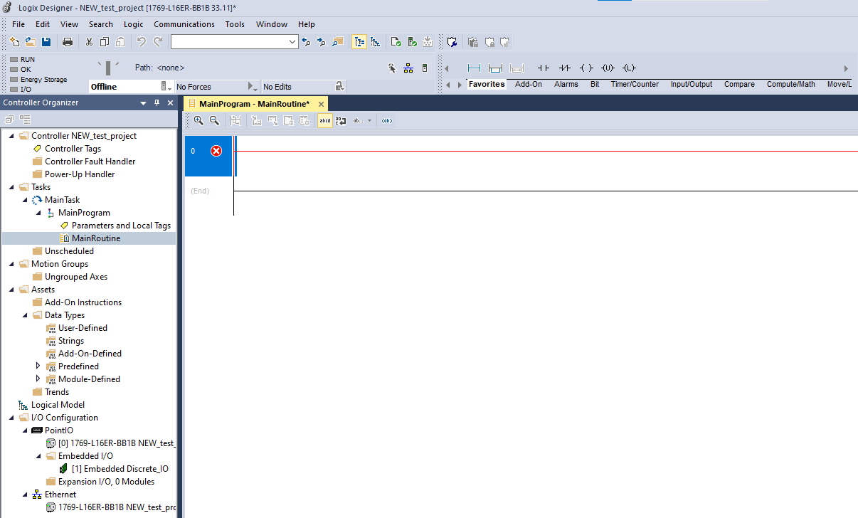

Once inside the newly-created project, we can begin to build a new program, specifically, inside a ladder diagram (LD) routine.
In the project view, a new Main task will contain a Main program, with a Main routine. Open this Main routine to access the ladder logic.
