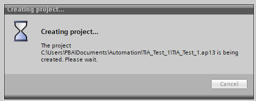

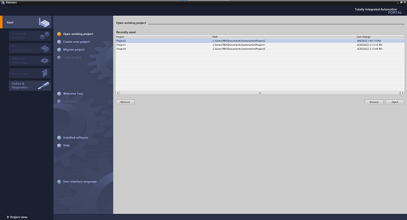

When the software is first opened, the Portal View will be visible, as shown in Figure 1. 'Create new project' will allow us to give a name and optional comments to our new project, which we’ll call TIA_Test_1 for simplicity.
Creating a new project in Siemens TIA Portal

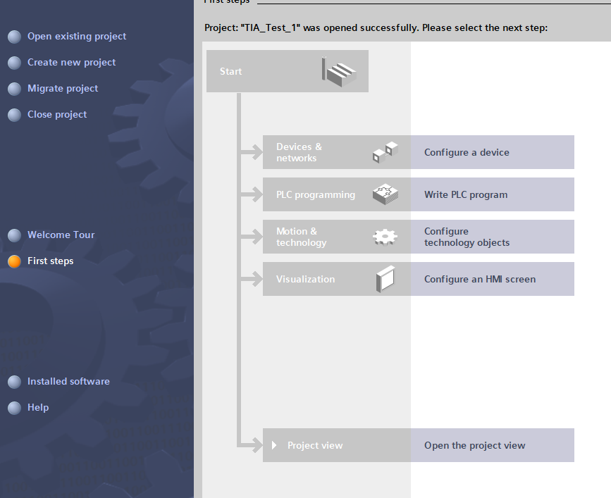

We are presented with some recommended first steps. The first step should usually be to configure the hardware and establish the proper modules, communication parameters, etc. This way, we should not meet unexpected challenges when we create tags or instructions that somehow are unsupported by the hardware we have not yet specified. Therefore, I prefer to always select the right hardware before programming.
On this next screen, that means ‘Configure a device’.

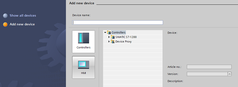

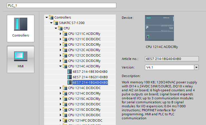

Since this is a new project and we have not yet connected to any controller, we’ll want to 'Add new device', and choose the right controller from the list.
Adding controller to TIA Portal

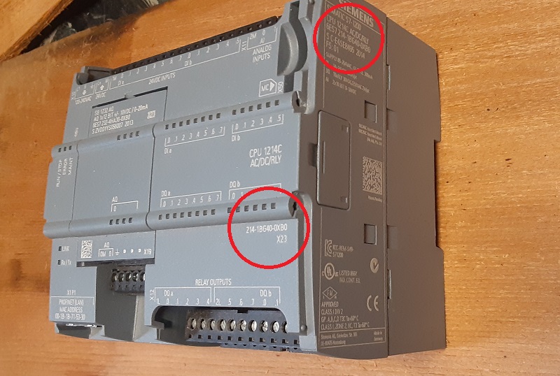

As specified earlier, this is a 1214 AC/DC/Relay model, and it has a specific part number visible on the front. I have removed the protective cover flaps for the I/O terminals, but you may need to fully open the lower flap to reveal the part number.
It’s also visible on the side, but that’s not as helpful when it’s mounted to a trainer or control cabinet with modules and devices on the DIN rail adjacent.
PLC part number
connecting plc with TIA Portal
It should be noted that the ‘Version’ selection is important at this stage, otherwise, there may be a mismatch between the project version and the current version loaded in the existing hardware.

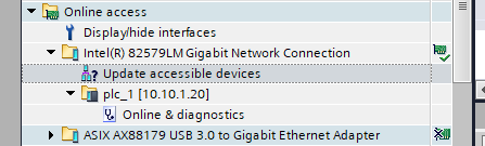

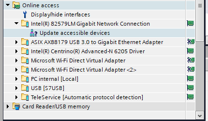

From the bottom of the main screen, we can go directly to ‘Project view’. On the far left side of this view, the entire project tree is visible, including both the added devices as well as the 'Online access' to see any available devices. Find your correct network adapter and ‘Update accessible devices’ as shown below.
correct network adapter and update accessible devices
With my previously unknown PLC connected via an Ethernet cable, I can see this new device has just appeared.

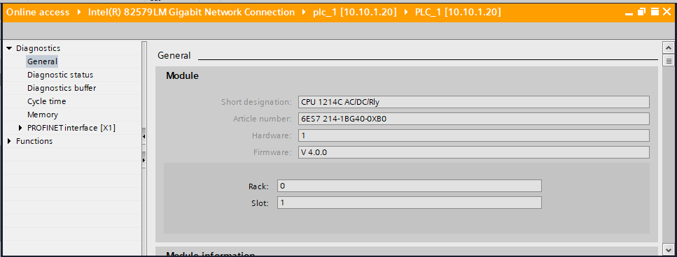

Online & Diagnostics Menu
Now click on ‘Online & diagnostics’ where we can see a bit more than just the IP address; this will be useful in setting up our new project.
I set my computer’s network adapter to the proper subnet, with a 10.10.1.x configuration, refresh the devices, and now:
et my computer’s network adapter to the proper subnet, with a 10.10.1.x configuration and then refresh the devices
This is a version 4.0 device—good to know when setting up the device, a step which I can now accomplish.

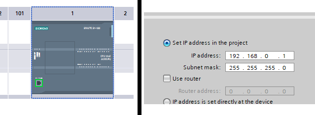

With the CPU and version chosen, added to the project, and automatically shifted to project view, all I need to do is set the target IP address. The Device view window has an image of the PLC with the network connector outlined in green. Selecting this connector allows you to enter the target address below.
I see the default address shown below, so I’ll change it to my newly-discovered 10.10.1.20 address.
default address shown below, change to newly-discovered 10.10.1.20 address

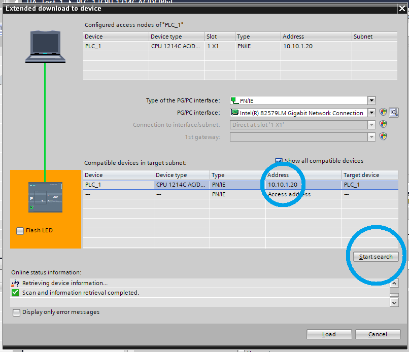

Now, I will download this entire project to the device.
download the entire project to the device
The online access window will open, allowing you to search the network and select the correct PLC. In this network, there is only one of them, so I expect the IP address to match the target, which it does. If you have a large network with many devices, you’ll need to be sure and choose the right one.
choose the right device

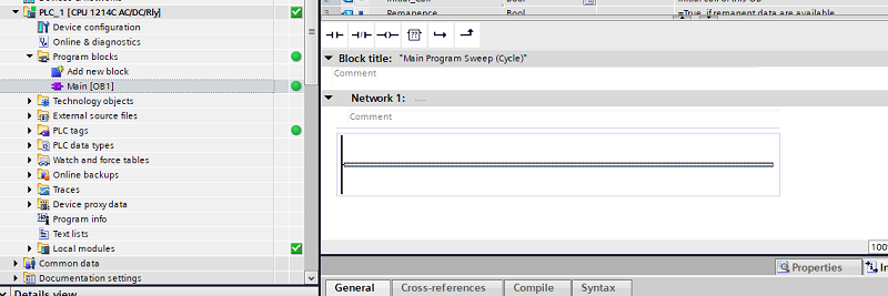

The Main OB1 (object block) is where the ladder networks are stored. This is accessed from the project tree on the left sidebar.
access ladder networks from project tree on left sidebar

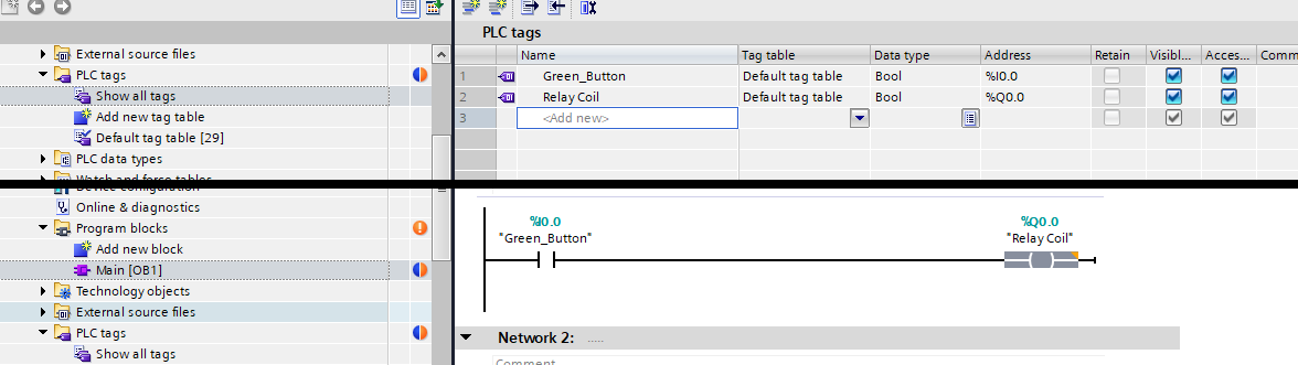

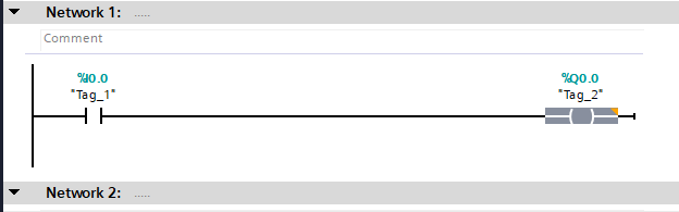

In typical fashion, drag down a single N.O. contact instruction and a single momentary output coil.
To reference the built-in I/O terminals, the syntax is %I0.x (such as %I0.0 in this example) for the inputs and %Q0.x for the outputs.
To reference the built-in I/O terminals, the syntax is %I0.x for the inputs and %Q0.x for the outputs
Alternatively, and probably a much better practice, is to use the PLC tag table to provide logical names to all I/O devices, and then use those in the ladder networks. I have done this using a green button and a relay as examples.
use the PLC tag table to provide logical names to all I/O devices and then use those in the ladder networks
You may now, once again, download to the device and the new project will be loaded quickly since the connection was already established.
