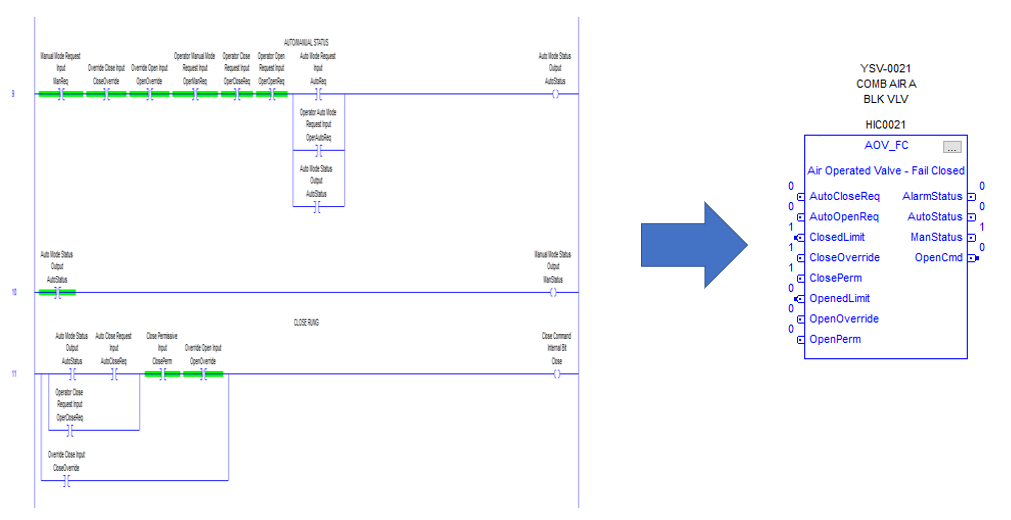

Figure 1. More complex code, such as this ladder logic routine on the left, runs inside a simplified AOI structure.

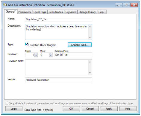

There are four main parts that need to be configured, with several, optional, steps that can be completed to enhance and polish the AOI. The first step in creating an AOI definition is naming the AOI and choosing which type of PLC programming language the AOI will be written in.
The AOI can be one of three types: Ladder diagram, function block, or structured text. This first step is configured under the General tab in the instruction's definition as shown below. Optional information such as description, revision, revision notes, and vendor are also part of the configuration under this tab.

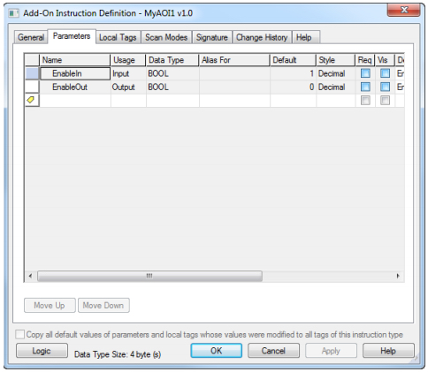

The second part that needs to be configured when creating an AOI is the external parameters that will pass from/to the AOI. These are configured on the Parameters tab as shown below.
Here you will define the input and output parameters name, data type, and default value. This step does not necessarily have to be done before creating the logic, as you will have the opportunity to create the parameters as you create the logic, but it can be beneficial to do so before creating the logic.

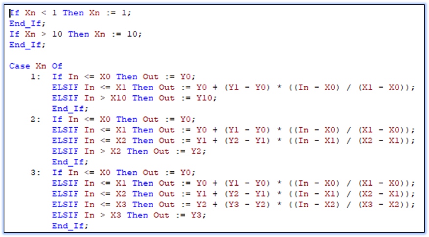

Figure 4. The logic inside an AOI can be ladder, function block, or structure text as in the example above.

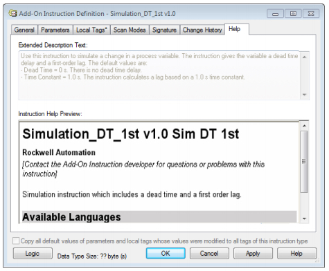

The AOI has built-in documentation or a help feature that is optional, but highly recommended feature to take advantage of. The designer of the AOI can document the instruction for later recall by the user of the instruction. The help configuration is fairly free form and allows the designer a standard text editor to display the help of the instructions. The Help configuration tab can be seen in the picture below.
Figure 5. Add-on Instruction help configuration tab allows the creator of the AOI to leave detailed documentation for future users. Image courtesy of Rockwell Automation
