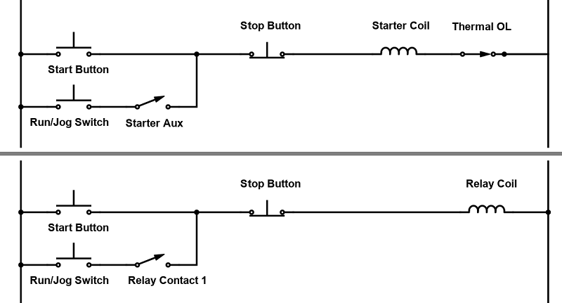

Run/Jog Toggle
The jogging function of a machine is commonly used to set a position, or perhaps reverse a motor a short distance to clear a jam or reach a certain potion before beginning a cycle. In some cases, jogging can bypass certain safety considerations, and for that reason, jogging is considered a movement action (usually at a lower speed) that must be momentary. In other words, for movement to occur, the start button must be pressed and held. Releasing the start button should also stop the motor.
To construct this circuit, any of the basic circuits may be used for single-direction or reversing. A second quarter-turn switch is used in series with the auxiliary contact branch. The quarter-turn switch can either allow the auxiliary contact to latch the circuit, providing our original start/stop control. Or, it can disable the latch so that the start button MUST be held to continue motion.
This schematic shows the Run/Jog Toggle switch placed in series with the latching auxiliary contact.
Figure 2. This schematic shows the Run/Jog Toggle switch placed in series with the latching auxiliary contact. In the lower image, a relay coil and contact set may be used in exactly the same configuration.

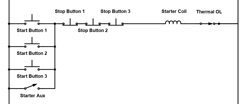

Multiple On/Off Controls
Sometimes there are multiple operator stations that must be able to start and stop the motor. Series and parallel connections are useful, but care must be taken for those devices which are normally open (NO) or closed (NC). To allow multiple start controls, which are NO, they must be in parallel branches just like the auxiliary latching contact. Any NC Stop controls must be in series, preventing the flow by pressing any of those stop buttons.
Multiple operator stations can be wired in parallel for all NO Start controls, and series for any NC Stop controls, just like any standard E-Stop circuit.
Figure 3. Multiple operator stations can be wired in parallel for all NO Start controls, and series for any NC Stop controls, just like any standard E-Stop circuit.

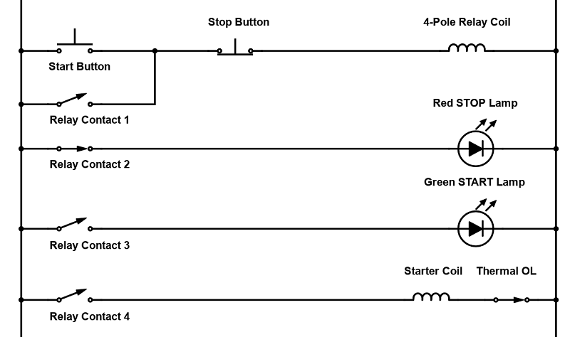

Adding Indicators
Many pushbuttons are illuminated, which means they have a light bulb or LED inside to indicate whether the control is active or not. For start/stop circuits, the start button will be illuminated when the motor is running, and the stop button lights up when the motor is stopped. This can also help with troubleshooting, showing the operator that the control voltage is responding, so any motor problems must be located in the power circuit.
This circuit must use a multi-pole relay since four responses must be taken:
  1. Start/stop latching
  2. Start button light
  3. Stop button light
  4. Starter coil
Alternatively, if the starter has two NO aux contacts, and one NC aux contact, the relay can be omitted. In the diagram, simply replace the relay coil with the starter coil and use aux contacts instead of relay contacts. Now the entire fourth line may be omitted.
Indicator lights can show whether the coil is energized or not. These might be stack lights rather than illuminated buttons.
Figure 5. Indicator lights can show whether the coil is energized or not. These might be stack lights rather than illuminated buttons.

    coolerro January 30, 2023
    in fig.2,3,4,5 the contact for the “thermal OL” should be NC ...?
    Like. Reply
    • D
      David Peterson January 31, 2023
      Thanks for pointing that out. The original figures were illustrating generic OL contacts, but yes, N.C. would have been correct for that device. They've been updated.
