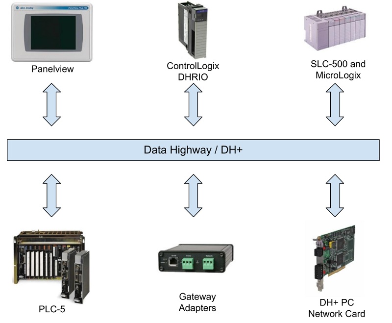

Data Highway was developed by Allen Bradley in the late 1970s as a proprietary network bus used to connect PLCs, remote IO systems, PCs, and HMls. There is a broad range of controllers and hardware devices that can be integrated into a DH network, including PLC5 Processor, PLC3 Processor, Windows PC, ControlLogix PLC, PanelView HMI. DH networks are robust and capable. Let's dig into DH networks and learn the basic rundown of their operation.
DH Network to connect various devices
Figure 1. Many different types of devices can be connected across a Data Highway network.

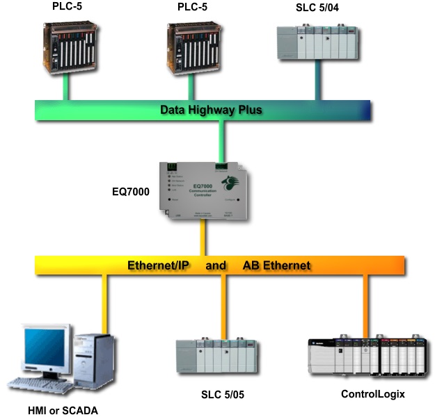

DH to Ethernet adapter network
Figure 2. An EQ7000 device bridges Data Highway and Ethernet networks. Image used courtesy of Equustek
Data Highway Plus (DH+), which is most prevalent, still has its place as a closed communication system and you are likely to see them if you work on facilities that were designed before the advent of more advanced standardized networks. In some scenarios, its advantages over the more complex ethernet networks can prove to be valuable in a multitude of ways.
To provide the contrasting perspective, Ethernet certainly has some distinct advantages over DH and other legacy protocols due to its universal adoption. It is difficult to find modern control equipment that is incompatible with an Ethernet system. Therefore, in order to interface with these older pieces of equipment, a variety of network adapters, or gateways (sometimes called bridges), must be used. An example of such a network is shown above in Figure 2. With the understanding of this compatibility challenge between modern and legacy protocols, many equipment manufacturers will provide a whole variety of I/O and network ports onto a single device, allowing the user to integrate it into nearly any network.
