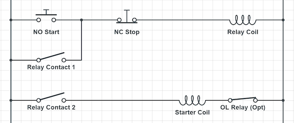

If the motor has no auxiliary contact and no option for installing one, then the circuit must be slightly adjusted.
You must have access to a double-pole relay with either double throw or both normally open contact sets.
Use the relay in the exact replacement of the contactor in the previous circuit. The green and red buttons energize the relay, with one of the relay contacts in parallel with the green button.
The second relay contact will be driving the contactor, which no longer needs the auxiliary contact installed.
A motor start-stop circuit connected to a relay for high-voltage control
Figure 3. Without an auxiliary contact on the starter, a relay must be used to provide the latching control. This method also works well for high-voltage motor starter coils.

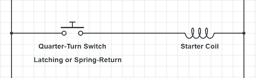

In even more simple applications, a quarter-turn switch may even be sufficient. A retentive switch can produce a run/stop function, and if the switch is a spring-return to center, the control will appear as a JOG function. Either one might be useful in some situations.
A simple quarter-turn switch can energize the starter coil if start/stop buttons are not desired.
Figure 4. A simple quarter-turn switch can energize the starter coil if start/stop buttons are not desired.

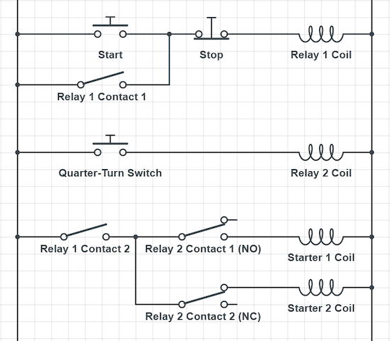

The concept of three-phase electricity allows you to simply interchange two of the three-phase lines into the motor. This can be accomplished using a pair of contactors or a special interlinking set of contactors, appropriately called a ‘reversing contactor.’
Although this circuit uses two contactors, it is critical that they can NEVER be energized at the same time. And if they do, by some odd chance, they should be mechanically restricted from both closing simultaneously.
In this circuit, two DPDT relays will be needed—one for the on/off control and the other to control the direction. In application, the directional control will be toggling back and forth between the starter coils.
The two relays will be energized in the same manner as the previous two circuits. Relay 1 will provide the latching ability and allow power to reach either starter coil. If this first relay is OFF, then both starters will be disabled.
The second relay is energized by a latching quarter-turn switch. When de-energized, Relay 2 will allow only Starter 2 to energize. When energized, Relay 2 will allow only Starter 1 to energize.
By this arrangement, only three combinations are possible:
  • Both starters OFF
  • Starter 1 only
  • Starter 2 only
There is no operation of the circuit in which both starters may be energized.
With two relays and two interlocked starters, a simple reversing circuit may be constructed.
Figure 5. With two relays and two interlocked starters, a simple reversing circuit may be constructed.

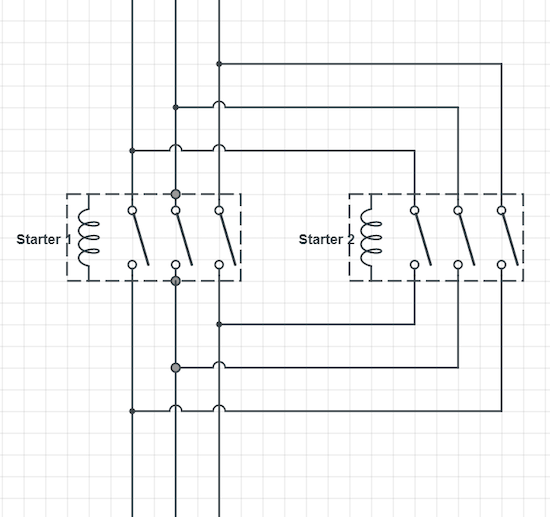

Using two starters to reverse direction is simple, but the arrangement can be confusing.
An example schematic is shown below. The three incoming phase lines connect to each of the input terminals of both starters. Read carefully.
  • On the output side of the starters, the first pole of the first starter is connected to the third pole of the second starter.
  • The second pole of both is connected.
  • Finally, the third pole of the first starter is connected to the first pole of the second starter.
Reversing motor (FVR) contactor with two phase lines reversed.
Figure 6. The arrangement of the phase lines for a reversing motor starter. The two starter coils are part of the control circuit shown before.
As you can see, if both starters were to energize at the same time, phases one through three would be shorted together and cause circuit failure. Be sure that both starters cannot energize at the same time.
Any two of the three-phase lines can be reversed in this manner. If you mix up all three lines, there will be no reversal of direction—only the potential danger of short-circuiting.
