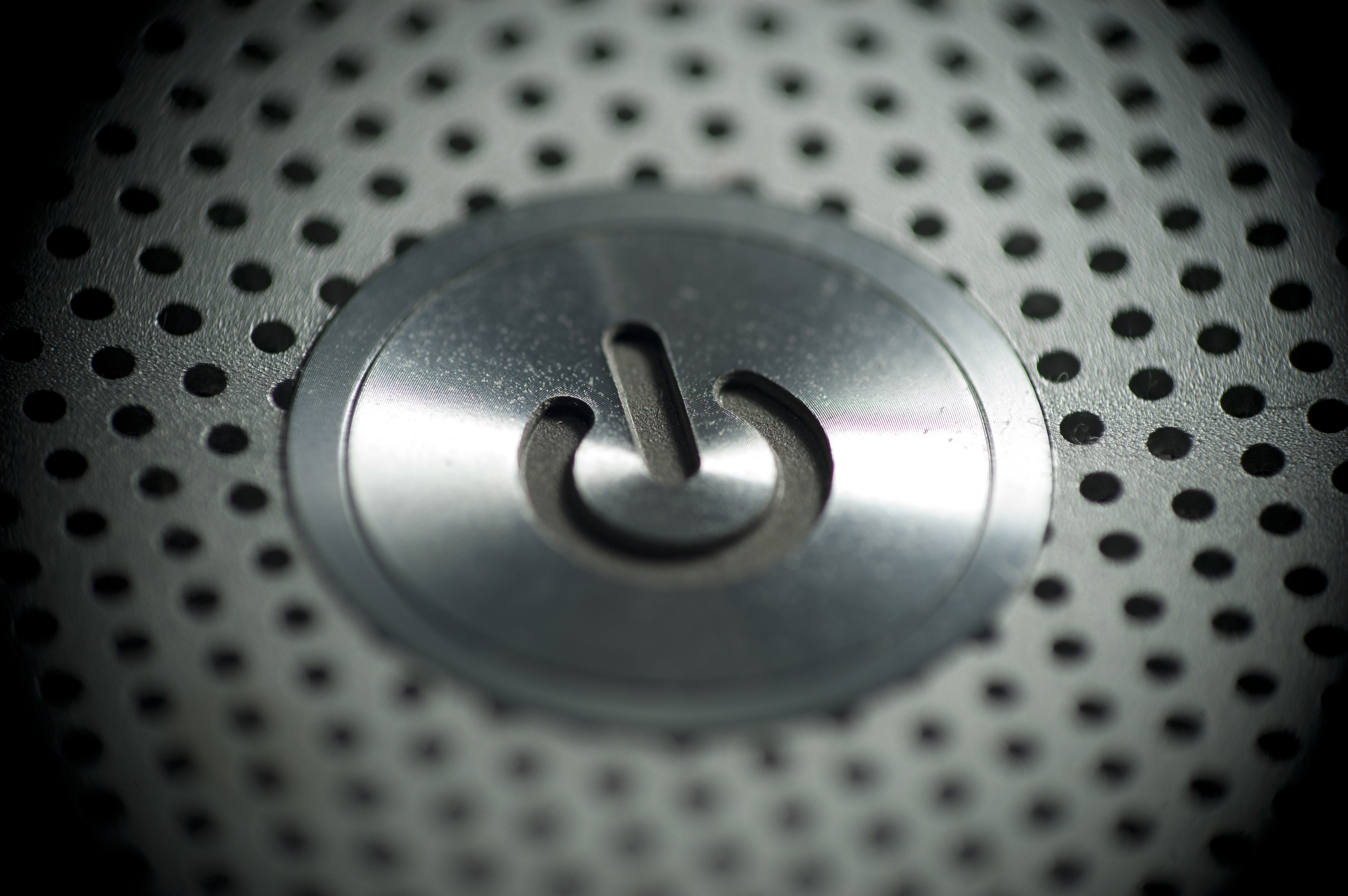

While computers are thought of as a way to perform complex mathematical calculations, they really only deal with ones and zeroes. This is because all of their calculations are based on whether certain transistors are switched off, called “false” or “logic zero”, or switched on, called “true” or “logic one”. The transistors can only occupy one of two states (true or false). Believe it or not, the “power” button on many electronic devices is simply a one and a zero put together.
Macbook Pro power is either on or off, true or false, as represented by the one and zero found on the power button
Figure 1. The power to this Macbook Pro is either on or off, true or false, as represented by the one and zero found on the power button. Image used courtesy of Wikimedia Commons

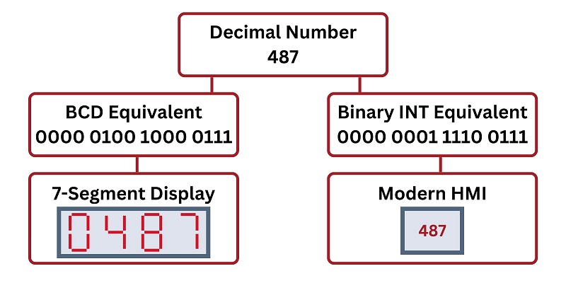

What Is Binary Coded Decimal (BCD)?
The solution was to designate each digit of a decimal number into its own unique binary number. Using the example in previous sections, we could see that 0000 = 0 and 1001 = 9. Every other decimal number lies between these two digits. So to represent all of our decimal numbers, we would need 4 bits.
In the BCD system, each decimal digit is assigned its own 4-bit binary number. It can be known in an instant the number of digits in the decimal number and much more conveniently convert each digit.
For example, the decimal number 487 would consist of 12 binary numbers, 4x for each digit.
0100 = 4
1000 = 8
0111 = 7
Therefore, a full, 16-bit BCD equivalent of 487 would be:
0000 0100 0100 0111
In the following image, the decimal number 487 is shown converted into both a normal binary integer (right path) and a BCD intended for a 7-segment display (left path).
one decimal number can function two different purposes depending on binary data type (BCD or INT) to which it is converted
Figure 3. One decimal number can serve two different purposes depending on the binary data type (BCD or INT) to which it is converted.

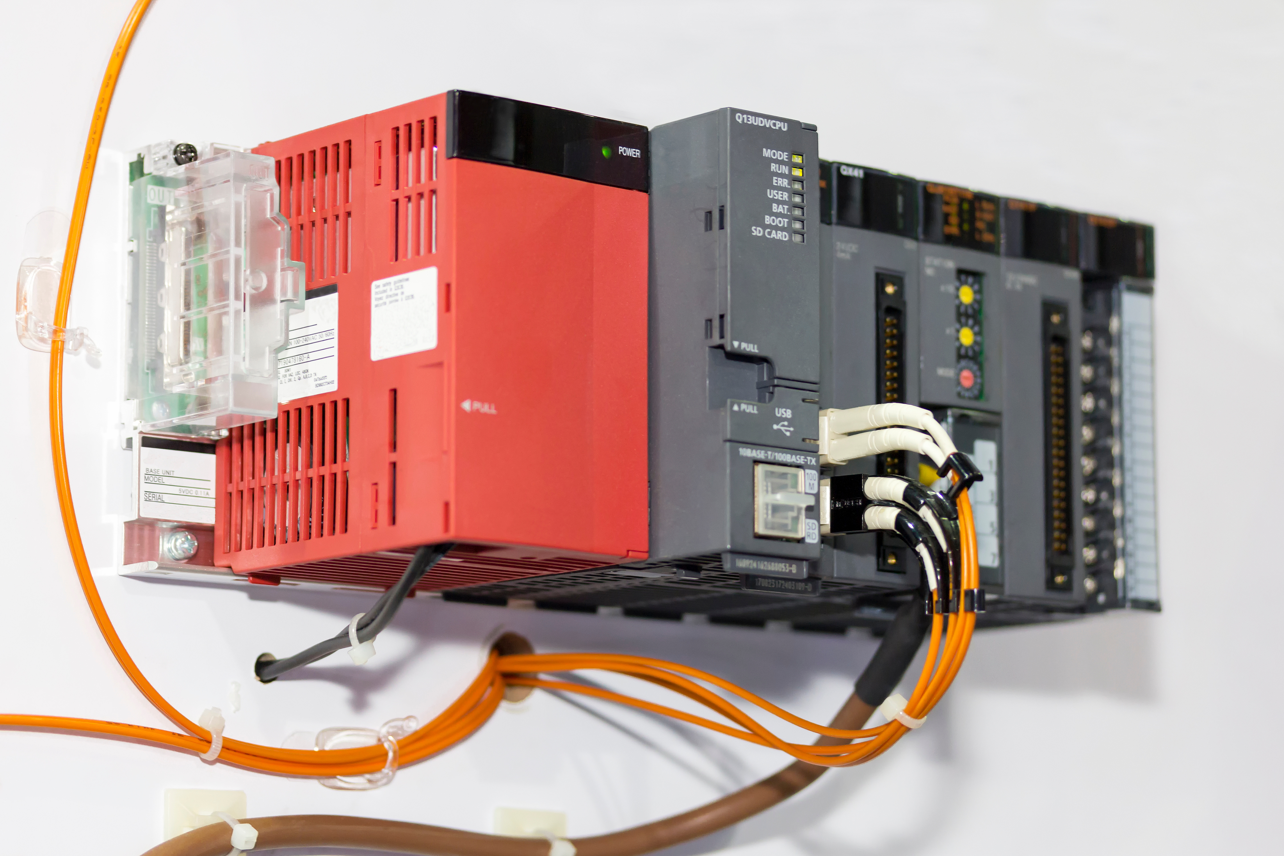

When interfacing with older displays and devices, it is possible in many PLCs and control systems to reserve multiples of 4 bits with a BCD data type. The system will recognize how this number converts to decimal and typical binary.
To interface this data with the actual legacy device, multiples of 4x wires for each digit will be required. It is much more bulky and far less efficient than modern single-cable networks, yet it might still be encountered and is worth knowing.
Modern PLCs may allow for BCD data types, but it is not a very common selection nowadays
Figure 4. Modern PLCs may allow for BCD data types, but it’s not a very common selection these days. Image used courtesy of Adobe Stock
