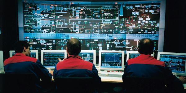

The DCS system allows a much wider breadth of control versus using one single controller
Figure 1. A DCS control room where plant information and controls are displayed on computer graphics screens. Image courtesy of VGB Power Tech GmbH [CC BY-SA 3.0]
Engineers and electricians working in a modern manufacturing facility understand that process control is far more than a small PID controller attached to various machines. These small controllers may still exist, but the scope of a control system spans across the entire facility — and perhaps between facilities worldwide. This is the intent of a facility-wide implementation of a DCS.

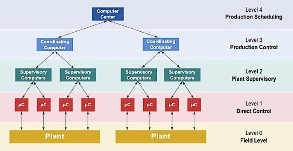

In simplest terms, the DCS is the devices and software required to control a plant from the field level to the enterprise level. Most of the control hardware we are familiar with fits into some level of the DCS architecture.
A DCS is intended to interconnect the control elements of an entire manufacturing or processing facility. It consists of the field-level and cabinet-level hardware as well as the software items running on the floor and enterprise level which collect information and send signals at the hardware I/O level, store information, process instructions at a facility server level, and provide the computing power to implement machine learning, complex simulations, and task handling, and secure the data at a corporate-wide computer level.
What is DCS, and what does it include?
Figure 2. Functional levels of a DCS. Image courtesy of Daniele Pugliesi [CC BY-SA 3.0
Obviously, the system is quite complex, but it includes control elements from the hardware I/O level and up. Most companies and facilities do include each of these elements built up over generations of technology, so in a sense, this is a primitive DCS. However, the cohesive suite of hardware and software products from one manufacturer can simplify the integration process and remove countless hours of frustrating downtime and maintenance.
