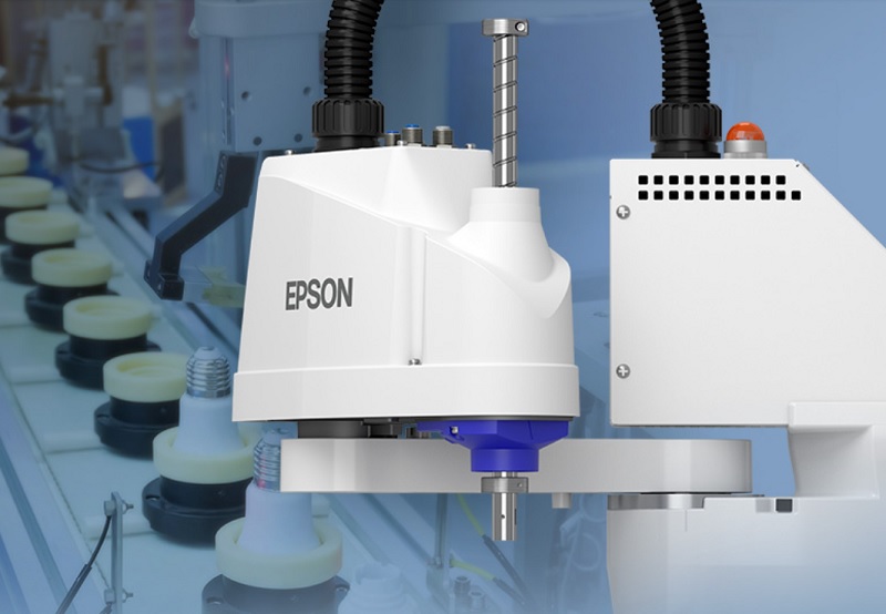

Epson SCARA robot
Figure 1. Epson SCARA Robot model. Image used courtesy of Epson

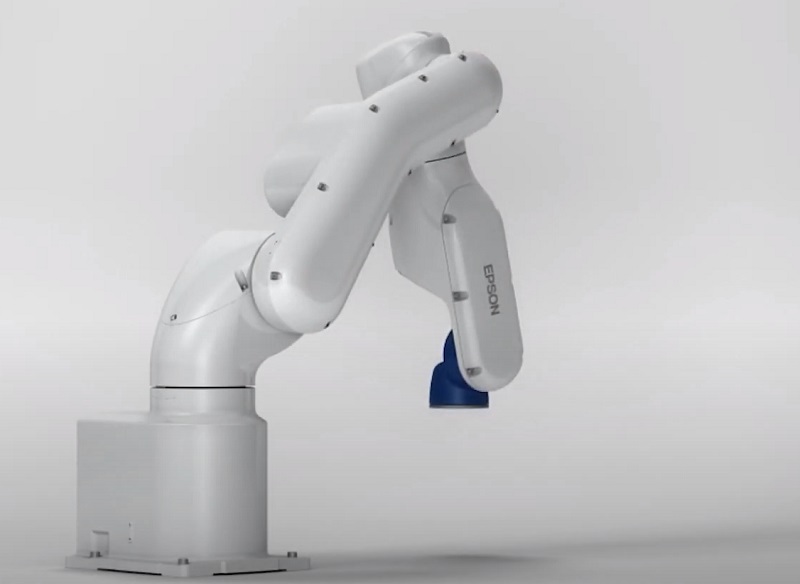

Epson all-in-one robot
Figure 2. Epson’s All-In-One 6-axis robot includes a built-in controller. Power cable and teach pendent connect directly to the base of the robot Image used courtesy of Epson
