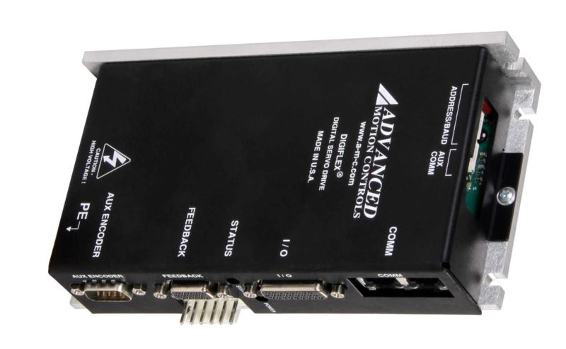

The true power of EtherCAT comes at the device level when large amounts of data can be shared at high speeds using standard message formats.
servo motion drive uses EtherCAT for high speed and data volume
Figure 2. This servo motion drive uses EtherCAT due to its high speed and data volume. COMM connectors visible at the bottom of the module. Image used courtesy of Advanced Motion Controls
By putting multiple devices' information into one frame, the network will have fewer frames passing through to all the devices, reducing delay and jitter. In Ethernet, one frame is sent to each device and must contain more information to reach its destination. The simplicity of EtherCAT also makes the connection reliable. Having more frames in the network can make the jitter higher.
Ethernet communicates with a lot of devices and moves a high volume of information like images, videos, etc. However, EtherCAT connects devices at higher speed with a lower volume of information like 32-bit registers, analog I/Os, digital I/Os, etc. It gives time accuracy with timestamps added. EtherCAT can connect up to 65,535 in one segment, so large network sizes are not a problem.

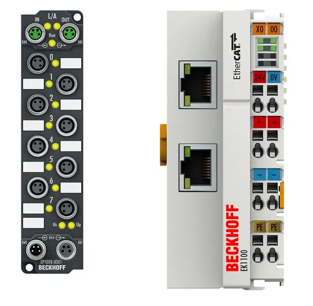

Network Equipment: Hubs, Switches, and Routers
For EtherCAT, it's not necessary to have a network element like a switch to send data. Every device has two ports to connect to each other, and all devices can forward frames. However, a switch or hub can still be connected to the network if necessary. The network topologies supported by EtherCAT are:
  • Ring
  • Bus
  • Tree
  • Star
Beckhoff I/O devices with two EtherCAT ports
Figure 3. Beckhoff, one of the pioneers in EtherCAT technology, has product lines for I/O devices with two EtherCAT ports, shown here as both M8 (left, at the top in green) and RJ45 (right) connectors. Image used courtesy of Beckhoff
With the ring topology, EtherCAT has redundancy and fast recovery from a broken link. This topology means that from the main controller device, each following device has an incoming port as well as an outgoing to the next device. The last device finally has a connection back to the main controller. It's a very simple topology, and this equipment has two ports to create a ring network without needing to add networking equipment that can reduce some costs. If any network cable is broken around the ring, there is still a connection to every device.
