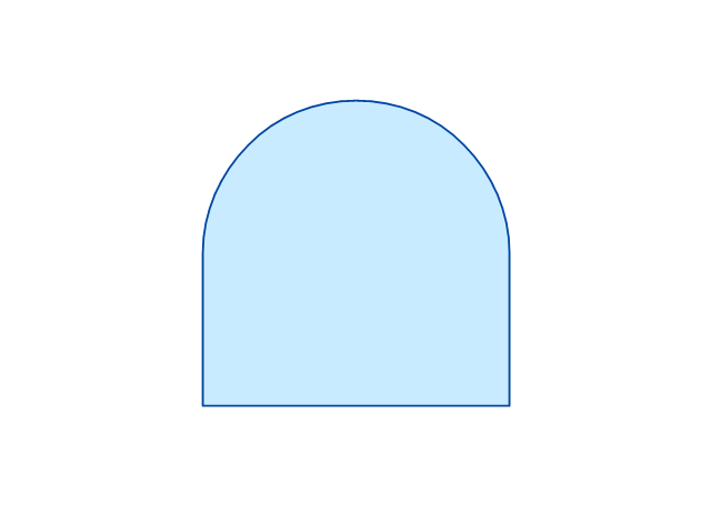

  • AND gate: When all the input events for AND gate occurs, the output event occurs. This is the same as the AND gate used in any logic or computing operations.

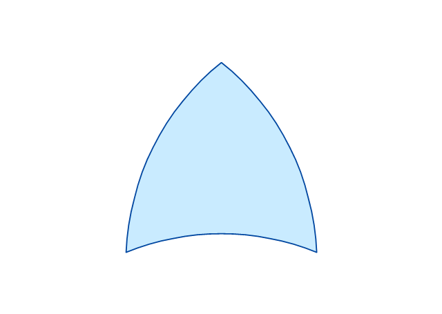

  • OR gate: When at least one of the input events occurs, the output event occurs when they are connected through an OR gate.

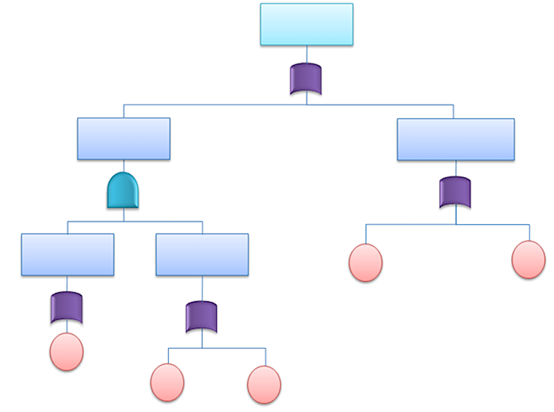

Figure 4. A sample structure of a fault tree. Image used courtesy of Six Sigma Study Guide
