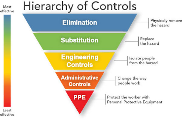

NIOSH hierarchy of controls
National Institute for Occupational Safety and Health (NIOSH) Hierarchy of Controls. Image used courtesy of CDC
  • Hazard identification: RA starts with identifying possible risks. This includes thoroughly inspecting all components or processes involved and looking for any risk contributing to the hazard.
  • Risk analysis: The identified risks are analyzed for possible hazards and assessed to determine their degree of intensity. Hazards are characterized according to their severity and the danger they pose. This step should be performed with a pragmatic approach, as the success of the whole RA activity depends on it. This is a crucial step that can determine the success or failure of the entire risk assessment process.
  • Risk evaluations: The risks analyzed are grouped into different categories against predetermined criteria. These criteria are developed before the risk assessment activity starts, usually taking into account guidelines from relevant regulatory bodies. The RA team can also consult the operating manuals of the machines or equipment involved to develop acceptance criteria.
  • Risk control: Risk control procedures involve the use of different techniques to eliminate the risk. The team considers steps to reduce risk to the minimum possible level if total elimination is not possible.
  • Documentation: All steps of the risk assessment activity must be adequately documented. This includes RA methodologies, process details, all evaluations made throughout the process, and the conclusions. This documentation is necessary because it must be produced when the regulatory body inspects the organization for safety compliance.

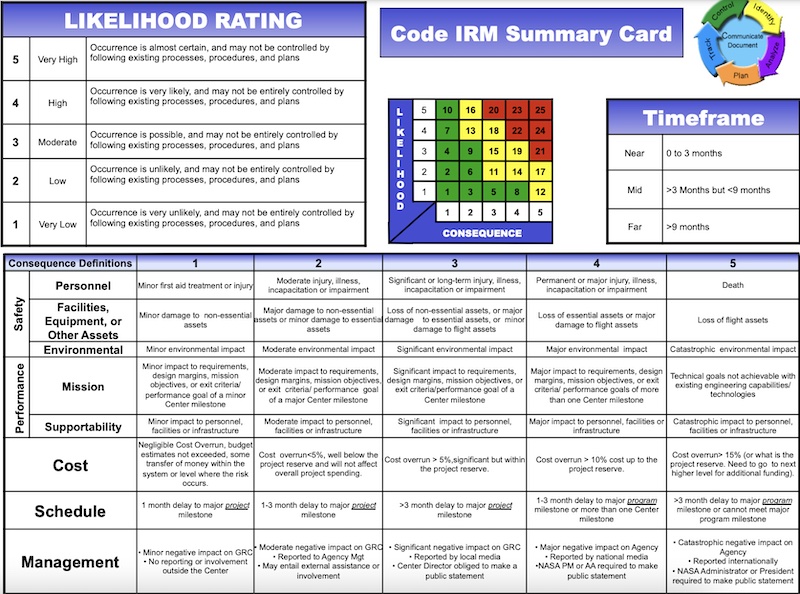

Qualitative Risk Assessment
In this RA technique, the risks are categorized into levels representing risk severity, such as high, medium, and low. Numerical values can also be used to represent the risk severity.
Since this technique represents risks without any tool or calculations, the RA team must be experts in the process, application, or equipment. Otherwise, the outcome will not reflect the actual hidden risks.
Risk likelihood ratings. Image used courtesy of American Society of Safety Professionals (ASSP) [PDF]
Quantitative Risk Assessment
Quantitative risk assessment uses calculations and tools to determine the risks. Depending upon the method and approaches applied, a risk matrix may make the RA process effective.
The risk matrix can be 3x3 or 5x5. It all depends on the process and the method used by the health and safety professionals.
