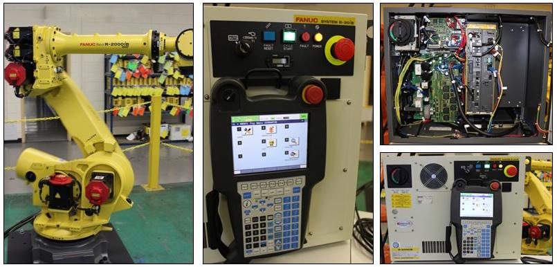

Industrial control panels can be modular or custom-built. Modular ICPs are meant for controlling small equipment and automated islands. These modules follow a central design template, with some variations allowed, depending on minor customizations. Modular ICPs can be mass produced thanks to the standardized design.
FANUC robot ICP following modular design
Figure 3. The ICP of a FANUC robot follows modular design criteria. Image used courtesy of K+S Services

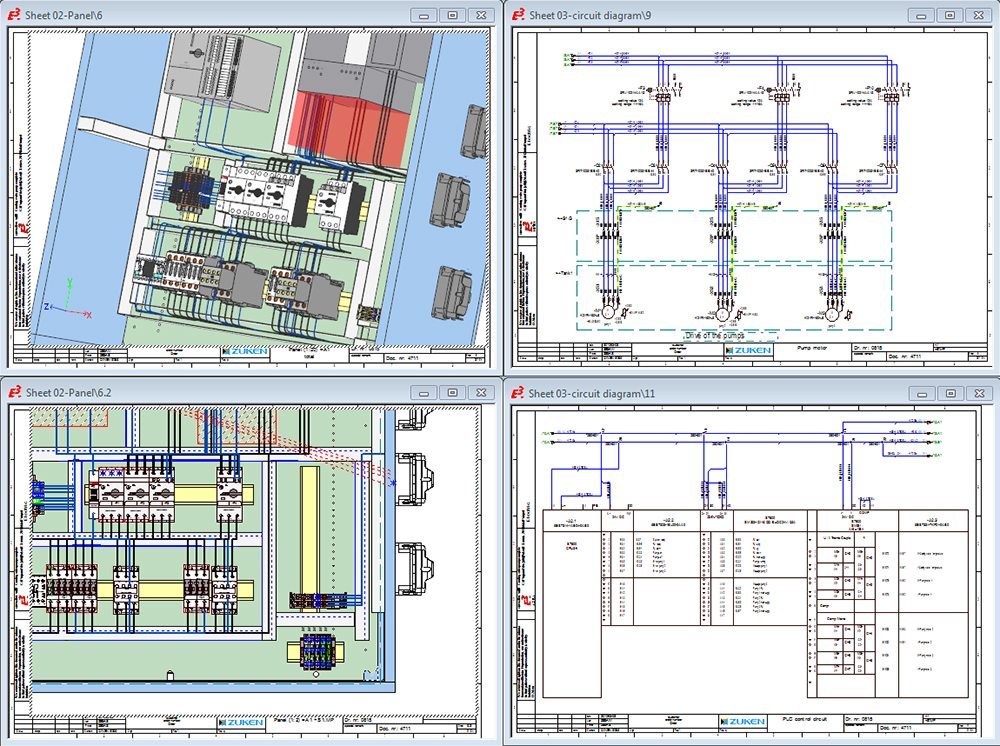

3. Layout Design
Once the functional design is completed, the next step is to create the layout of the ICP. The layout design uses CAD-based applications, such as AutoCAD Electrical Toolset, Zuken E3.panel, Smart Draw, Solid Edge, Ansys Space Claim, and more.
Zuken 3D CAD design of electrical schematic
Figure 4. 3D CAD design and electrical schematic using Zuken. Image used courtesy of Zuken
Advanced CAD tools offer the ability to design and visualize the ICP in 2D and 3D. The 3D design helps understand physical constraints better, especially in tight spaces.
Many ICP design CAD tools also offer the ability to create the electrical diagram within the same project. As a result, the layout design using these comprehensive software tools saves time and reduces errors. For example, some applications offer recommendations for the best wiring routes based on existing connections and electrical diagrams. Following the recommended wiring route reduces costs as wire lengths are optimized.
