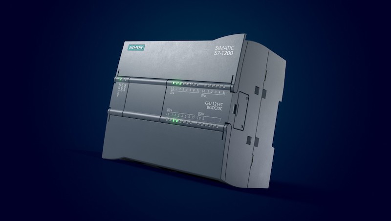

siemens sematic s7-1200
Figure 2. The Siemens SIMATIC S7-1200 micro PLC. Image used courtesy of Siemens
Siemens offers the LOGO! and the SIMATIC S7-1200. The LOGO! uses free programming software and can include additional I/O. It can also connect to a cloud-based system. The S7-1200 is in-between a micro PLC and a full-sized PLC and comes in many different variations. It uses the same software as the full-size S7-1500 and has many of the same features, such as remote I/O connection and OPC UA

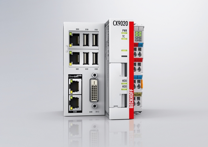

B&R and Beckhoff have compact industrial PC versions of a micro PLC. With B&R, the Compact-S family utilizes the Coretex A9 processor but does not come with embedded I/O. Beckhoff has the CX9000 and CX8000 families, which also don’t have embedded I/O, but use the Cortex A8 and A9 processors.
beckhoff cx9020 micro plc
Figure 3. Beckhoff CX9020 micro PLC. Image used courtesy of Beckhoff
Both the B&R and Beckhoff families may not have embedded I/O, but they also do not have the I/O limitations that other micro PLC systems have. These systems are more like industrial PCs with memory and internal specifications.

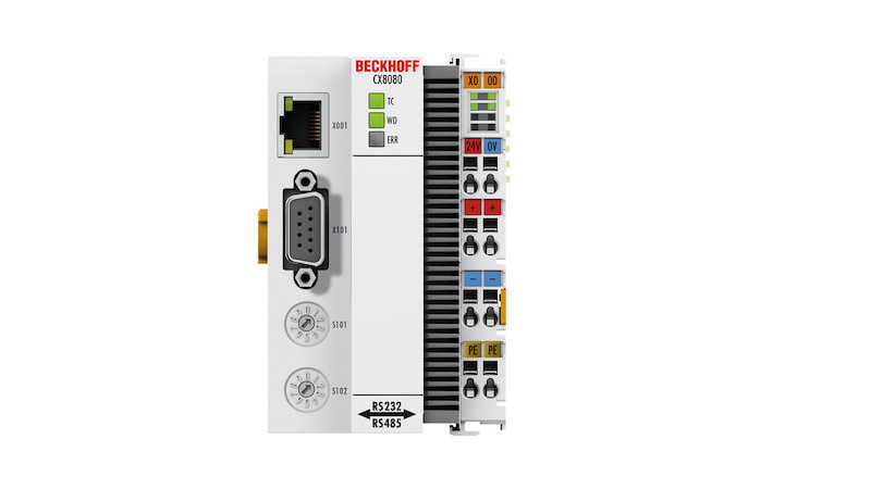

Micro PLCs are a great cost-effective solution to automation projects, but they come with limitations. Each manufacturer has different limitations, and some of the constraints are hidden in the manual’s fine print. The Allen-Bradley Micro800 family has Ethernet/IP capabilities, and is advertised as such, but not all Ethernet/IP devices are compliant. For example, the Allen-Bradley Ethernet/IP remote I/O cannot be used with the Micro800 series system.
beckhoff cx8080 micro plc
Figure 4. Beckhoff CX8080, showing Ethernet/IP connections. Image used courtesy of Beckhoff
One of the biggest limitations is the memory size. While the cost of memory has come down considerably over the last 10 years, automation devices still have memory constraints. Most microsystems will not allow for expandable program memory but will allow SD cards, or other removable memory storage, to store recipe parameters.
Limitations can be hard to find but usually prevent using features that the bigger brother PLCs would use.
