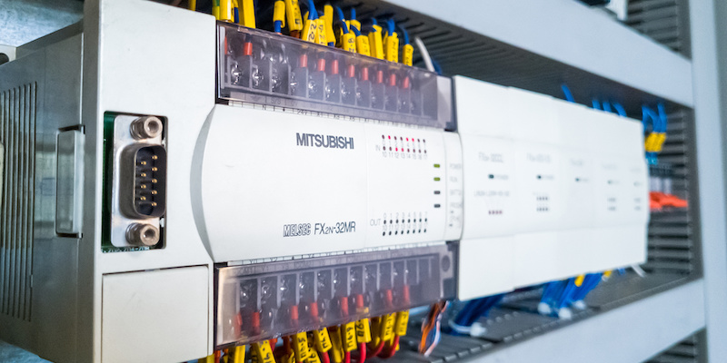

The FX series PLC is one of the introductory MELSEC product lines from Mitsubishi Electric. The company is widely recognized for the manufacturing of automation solutions across the globe. In this tutorial, we are going to guide you through the basic steps of using MELSOFT GX Developer version 8, which supports MELSEC controllers.
Mitsubishi Electric FX series PLC
The FX series PLC, part of Mitsubishi Electric's MELSEC product line. Image used courtesy of Adobe Stock
