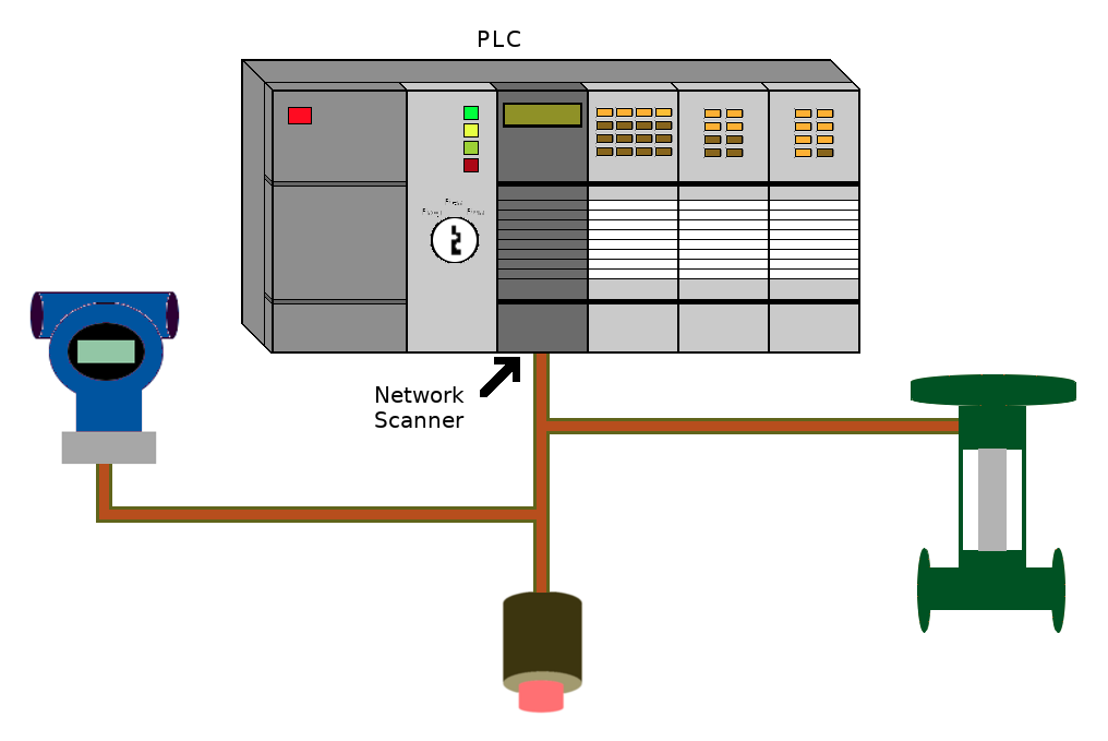

A fieldbus is a communication protocol used in industrial networks to connect field devices to industrial controllers. A fieldbus often reduces the amount of wiring needed between controllers and devices because multiple devices can connect to the same pair of wires.
There are a number of popular fieldbus technologies out there including Modbus, Profibus, Foundation Fieldbus, ControlNet, DeviceNet, and many others.
Figure 1 shows a PLC connected to field devices via a fieldbus.
Figure 1. A PLC connected to field devices

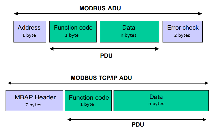

A message frame in Modbus is composed of an application data unit (ADU) and a protocol data unit (PDU). The ADU will differ depending on the type of Modbus being used, while the PDU is independent of the communication method.
A PDU is normally composed of a function code and some data. This is encapsulated in the ADU by an address and error checking code. Modbus TCP uses an MBAP (Modbus Application Protocol) header in the ADU.
Figure 2 shows a Modbus frame comprised of a PDU and ADU for both classic Modbus and Modbus TCP.
Figure 2. Modbus ADU and PDU. Image adapted from Modbus.org
For the PDU to remain independent of the underlying communication layer, it must conform to the size limitations of the original serial specification. This size was 256 bytes for the ADU over RS-485. Thus, the PDU is limited to 256 – 1 address byte and 2 error checking bytes for a total of 253 bytes. Note the address in the ADU is actually the ID of the slave device on the Modbus network.
The data portion of the PDU will contain fields specific to the function code along with the actual data being transmitted. These fields will be discussed in detail later in the article.

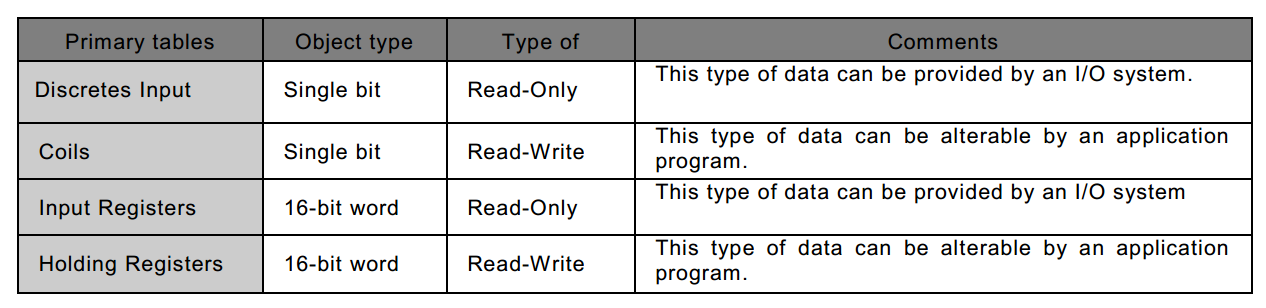

Modbus data comes in four primary types:
  • Discrete inputs
  • Coils (outputs)
  • Input registers
  • Holding registers
Discrete inputs represent a single bit of data and are read-only. Coils also represent a single bit but can be both read and written to. Input registers represent 16-bit read-only data, while holding registers are 16-bit read-write data. Figure 3 summarizes this.
Figure 3. Taken from the Modbus Protocol Specification
For each type, a maximum of 2^16 (65536) data items can be located in a device's memory. There are specific function codes for accessing each of the different data types, with each type often having its own dedicated block of memory.
To address a data item, a master simply uses the range from 0-65535. Data item 1 would be located at address 0x0000. Data item 2 would be at address 0x0001. Data item 65536 would be found at 0xFFFF. Keep in mind devices aren't required to have all 65536 data items, it's simply the maximum.

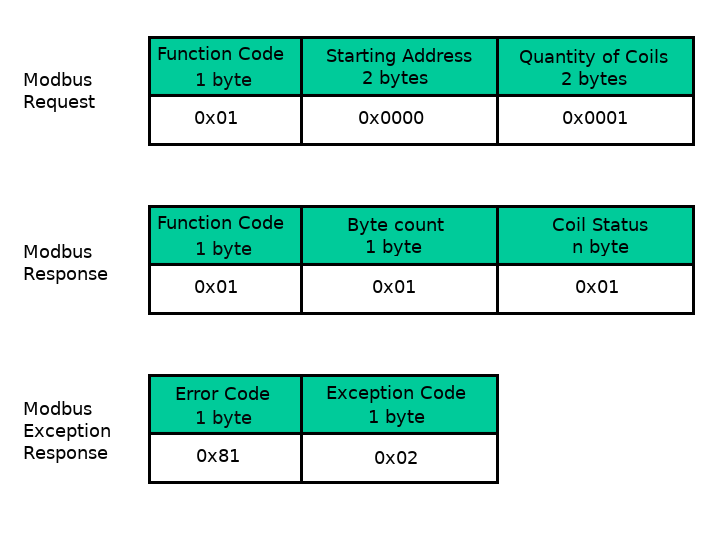

There are a number of function codes defined by the Modbus specification. Function code 0x01 is the Read Coils function.
Figure 4 shows an example of what a Read Coils request and response might look like. The Modbus master sends a request with function code 0x01 (Read Coils) starting at the first data item (address 0x0000) and reading only a single coil. The Read Coils function can be used to read up to 2000 (0x7D0) coils at once.
Figure 4. Read Coils Transaction
If successful, the slave responds with the same function code and a count of the number of coils it's replying with. The coil status will be n bytes wide with each bit representing whether that particular coil is ON (1) or OFF (0).
In this case, the coil at address 0x0000 is ON. Had the request not been successful, the exception response would contain the function code with the msb set high (0x81) along with an exception code that explains what went wrong. Exception code 0x02 means that an illegal data address was used, i.e., there is no coil at 0x0000 in this slave's memory.

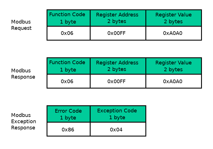

Figure 5 shows an example of a Write Single Register transaction (function code 0x06). Here, the master requests a write of data 0xA0A0 to address 0x00FF. The slave's response is simply an echo of the request.
The example exception response here shows the function code with the msb set high along with an exception code of 0x04. This code means that an unrecoverable error has occurred while the slave was attempting to perform the request.
Figure 5. Write Single Register Transaction

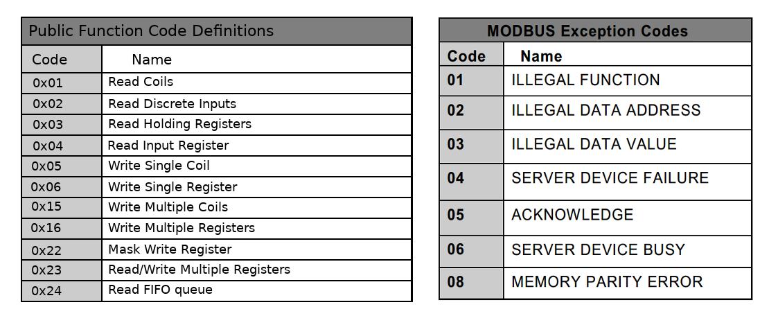

Figure 6 shows a list of the common function codes along with exception codes for exception responses. For more information consult the Modbus specification.
Figure 6. Function Codes and Exception Codes
