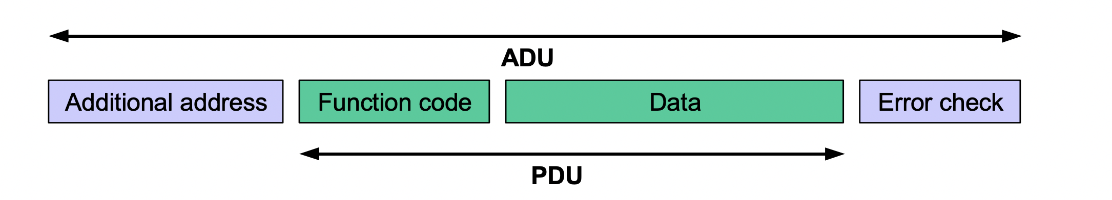

standard Modbus data frame
Figure 1. A standard Modbus frame. Image used courtesy of Modbus

Each message will have an address, a function code, a data register, and a cyclic redundancy check (CRC) register. The slave device will compare the message address, and if it’s a match to its assigned address, the device will execute the function code.

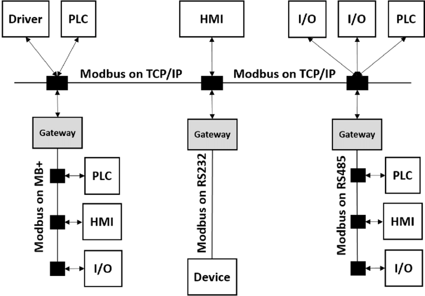

Modbus network architecture
Figure 2. An example of a Modbus network architecture. Image used courtesy of Figueroa-Lorenzo et al.

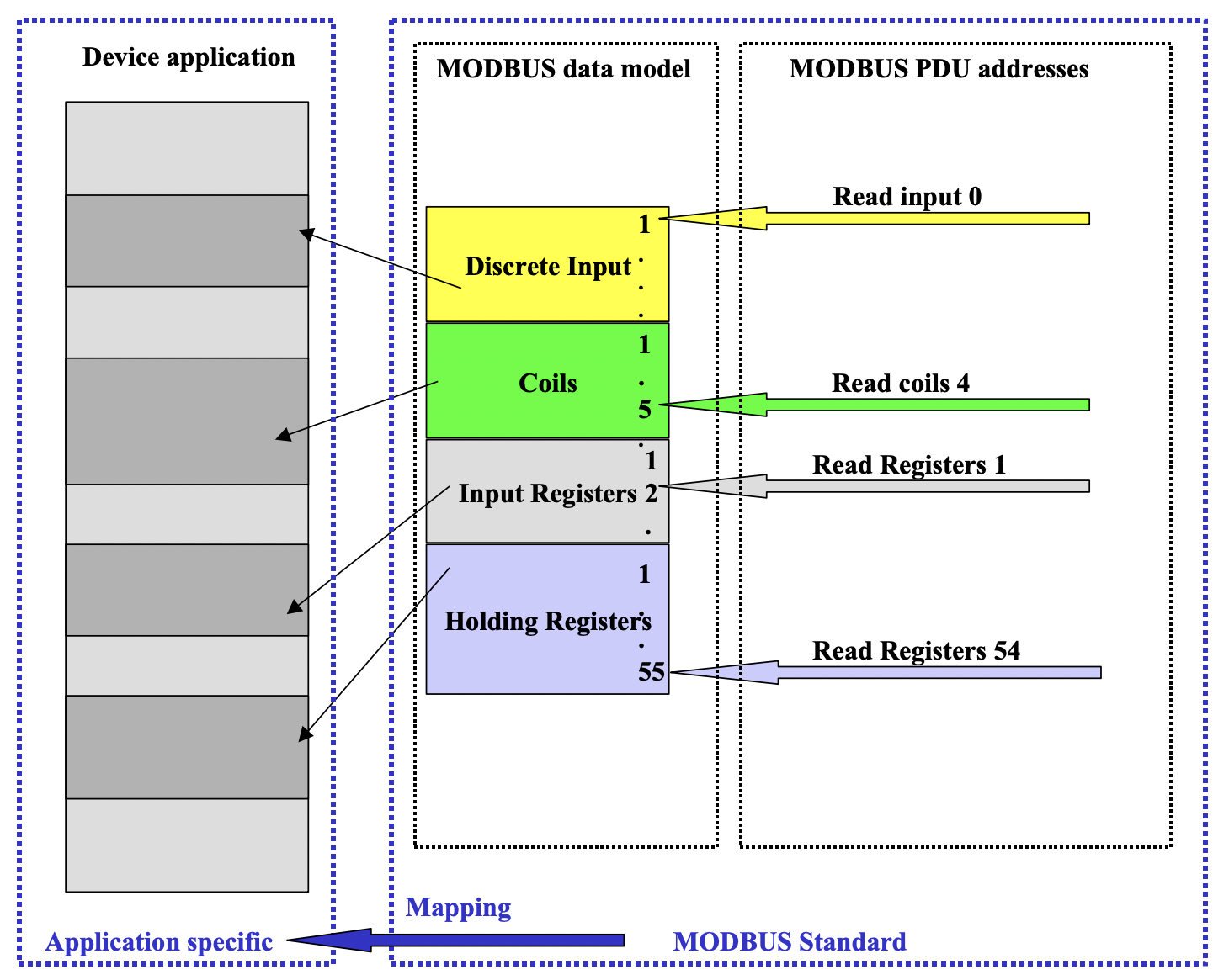

Modbus addressing model
Figure 3. A Modbus addressing model. Image used courtesy of Modbus

Typically, each device on the Modbus network will have four memory registers: discrete inputs, coil outputs, input registers (input data), and holding registers (output data). These memory registers can be read or manipulated using function codes.
The device uses these memory registers to control or monitor itself. For example, a VFD might use the discrete inputs or registers to start, stop, or reset faults. The input registers can be used for setting speed or frequency, and the holding registers can be used to display the speed or frequency output. A sensor may only have the ability to read input registers which is where the sensor's values would reside.

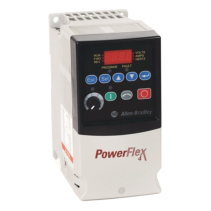

VFD serial ports with RS-232 and RS-485 use Modbus
Figure 5. Most drives in the Rockwell (Allen-Bradley) PowerFlex series can use Modbus. Image used courtesy of PLC City

Rockwell and Allen Bradley have a product line of VFDs called PowerFlex. Some of these drives use Modbus to monitor and control the VFD.
The PowerFlex 4 uses an RS485 network and Modbus protocol to monitor and control the drive using only holding register functions. Always refer to the device’s manual for mapping and memory register layout.
The address 8192 (decimal) can be used to control the drive. This address is a holding register with 16 bits (2 bytes, or 1 word). We need to use the binary numbers to address individual bits within the two bytes. If we want to set the start bit on, then our binary number would be 0000 0010 which is hex 00 02. This same register can be used to control acceleration and declaration rates along with jogging and clearing faults. To start the motor, our protocol data unit will be as follows:
