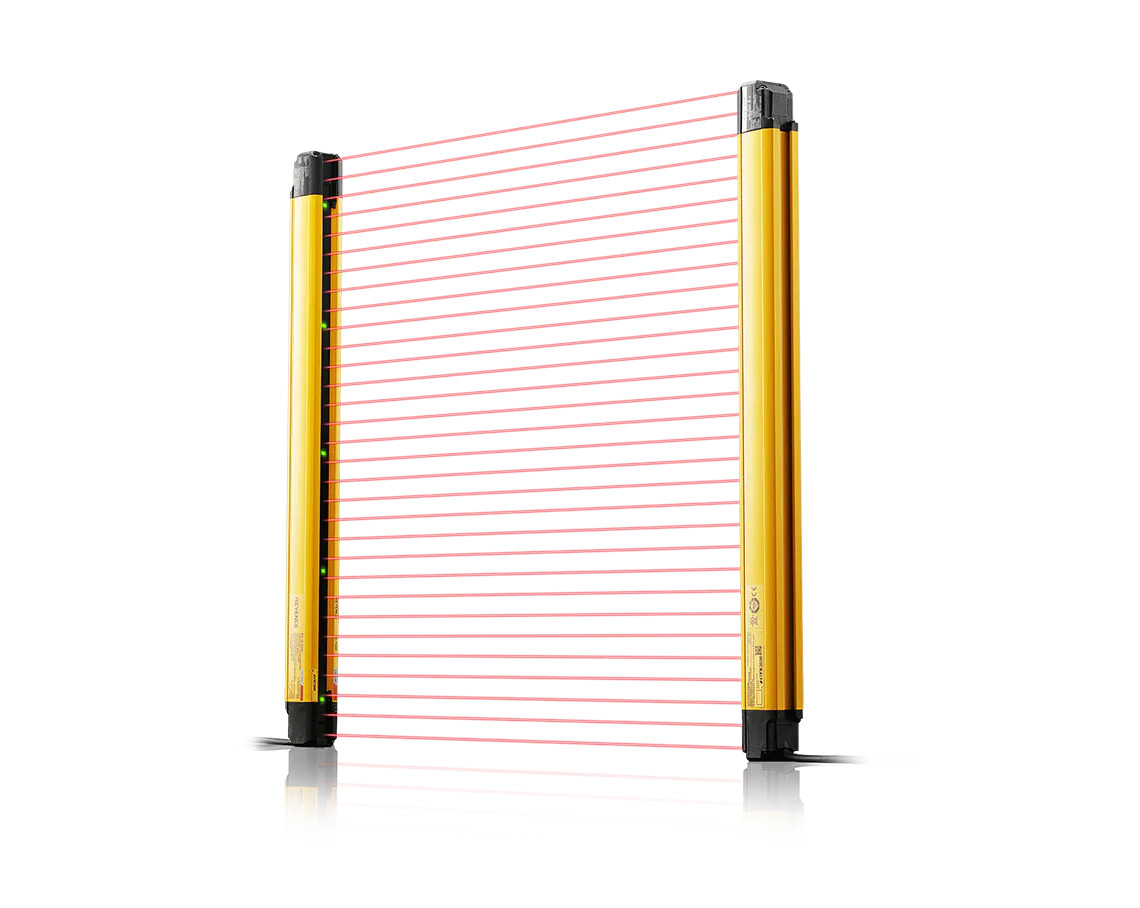

Light curtains are long cylindrical sensors that generally contain a transmitter and a receiver. The transmitting side of the curtain sends a laser across the space to be protected and the receiver accepts the signal. When a receiver stops seeing a signal from the transmitter, caused by something or someone in the signal’s path, an E-Stop is triggered for the motion devices in the machine being safeguarded.

Light curtains are safety regulated and approved for use in safety circuits allowing them to be used for E-Stop purposes. They are more complex than other photoelectric sensors and have the ability to monitor themselves with the use of redundant signals, meaning they can stop an internal hazard when an internal fault is detected. Two sets of output signals must provide matching ‘active’ signals. If any internal circuitry fails, one or both outputs will de-energize, triggering an E-stop event. This distinction means that they conform to regulations designed to safeguard dangerous machinery and robotic cells.

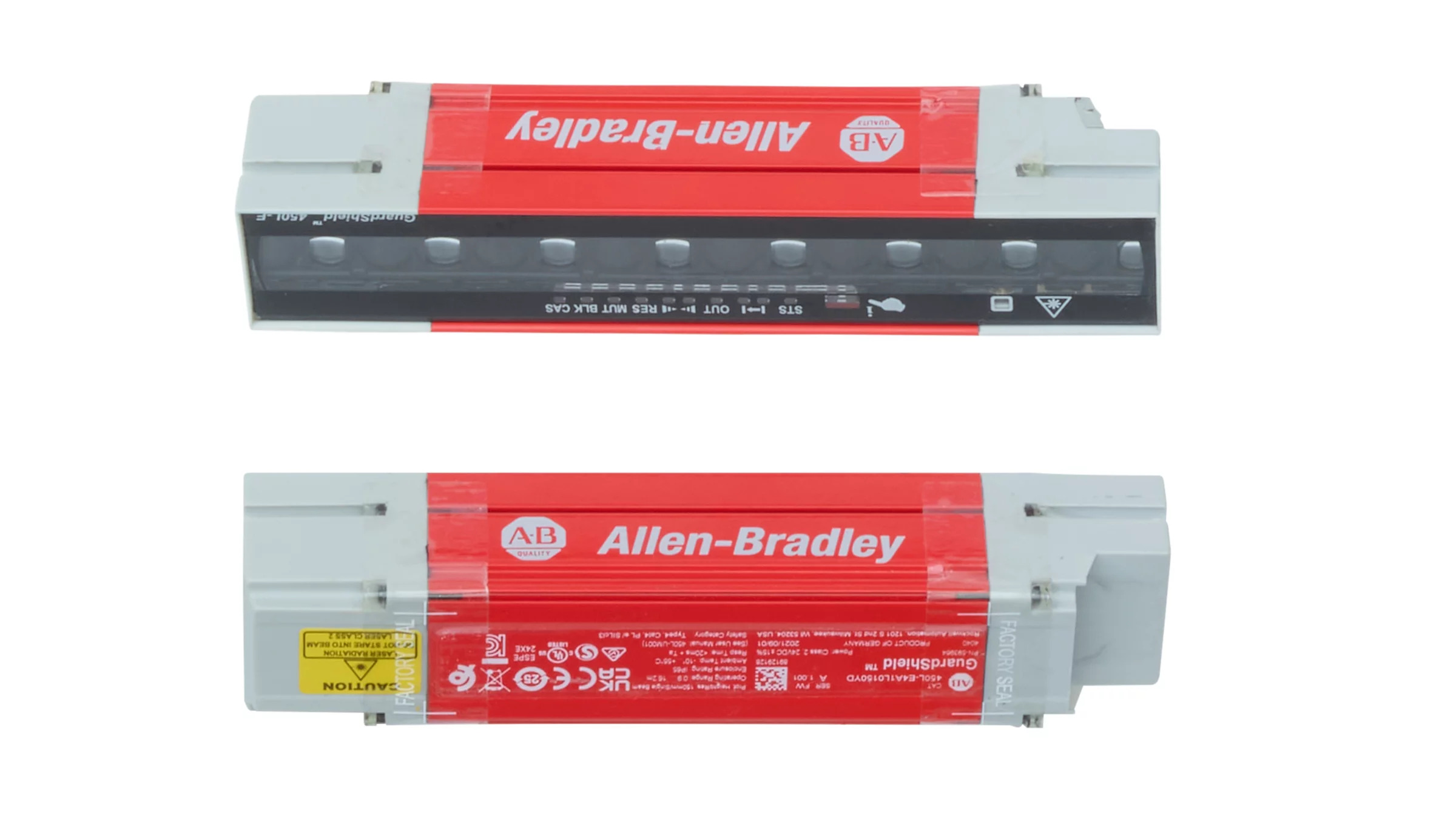

Rockwell Automation 450L GuardShield PAC Safety Light Curtains
Figure 3. Rockwell Automation’s 450L GuardShield PAC Safety Light Curtains are one of many light curtain options on the market. Image used courtesy of Rockwell Automation
