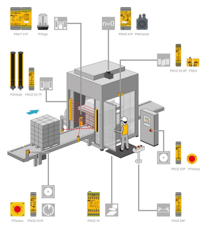

Pilz safety relay example
Figure 1. Safety system with various relays and emergency devices. Image used courtesy of Pilz

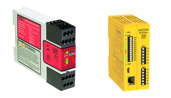

Banner safety relay example
Figure 2. Various sizes of safety relays. Image used courtesy of Banner Engineering
