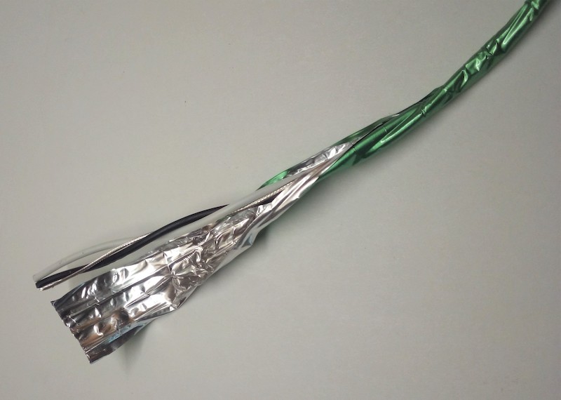

The most common is a thin metal foil or tape wrapped entirely around the length of the cable, just under the insulation jacket (see Figure 1). From the outside, it doesn’t look any different, but the cable ends will usually be metallic. This is a giveaway in an Ethernet cable of any category — if the end connector is encased in metal, it is almost certainly a shielded cable. If you were to peel back the plastic jacket, you would see a thin aluminum foil layer.
Figure 1. A twisted pair set of wires with a green foil shield wrapped around the cable to prevent interference. The twisting of the wires helps to further reduce internal capacitive interference between the wires.
