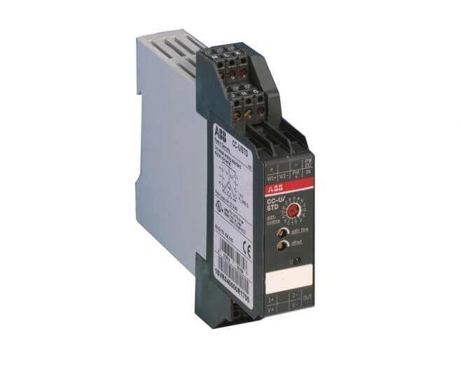

What is a Signal Conditioner?
A signal conditioner is designed to condition the incoming signal for a circuit's next level or another sensor in an instrumentation system. Signals conditioners are used to filter out noise, increase the amplitude of the low-level signal, and convert from one unit to another.
Figure 1. A standard analog signal conditioner. Image used courtesy of ABB
The input signals are often analog. These analog signals represent physical values, such as temperature and pressure. These signal levels are small enough to be detected. However, when the instrumentation circuitry can't see these signal levels, meaningful data can be lost. In addition, noise levels can also affect these small value signals and shrinks the valuable information.
The instrumentation system uses sensors with varying input signal characteristics to collect physical variables. Signal conditioners make the incoming signal, input sensor, and electronics components compatible and collaborate.

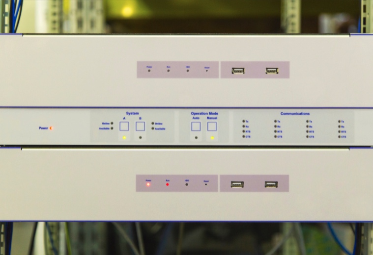

Signal Conditioners and Data Acquisition Systems (DAQ)
Signal Conditioners cannot be used as a standalone component for any application. Instead, they are used as a part of a signal processing system, such as a data acquisition system (DAQ).
Correct specifications of signal conditioning are necessary for the successful implementation of DAQ systems.
Figure 2. Servers for supervisory, control, and data acquisition system (SCADA).
Data acquisition systems are used to process the incoming physical value signals, such as temperature and pressure, to perform real-time processing. A DAQ system consists of many sub-systems, including signal conditioners.

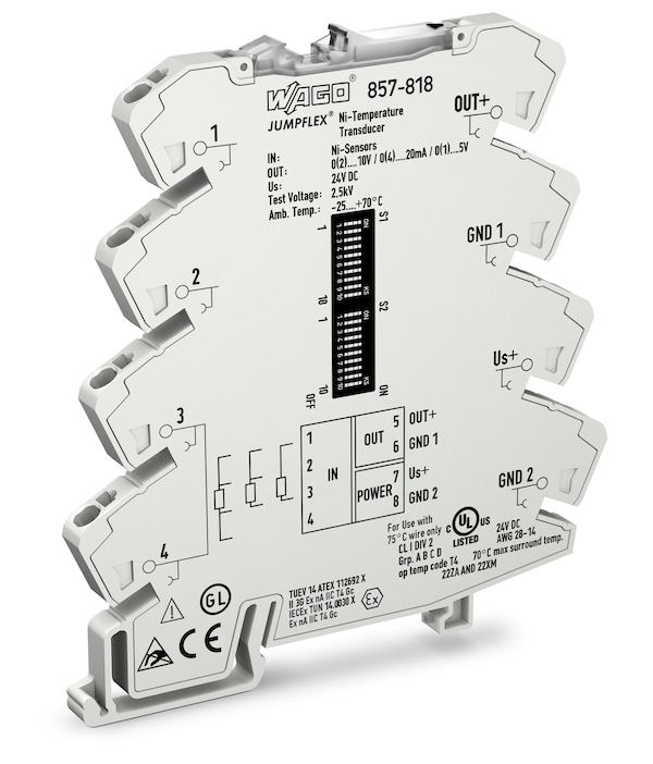

Figure 3. A temperature signal conditioner. Image used courtesy of WAGO

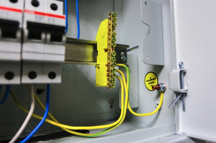

Proper Grounding
Improper groundings are a common source of noise in data acquisition systems. The ground in an electrical circuit is a reference potential voltage, and in most cases, it's usually at 0 volts. All the components in a course are connected to the same ground.
Figure 4. An electrical ground wire connected to ground copper bar.
If the ground is not installed or a wire breaks from ant component to ground, the noise will quickly find its way into the original signal carrying through components and wires.
