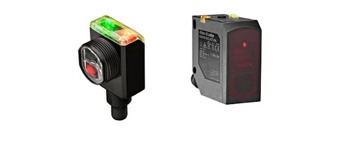

Microprocessor Unit (MPU)
The sensing element output runs into the microprocessor unit (MPU). The MPU is the heart of the smart sensor, and it is where all essential functions are carried out. There are two functions performed in an MPU: signal conditioning and delf-diagnosis.
Figure 2. A few Allen-Bradley smart sensor options. Image used courtesy of Rockwell Automation
In signal conditioning, the MPU performs signal-level signal processing functions before transferring to the central controller. These functions, such as filtering and noise reduction, are necessary to extract information from the collected data.
In self-diagnosis, the sensor assesses its reliability. This allows the sensor to watch its performance and take action when it detects any performance deviation. Examples include self-calibration and auto-zero functions.
Self-diagnosis helps remove abnormalities occurring in the signal output before it is transferred to the main controller. This contrasts with standard sensors, where these abnormalities are removed manually (for example, manual inspection) or by implementing programming functions in the main controller.

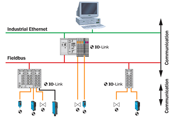

Communication Module
The communication module manages communication between the smart sensor and external devices. In addition to signal information, the smart sensor can also communicate identification (ID), analyzing an individual sensor’s health and connection status. Another advantage is an automatic sensor configuration from the main controller for the sensor.
Figure 3. Smart sensors can communicate with the control system through Fieldbus or Ethernet. Image used courtesy of SICK
Sensors are added as a node in an intelligent sensor network. This helps expand the network without additional re-wiring in case of sensor addition.
The communication can be wired or wireless and is governed by communication protocols. There are many protocols for smart sensor communication, depending on the system application and application area. For example, smart sensors often utilize the Fieldbus protocol in industrial applications. Comparatively, building automation typically uses BACnet.

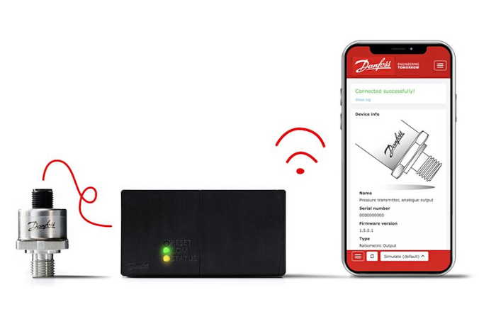

Self-diagnostics
Smart sensors can collect intelligent data to predict the future performance of the sensor and its associated process. The smart sensor can analyze the ongoing operation and conclude the sensor’s working and process condition based on the collected data.
Figure 4. The Danfoss Edix platform is one way to run self-diagnostics and monitor remotely. Image used courtesy of Danfoss
The self-diagnostics feature is more effective than manual inspection, as the self-diagnostics operation is continuous and helps prevent human errors. For example, if the signal strength output of a proximity sensor decreases below a threshold point, it can initiate a signal to alert the system or operators. Some smart sensors can also communicate potential causes, such as the dirt accumulation at the sensor head.
