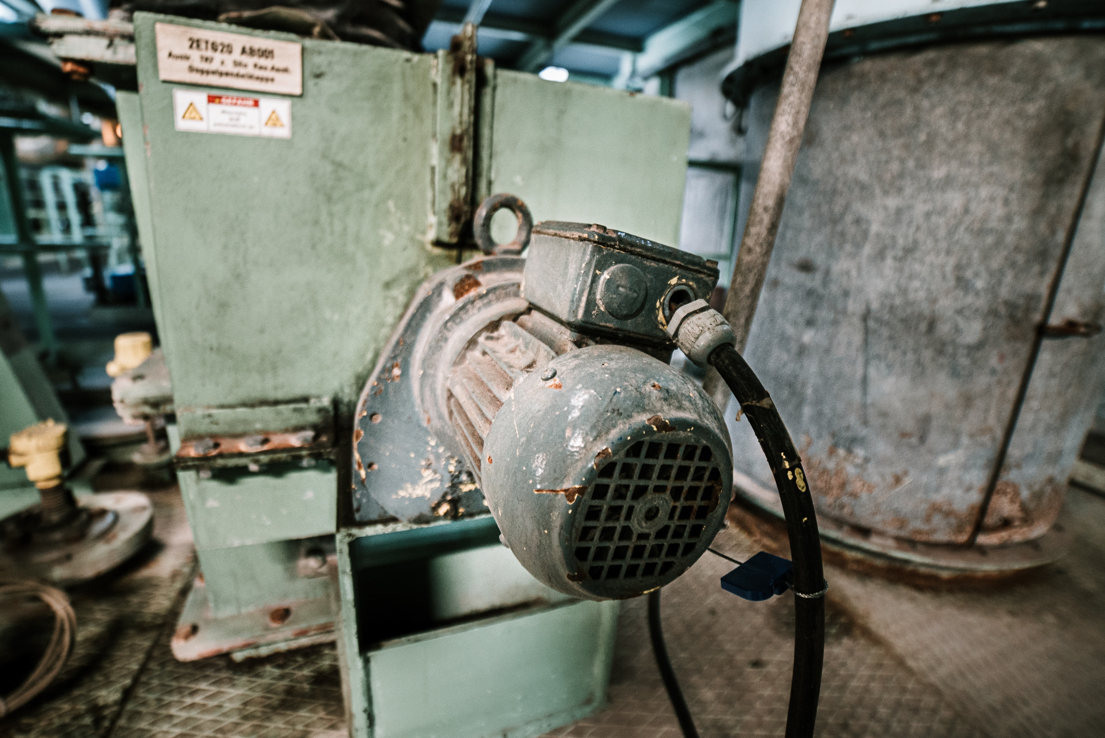

Figure 3. There are several steps to consider before disconnecting a motor that needs to be serviced. Image used courtesy of Mika Baumeister

Industrial equipment is not always shiny and clean, in fact, it is not uncommon for markings, identifiers, or labels to become worn off or missing entirely over time. It is for these reasons we often rely on tools like the 3-phase rotation meter.
Before disconnecting a motor that needs to be serviced, you need to determine the rotation of the motor. This step can sometimes be as simple as witnessing the motor work or checking the nameplate. Other times, the motor might be incorporated into machinery where the rotation cannot be visible. In this case, use a non-contact meter to determine the rotation before disassembling the motor.
Once the rotation is determined, check the phase rotation at the power source. Don’t assume that the labels on the conductors are correct—confirm with your meter.
Now you know the phase rotation for the incoming voltage and the rotation the motor should be after the new motor is connected. The last step is to check the new motor windings for the correct configuration of the three phases. Connect the leads from your rotation meter and rotate the motor in the direction you would like it to go. If the rotation matches your meter’s indicators, then that is the order your conductors need to be connected in. If your meter is showing the opposite direction, then swap any two leads. Always ensure you know which way the motor will turn when powered on to avoid costly damage to downstream equipment.
