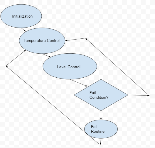

State Diagrams
For example, imagine a control system that must check the temperature and level for a tank system. If either of these variables is out of specification, a “fail” condition is met, and some other actions must occur before checking temperature and level again.
Rather than coding right away, one could break this into blocks, or states, that the VI could include. In this case, there needs to be an initialization step, a temperature control, a level control, a parameter check, and a fail routine. Once you define all of these states, you can interconnect using arrows to show the flow of the VI between these states. This is called a “state diagram.”
state diagram
Figure 1. State diagram VI for a temperature and level controller.
Looking at figure 1’s state diagram, one can see that each state has a finite number of next possible states. From the initiation state, the VI will only lead to the temperature control state, and the temperature control state will only lead to the level control state.
Notice the diamond: the decision symbol. When the VI reaches this state, there are two possible outcomes. Either the system is running properly, and the next state is temperature control, or there was an error, and the next state is the fail routine.

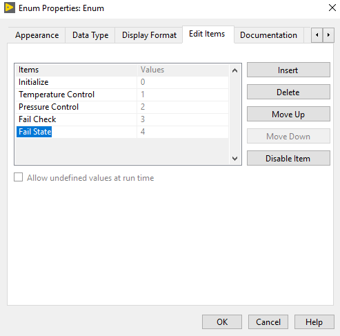

First, set up the state list with an enum constant in the block diagram and then right-click to edit the properties. In the properties menu, there is a tab called “edit items.” This is where the state names can be entered.
Figure 2. Setting up the enum with the state names.

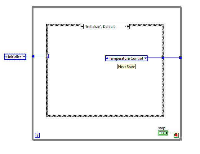

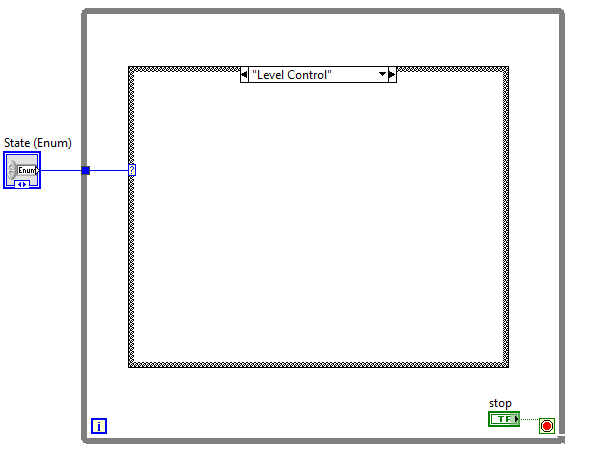

In the block diagram, place a while loop and then a case structure, and wire them as shown in figure 3. Right-click on the case structure and click, “add case for every value.” Notice that the case structure is now populated with all cases (states) from the enum control.
Figure 3. Beginnings of a state machine.
Next, copy the state enum and place it in every case of the case statement. This is how the next state will be determined. Wire each through the side of the case statement to the loop. Then, in each case, select the next state according to the state diagram, as shown in figure 4.
Figure 4. In the “initialize” case, the next state is “temperature control,” just like in the state diagram.

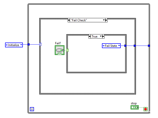

For the “fail check” case, there are two possible next states: “fail state” if there were problems or “temperature control” if there were no problems. To choose the next state, add a nested case statement, where “true” outputs the “fail state” case and “false” outputs the “temperature control” case.
Figure 5. Multiple possible outputs for the next state. In this VI, there is a button to choose which state is next; in a functioning control VI, this would be replaced with control logic.

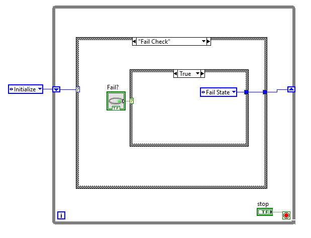

The final step is to convert the two blue tunnels on the outside of the loop (blue squares) into shift registers. Shift registers are merely a way to access data from the previous loop iteration. This will allow the VI to see the “next state” when the loop begins again. Right-click on either tunnel and select “replace with shift register.”
Figure 6. A competed state machine, where the “fail check” state can choose between two next states, just like in the state diagram.
This is not the entire VI, but a starting point for state machine architecture. Each of these states needs to be populated by the sub-VIs that handle the measurement and control logic. Data, such as a boolean flag to indicate a problem, can be passed between loop iterations using shift registers.
