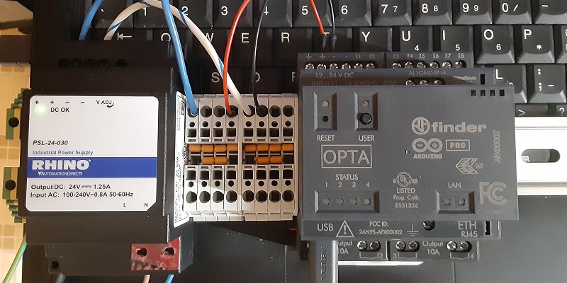

Arduino Opta PLC simple test bench. USER button is programmable input for this intro project
Figure 1. A simple test bench with the Arduino Opta—the ‘USER’ button at the top serves as the programmable input for this intro project.

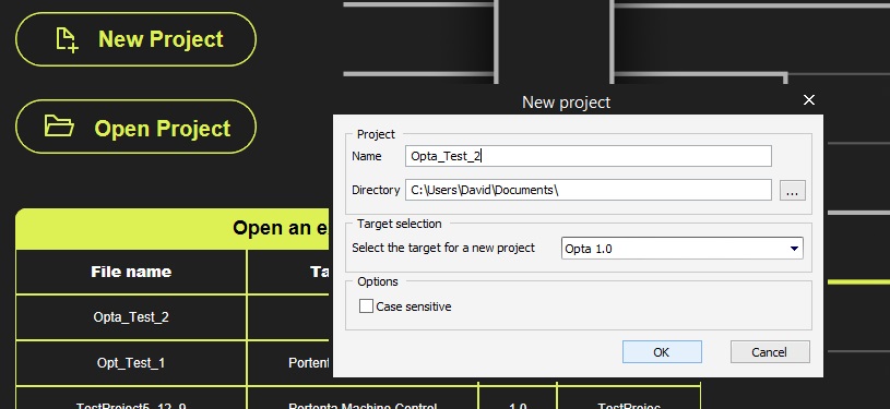

Before getting started, it is recommended to download the most recent version of the IDE and the tools (both free and available from the official Arduino software site). Install both packages, which as of this writing, are version 1.0.3, which indeed supports the Opta platform.
After installation, open the software, and create a new project. Give it a name, which I will reference for my own project as Opta_Test_2 from this point forward, and be sure to select ‘Opta 1.0’ as the target.
Creating a new project for the Arduino PLC IDE.
Figure 2. Creating a new project for the Arduino PLC IDE.

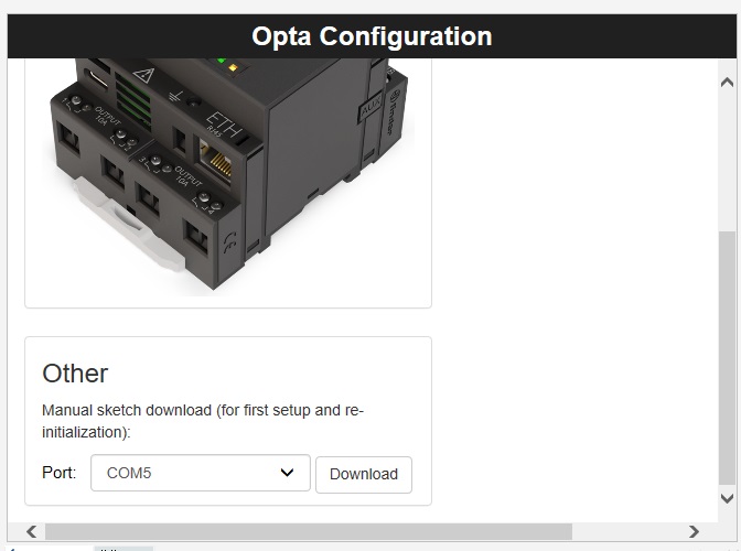

At this point, you will need to download a first initialization sketch, but only on a complete reset or first use. The overview page should show the image of your Opta PLC, but scroll down until you find the ‘Other’ selection for manual sketch download. There should be a COM port selected (mine was COM 7 on first installation, the COM 5 was added after), then download.
PLC IDE code setup and initialization download
Figure 3. First setup and initialization download of the PLC IDE code.

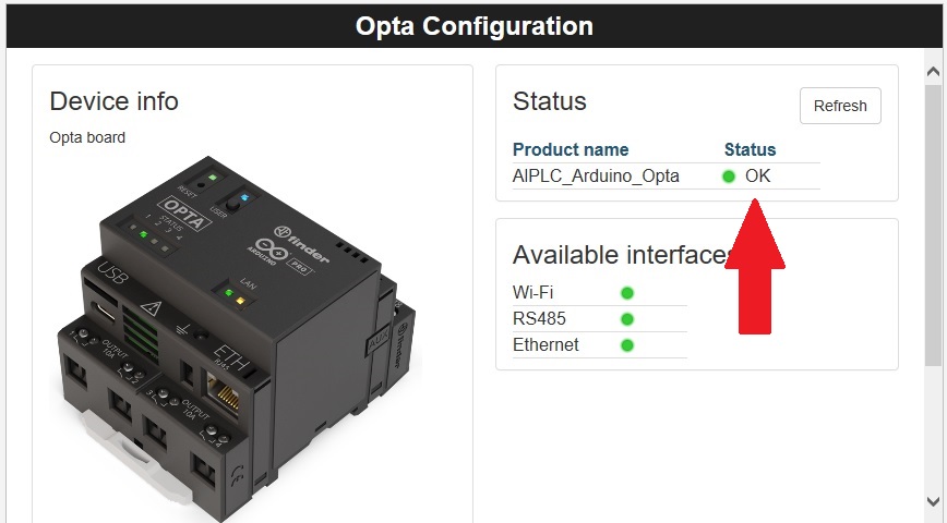

The only other setup step is to activate the license. You may need to visit the Arduino online store and purchase a license key, which is relatively inexpensive (less than 20 USD).
Author’s note: I previously used the Portenta Machine Control platform on this laptop. When I pressed the button to activate the license for this Opta project, it did so immediately, and it accepted the license after a complete reboot (both the 24 V and USB were removed). I had purchased a license number but wasn’t prompted to enter it. If this is your first time using any Arduino PLC, you may be required to enter the license number. Will update as this information is clarified.
After activating the license, be sure the status says ‘OK’ to continue programming.
Figure 4. After activating the license, be sure the status says ‘OK’ to continue programming.

The Opta provides us with a nice advantage for this ‘beginner intro’ type of program. There is a built-in button on the top of the device with the label of ‘User’. This button doesn’t perform a default function—it’s just a handy button that we can use for simple projects without the need for extra hardware.
For the output, we’ll just use a built-in relay output.

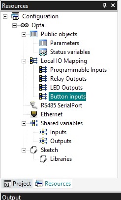

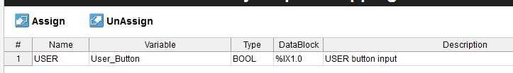

Navigate to the ‘Resources’ tab -> 'Button Inputs' (shown below) -> then assign the one called ‘User’ with the variable name 'User_Button' (shown in the second image below).
I/O Mapping
Figure 5. I/O Mapping.
Defining the USER button with a variable of the same name.
Figure 6. Defining the USER button with a variable of the same name.

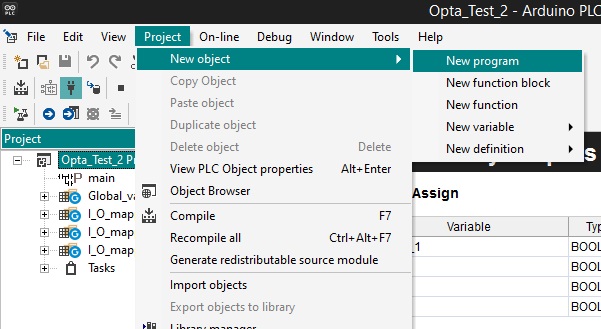

Create a New Ladder Diagram Program
The default ‘main’ program created is structured text (ST). This is a great platform to work with, but for automation engineers, ladder diagrams are often the go-to, so this article uses ladder logic.
To create this new Ladder Diagram interface, navigate to the ‘project’ tab (lower left corner). You should see a ‘main’ up near the top, and it will have a default counter program, all in structured text.
To create the new LD program, first click on the top-level tree project name, as you can see in the image below–mine is ‘Opta_Test_2’. If you don’t select the top-level project tree, the options for ‘New program’ will be grayed out.
Creating the new ladder diagram (LD) program.
Figure 7. Creating the new ladder diagram (LD) program.

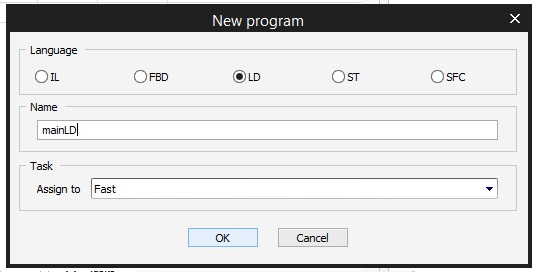

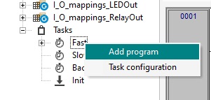

Select a New program, and you can choose the type, name, and how it will run. ‘Fast’ means that it will be continuously running in a cyclic fashion.
Be sure to assign the task, or else the program will not actually execute once downloaded.
Figure 8. Be sure to assign the task, or else the program will not actually execute once downloaded.
Troubleshooting tip: If you forget to assign the task at this point, the program will not run when downloaded. But don’t worry! You simply need to tell it when you want it to scan and activate the outputs. All PLCs are like this. If the program is not running, no outputs will energize. In the Project menu, just open the 'Tasks' list, right-click on the 'Fast' task, and add the program from here.
Figure 9. Adding a program to the 'Fast' task.

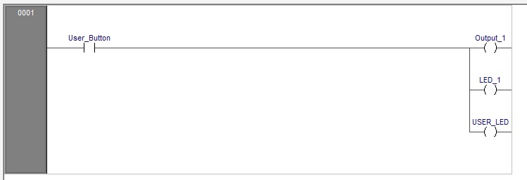

Program the Ladder Logic

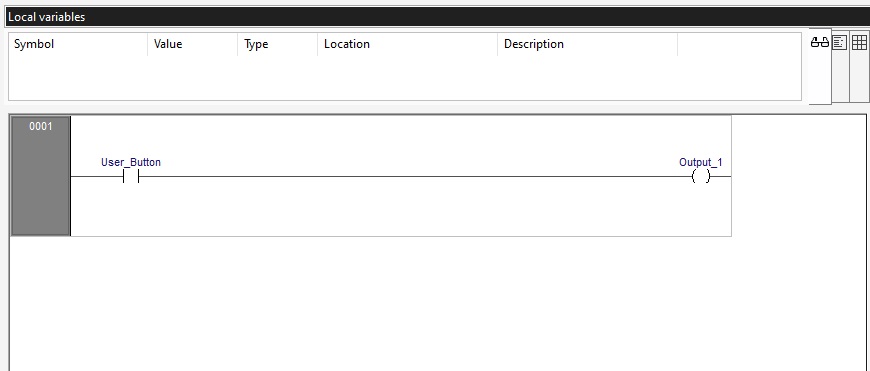

Finally, we can create the ladder program! Double-click on your new program, and there will be a blank input contact and a blank output coil. I had to scroll to the right to see the output coil, but it should be obvious if you have a large screen.
A double-click or right-click -> properties allows you to enter the variable names, just as shown below.
ur first Arduino Opta ladder logic program!
Figure 10. Our first Arduino Opta ladder logic program!
On-line -> Download code, and you should now have a running PLC program!

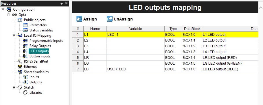

Why Don’t the LEDs Work on My Arduino Opta?
As mentioned before, the I/O LEDs are not hard-wired to the I/O pins like on a normal PLC.
The Resources tab also has a menu for LED Outputs. Head back over there, and let’s add a variable name to L1 and L8. L1 is the output LED, and L8 is the blue LED beside the ‘User’ button. You can see the variable names I chose below.
To energize the LEDs, first assign them the correct variable names.
Figure 11. To energize the LEDs, first assign them the correct variable names.
Back in the ladder program, we must command these LEDs to energize any time the input is active and, therefore, when the relay output is also energized. Right-click on the output coil and select ‘coil’, which will add a new output in parallel with the first.
Adding LEDs to main ladder diagram structure.
Figure 12. Adding the LEDs to the main ladder diagram structure.
Re-download, and now the relay output and the LEDs should be working as expected.

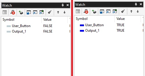

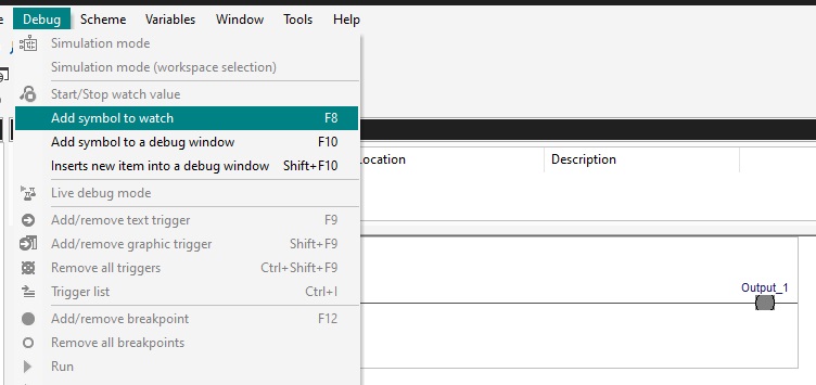

You can add variables to a ‘watch table’ to view their status in real-time. This is handy if you think your program should be working but the PLC isn’t responding. Is the program in the code or the hardware?
Click on any command or variable in your ladder diagram, like ‘Output_1’. Navigate to the top ‘Debug’ menu and Add symbol to watch.
Adding variables (symbols) to a watch list can identify problems in the code and hardware.
Figure 13. Adding variables (symbols) to a watch list can identify problems in the code and hardware.
Now, there will be a new window to the right of your ladder diagram. This will give you the current value of a BOOL, integer, or float so you can more easily view the status (you Arduino folks: this is like the ‘Serial Monitor’ and you know how useful that can be).
The watch table when the button is unpressed (left) and then pressed (right).
Figure 14. The watch table when the button is unpressed (left) and then pressed (right).
