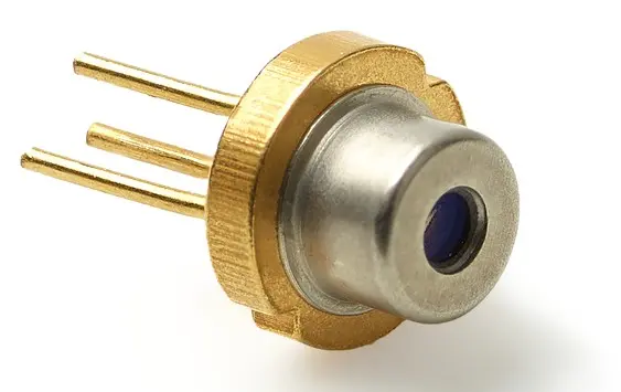

Semiconductor laser diodes or Laser LEDs are the most popular source material for devices used in industrial automation. Some types of laser diodes include the Fabry–Pérot laser, the single longitudinal mode (SLM) laser, the distributed feedback (DFB) laser, and the vertical-cavity surface-emitting laser (VCSEL).
Fabry-Perot laser diode
Figure 2. A Fabry–Pérot laser diode. Image used courtesy of RP Photonics
The Fabry–Pérot laser emits light at various wavelengths and can produce high-power output. It is also relatively cost-effective. SLM lasers are an improvement over Fabry–Pérot ones in terms of output power, but they work on a single-frequency component. They are used for radar detection and composition measurement, to name a few.
DFB lasers offer better stability than their counterparts and are widely used in high-speed fiber optic applications. VCSEL is the newest laser source technology from the group. VCSEL has quickly established itself as the best choice for short-distance applications due to its uniformity, resistance to high temperatures, and lower manufacturing costs.

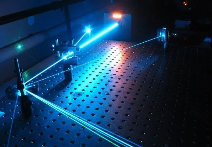

array of solid-state lasers
Figure 3. An array of solid-state lasers. Image used courtesy of Passat
Solid-state lasers use highly reflective glass mixed with rare elements such as chromium, erbium, neodymium, or ytterbium to achieve optical gain. They are the most popular medium in LiDAR lasers.

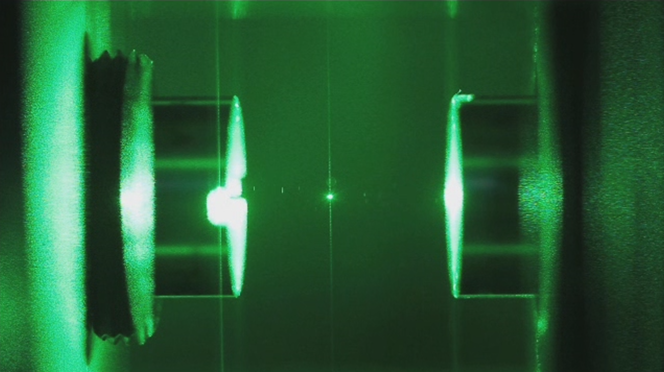

Optical Resonator
This is the last step before the laser beam is output from the device. The resonator consists of a pair of mirrors that surround the medium. The purpose of the resonator is to help build up the energy of the light beam by reflecting light back and forth through the medium several times.
optical resonator example
Figure 4. An example of an optical resonator. Image used courtesy of Wikimedia Commons

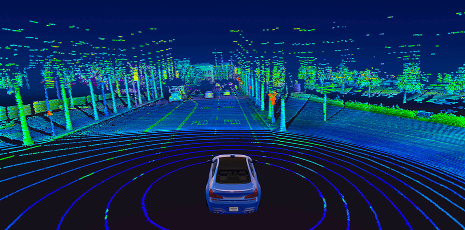

point cloud generated by a 3D LiDAR on an autonomous vehicle
Figure 5. A point cloud generated by a 3D LiDAR on an autonomous vehicle. Image used courtesy of Velodyne Lidar
LiDAR Sensors
Light Detection and Ranging (LiDAR) sensor technology deserves a special section. It calculates the time it takes for a laser beam to be reflected back to the source. LiDAR is experiencing tremendous growth in the automation business with applications ranging from autonomous cars to smartphones.
This operation occurs at very high speeds of up to 900 rpm for rotating lasers. The light beam can measure the distance to any surface, generating a "point cloud." A point cloud is a collection of many cloud points that provide precise shape and distance information.
Due to the high data requirements, LiDARs are usually coupled with their computer processors.
LiDARs used in industrial automation are mostly bidimensional, rotating the laser on a single plane. However, more complex technologies, such as autonomous cars, require more information about the surroundings and therefore integrate 3D LiDARs.
