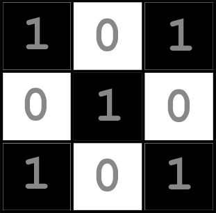

An image is merely represented as a list of numbers stored in computer memory. Each pixel in the image is assigned a value based on its color. If the image is strictly black and white, then a 0 can represent the color white, and the number 1 can represent black.
Figure 2. An image representing the numbers associated with image colors.

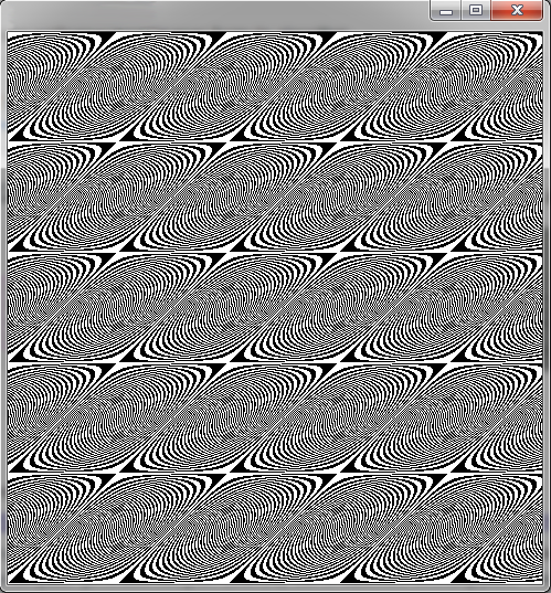

It is often the case that a very simple algorithm can produce surprisingly complex or unexpected results. Suppose we have the following equation, which determines whether or not any pixel in a  500 x 500 rectangular image should be painted as black or white.
(X * X + X*Y) / 30
X represents the value of the X coordinate of the pixel, and Y represents the Y coordinate. We divide by 30 (an experimentally determined number used to scale the result). If the number resulting from the above equation is even, we draw a black pixel at that location; otherwise, we draw a white pixel. We do this for all pixel locations as per their (X, Y) coordinates. That’s all there is to it! In figure 3, we see a rather unexpected image, certainly one that would be nearly impossible to predict from merely examining the above equation.
Figure 3. An algorithmically generated graphic image.

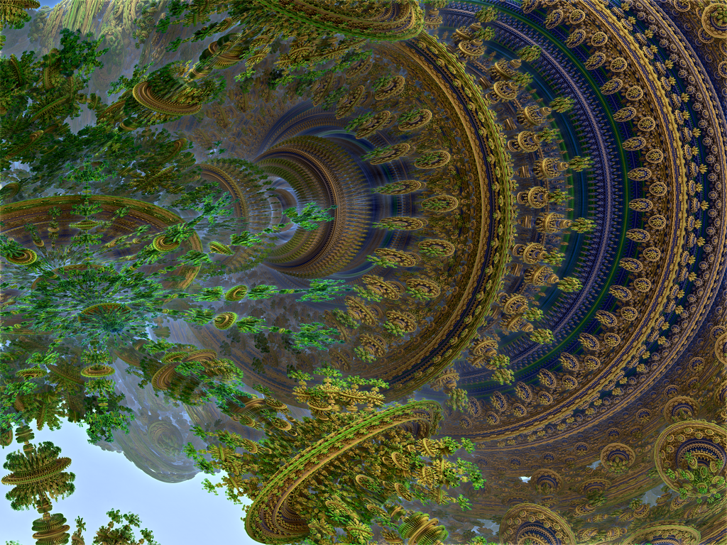

Computer-generated color “fractal” images use more complex formulas to produce strikingly beautiful images (figure 4).
Figure 4. A colored fractal image.

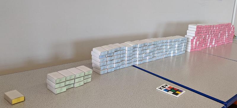

Interestingly, the first version of MENACE was not a computer program, but instead a collection of matchboxes. Michie was able to distill each possible board state (taking into consideration rotations and reflections of the board) into 304 patterns, each represented by a distinct matchbox. Each matchbox is labeled with a unique pattern of the tic-tac-toe board configuration (figure 5). In addition, each box begins with an equal number of beads of different colors. Each color represents a possible move that can be made from that particular game state.
Figure 5. A recreation of MENACE built by Matthew Scroggs. Image used courtesy of Matthew Scroggs
The machine “plays” a move by first having the user select the matchbox that corresponds to the current game board, shakes it, and then randomly removes a bead from the box. The color of the bead determines the move. The machine must begin the game, so the matchbox that represents the empty board is initially selected. For example, if the bead removed is white and the color white represents the center square, the machine plays the center square.
