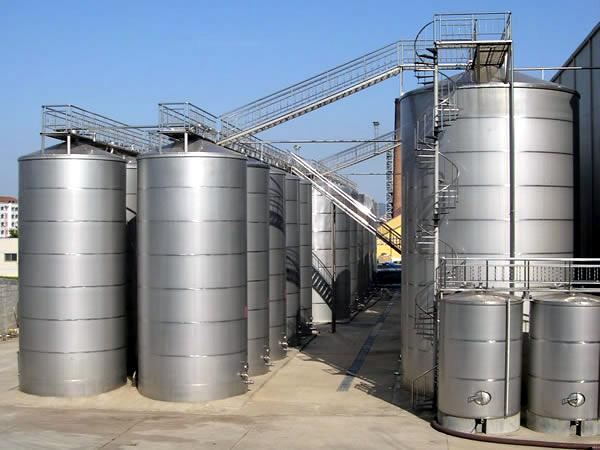

Level sensors are devices that can measure the level of a substance in a container, typically liquids or granular materials. The output of these sensors is normally a distance quantity that estimates the level in relationship to the container dimensions. The resulting distance can then be converted to volumetric values based on the same tank dimensions
There are different types of level sensors available, each with its own unique features and working principles.
Vertical storage vessels used in the oil industry
Figure 1. Vertical storage vessels used in the oil industry. Image used courtesy of Hi-Sea Marine

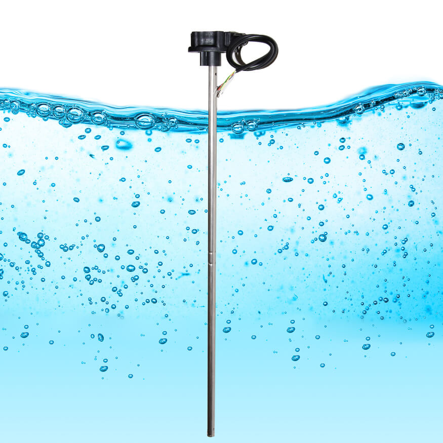

Capacitive level sensors work on the principle of electrical capacitance, which is the ability of a material to store an electric charge. These sensors measure the change in capacitance caused by the presence or absence of a substance in a container.
When a conductive probe is inserted into a container, it forms a capacitor with the container wall. When the container is empty, the capacitance is low. When the container is filled with the substance, the capacitance increases. This change in capacitance is used to determine the level of the substance in the container.
Representation of a capacitive level sensor submerged in a liquid
Figure 2. Representation of a capacitive level sensor submerged in a liquid. Image used courtesy of Rochester Sensors
Capacitive level sensors are suitable for use with liquids, powders, and granular materials. They are particularly useful in applications where the substance being measured is conductive or has a high dielectric constant. Capacitive level sensors are also unaffected by changes in temperature and pressure. However, they can be affected by buildup or scaling on the probe, which can cause errors in the readings, although relatively minimal.

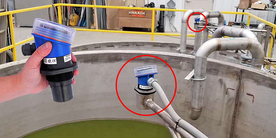

Sound waves are the working principle behind ultrasonic level sensors. In particular, they use high-frequency sound waves to determine the distance between the sensor and the substance being measured.
A transducer sends out a sound wave, which bounces off the surface of the substance and returns to the sensor. The time it takes for the sound wave to travel to the substance and back is used to calculate the distance between the sensor and the substance.
Ultrasonic level sensors mounted atop a water tank.
Figure 3. Ultrasonic level sensors mounted atop a water tank. Image used courtesy of Flowline
Ultrasonic level sensors are well suited in applications where the substance being measured is not conductive or has a low dielectric constant, complementing capacitive level sensors.
However, like the capacitive sensors, ultrasonic level sensors keep a good performance level even under changes in temperature and pressure. On the downside, they can be negatively affected by the presence of foam or vapors, which can interfere with the sound wave and cause errors in the readings.

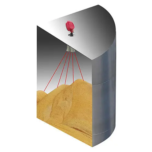

Acoustic level sensors employ low-frequency sound waves for the same purpose of detecting substance level within a container. To operate, the sensor sends out a low-frequency sound wave that travels through the liquid and bounces back from the bottom of the container. The total time it takes for the signal to return to the sensor is then used to calculate the level.
A diagram of an acoustic level sensor.
Figure 4. A diagram of an acoustic level sensor. Image used courtesy of Direct Industry
These sensors are important tools to measure depth and level in containers where viscous materials and suspended solids are stored. One factor that can produce measurement errors are air bubbles in the container that could interfere with the sound wave.
