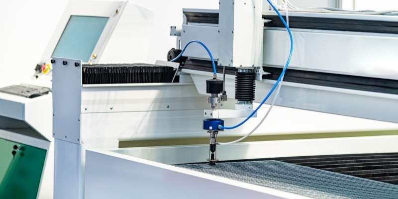

Linear motion axis
Figure 1. Linear position is very important in CNC tools, hydraulic and pneumatic cylinders, and in some positioning tasks for robot end of arm tooling.

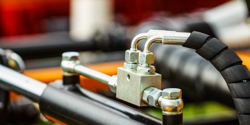

One of the most basic roles of a linear position sensor is to ensure that actuators do not exceed their stroke range and cause damage from constant repetitive shock. The range of the actuator, be it electric, hydraulic, or pneumatic, is known, and the sensor checks both the position and the speed to ensure that it will not extend or retract too far.

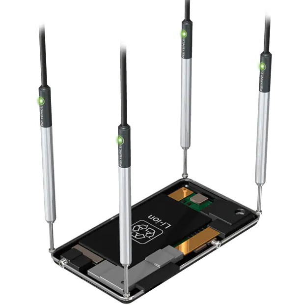

Linear position sensors are also important for quality control operations, not just for moving loads. Consider a printed circuit board with wave-soldered components. A quick tap from an automated linear position sensor can determine whether a particular component has been seated to the proper depth.
Hydraulic cylinder
Figure 2. Hydraulic cylinders may be outfitted with two external end-stop sensors, or a more continuous feedback position sensor for more control.

PCB inspection
Figure 3. Product vertical position may be checked with linear position sensors (like this PCB inspection system). Image used courtesy of Keyence
